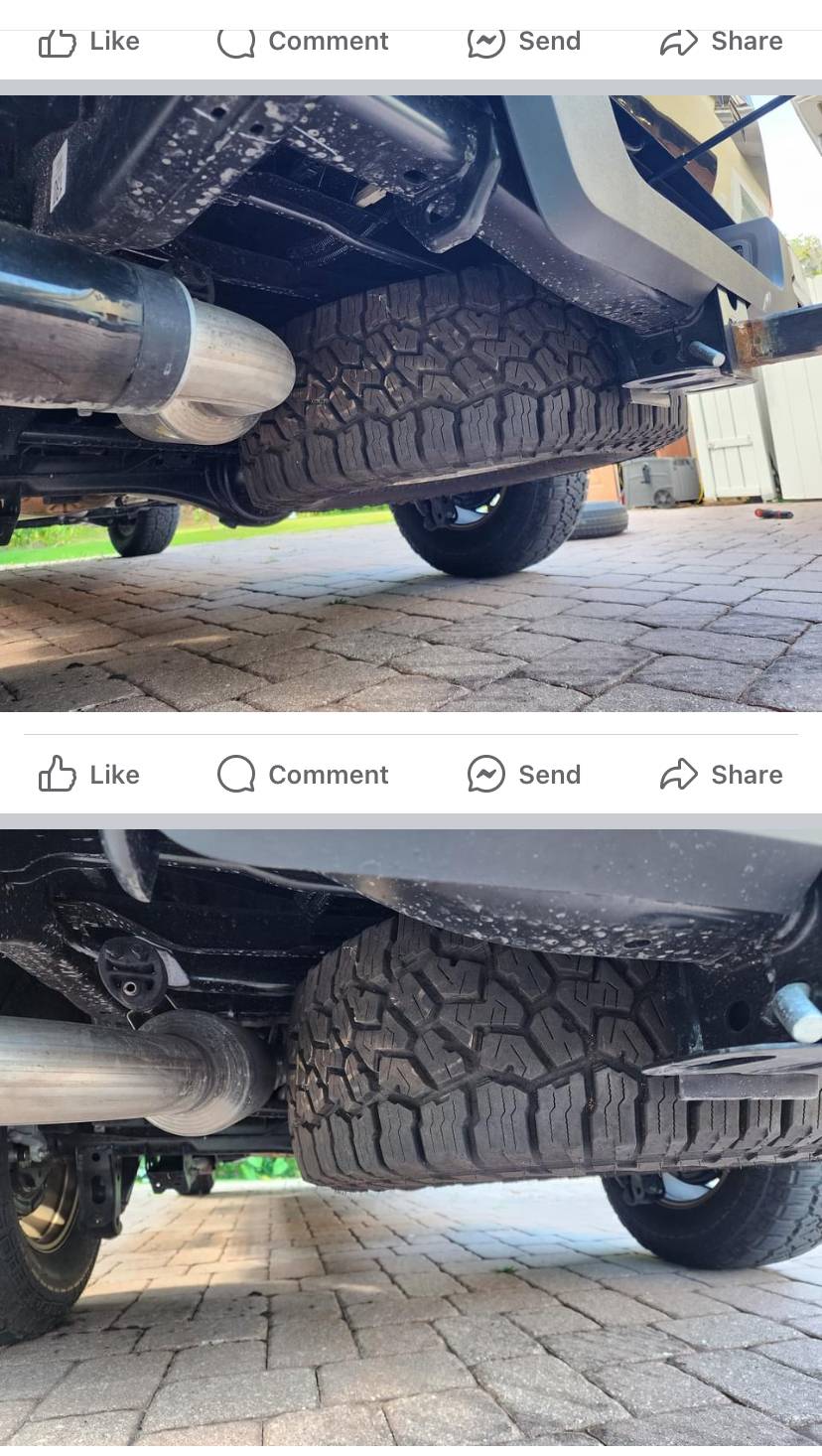

The diameter is one thing, it’s the width that becomes an issue if you’re planning to wheel at all it looks like. Pics from another site with a 285/70/17 hanging way too low for my liking anyway. The poster also removed it and will haul somewhere else.

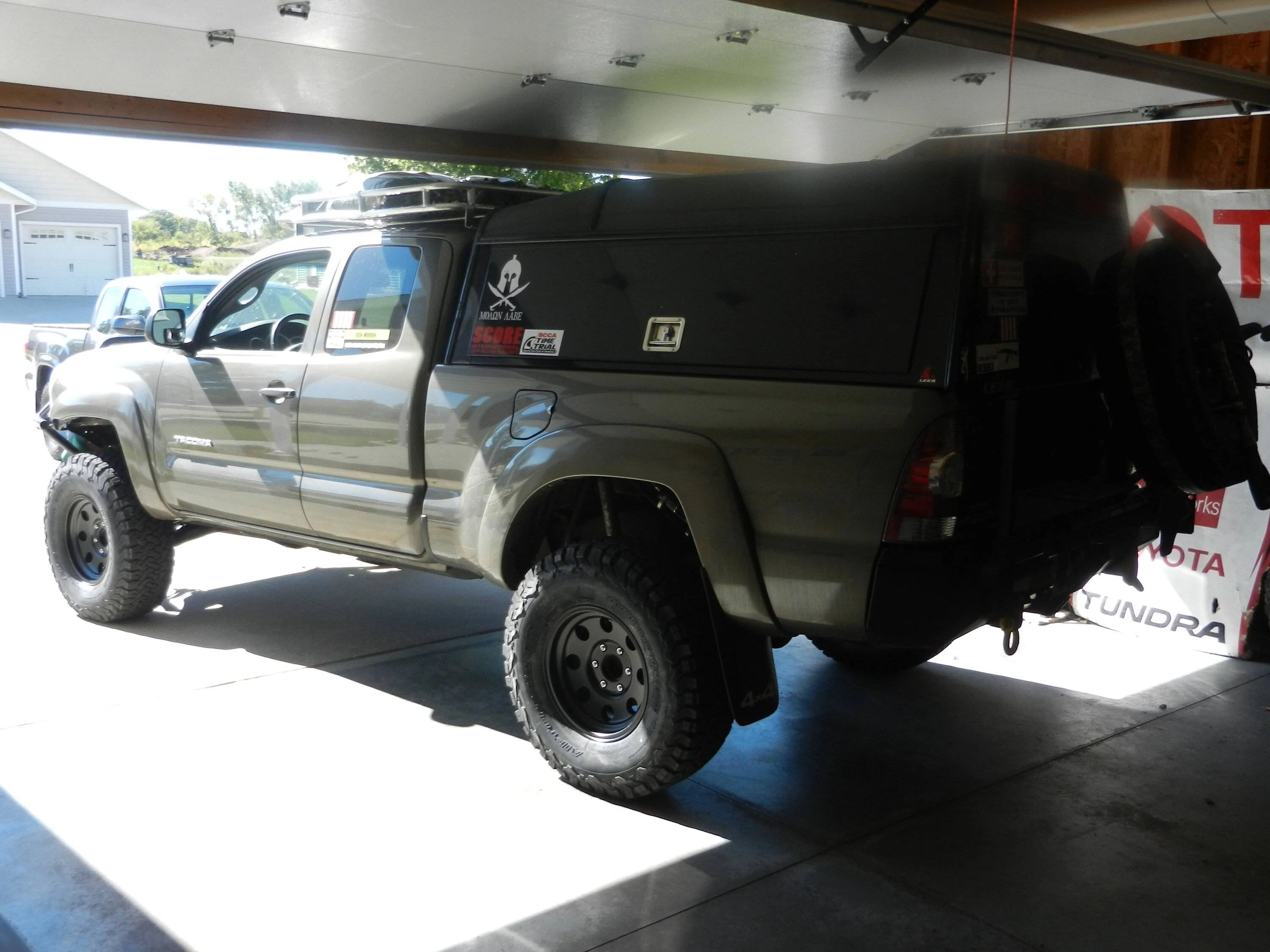

I am running 265/70 R18, so for this year it will remain in the bed secured. If I need the full bed, it will have to come into the cab, rear passenger area. My 2016 SR access cab, I kept the full spare 265/75 R16 behind the passenger seat and it nestled in the foot well very nice.
Plans for my new TRD Sport will be either roof basket, so when I need the bed, I use one of my many ramps to slide it up on the roof basket and when done, bring it back down into the bed.
Other solution will be a new rear bumper with swing gate to mount the full 265/70 R18 like a 4runner or Jeep in back and match with a low profile front steel bumper.
It will all depend on how I like the look of the front and rear OEM plastic covered bumpers before I decide. Never have I had the spare mounted underneath less for weight. Corrosion is a big deal and I am not getting down there to drop the spare in a cold rainy or snowy day.
Some examples of past trucks.
My old 2010 SR5 bronze oxide... 265/75 R16 first image.
My old 2010 SR5 bronze oxide... 285/75 R16 second image.
My old 1985 2wd 4-speed manual... 32x10.5 R15 last image.

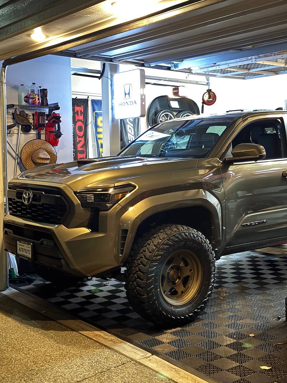

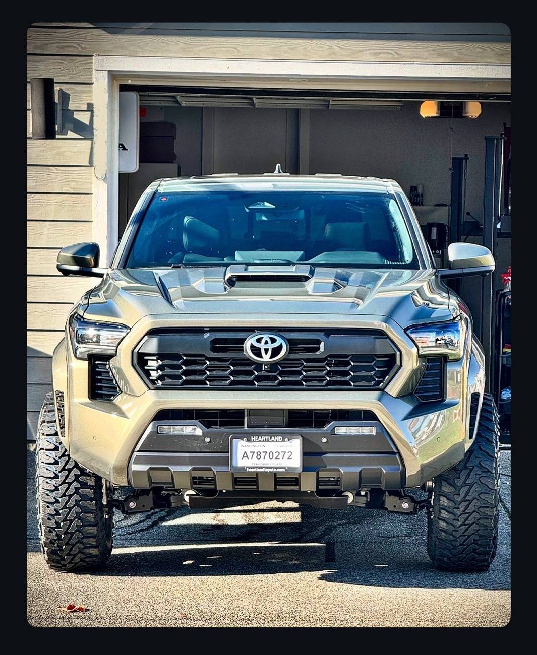

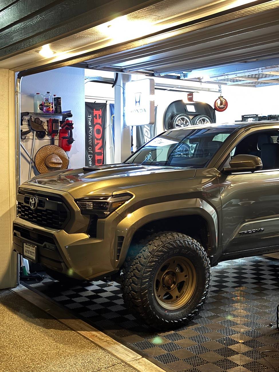

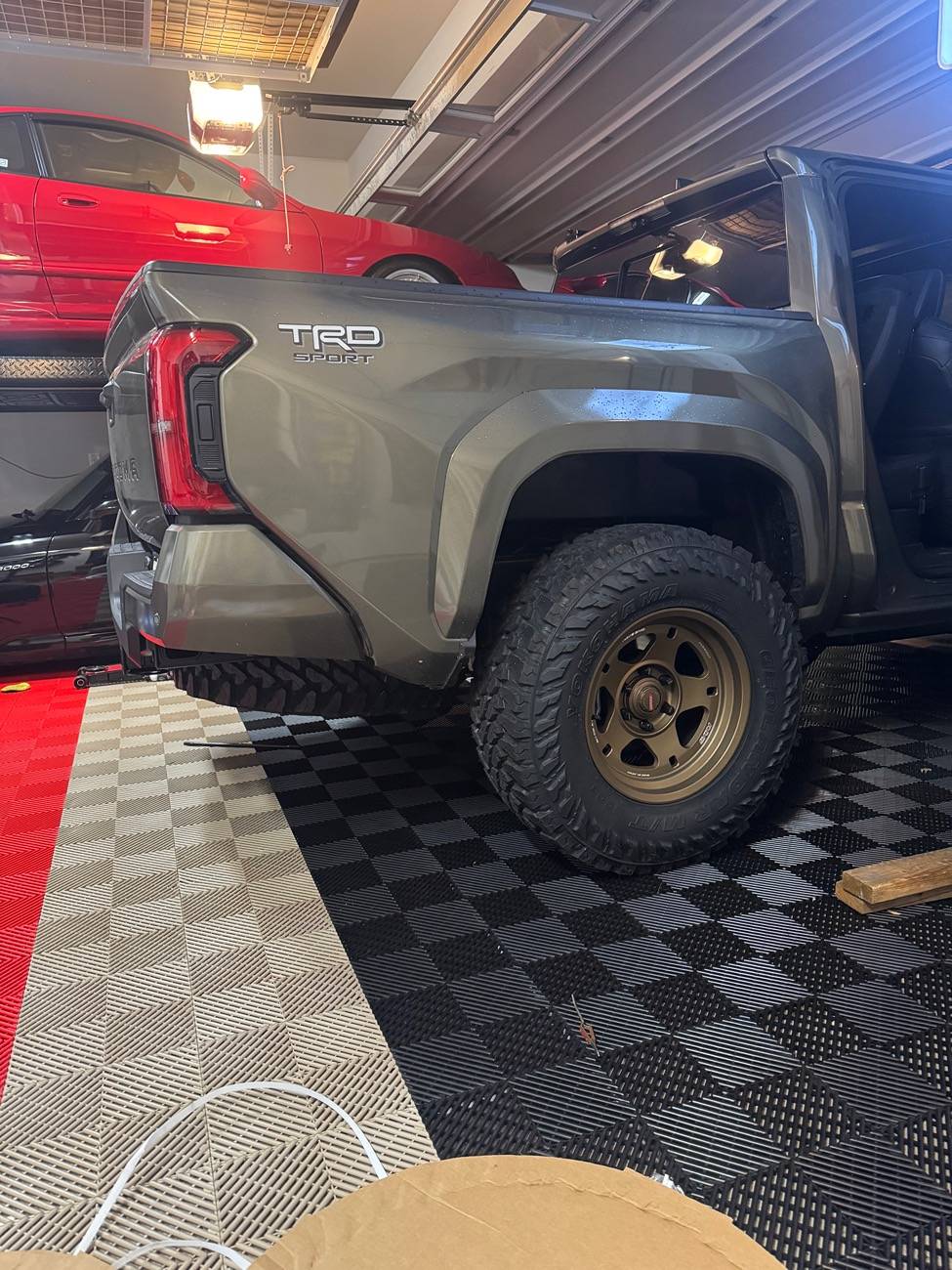

Here’s what I got which I think is the absolute best size fitment imho.
Wheels: 17x8.5 —10 Volk Racing 05X
Tires: 295/70 Yokohama Geolandar MT

The spare will have to be slightly deflated to squeeze behind the hitch. When I say slightly it means it fits without the tire being deformed. Just deflated enough so that the tire isn’t ballooning from pressure.
Here’s pics of what a 295/70 is on a Taco:
2024 Tacoma Not much room for a larger spare tire under our trucks IMG_1436
2024 Tacoma Not much room for a larger spare tire under our trucks IMG_1427
