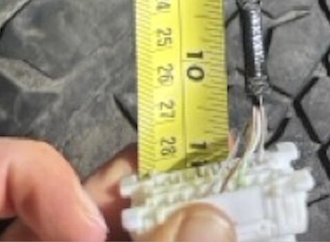

The Dummy OBD team said it would work but to your point and if it doesn't: I would need to build an OBD switch -- which is technically a 5 or 6 wire switch [capture below, can't tell but <8!]. As a telecom engineer: using a passive Cat-5 switch would work;) Cat-5 though Cat-7 all being 8-wire twisted pair;)
2024 Tacoma OBD Relocation, Siren and multiple "Dummy" interfaces 1741013544750-l0
