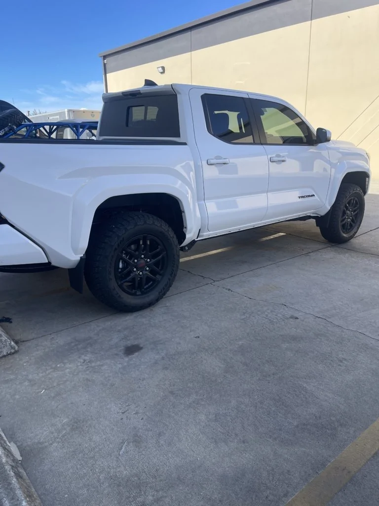

Looks good.

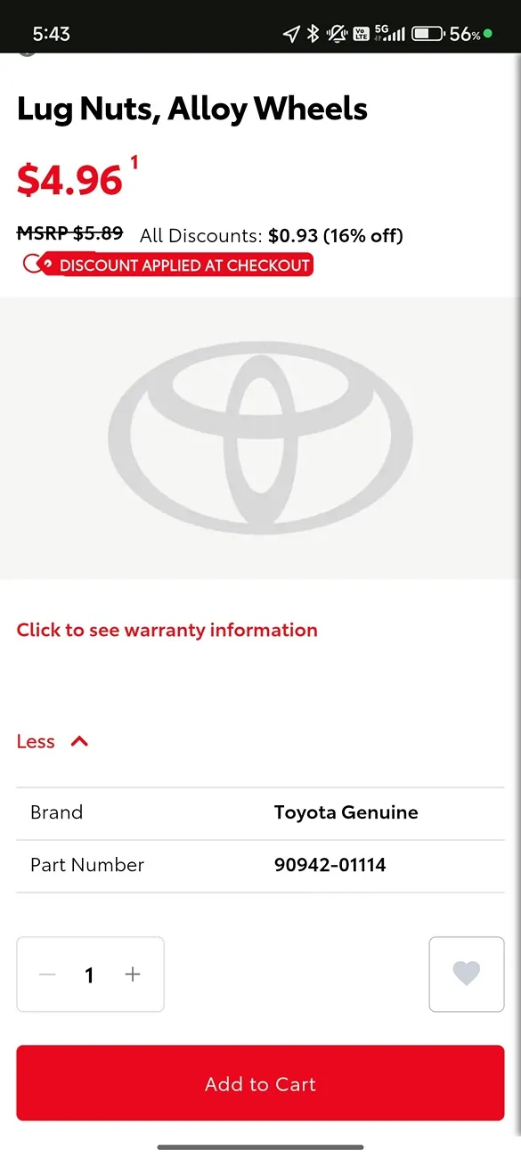

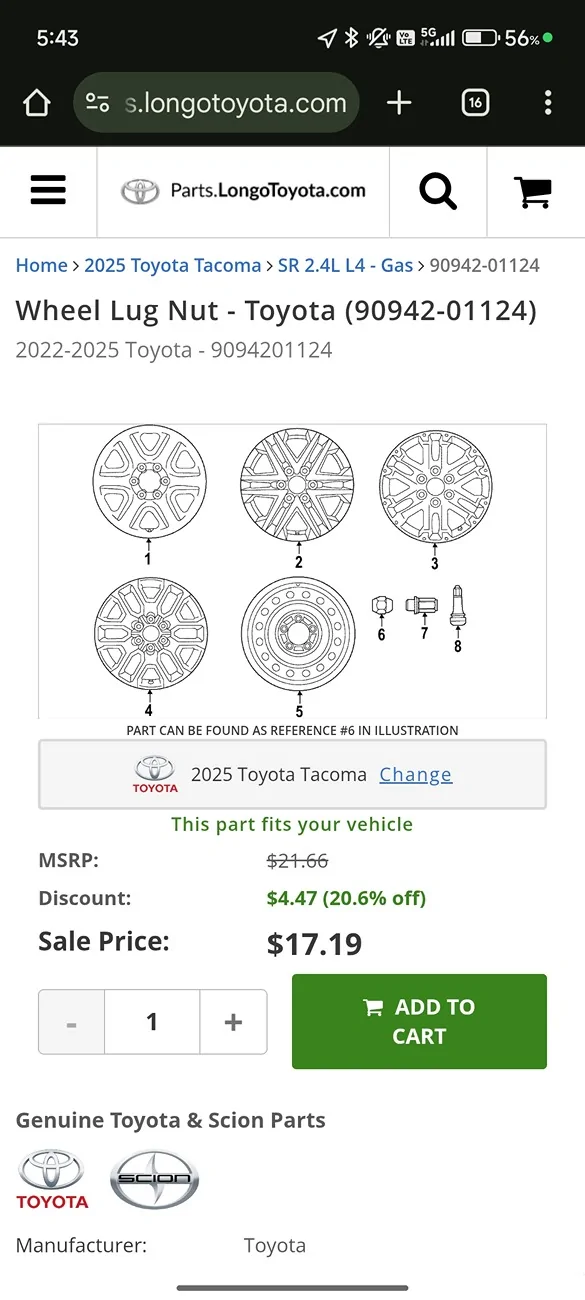

Do you have a part number for the lug nuts? They're different than the flat seat style for the aluminum wheels. For the steel wheels they're acorn style.
Thank you!!
2024 Tacoma OEM Steelies - Not exactly black Screenshot_2025-08-30-17-43-42-382_com.android.chrom
2024 Tacoma OEM Steelies - Not exactly black Screenshot_2025-08-30-17-43-51-885_com.android.chrom
Getting conflicting data here from Toyota parts websites lol but I'm pretty sure this is the acorn lug nut the steel wheels will need
Thank you!!
I'm running the Toyota steelies, I use these if you're interested. They have a 60 degree Conical Seat.
24 Gorilla Black Lug Nuts 14mm x 1.50 Bulge Acorn Seat 3/4" Hex 14x1.5

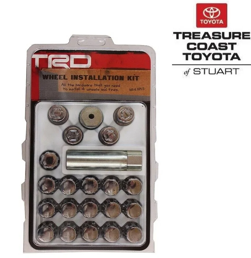

I ended up with the TRD M14x1.5 lug nut set:
2024 Tacoma OEM Steelies - Not exactly black 1765236671731-
But yeah any acorn style lug nuts will work
Mcgard makes the TRD set above and they're actually really nice quality
They sell these:
https://shop.mcgard.com/products/au...-m14-x-1-5-thread-size-set-of-4-lug-nuts-1204
Which would be fine for the steelies, might cost more than what Toyota is offering but they will for sure look better longer.
Ironically Mcgard on their own product page says to not use the TRD style lug nuts on steel wheels... TRD packaging doesn't say anything about that. My independent mechanic said it was fine and Toyota dealer didn't complain. They torqued them to 154ft lb despite me saying 120 is probably fine lol
