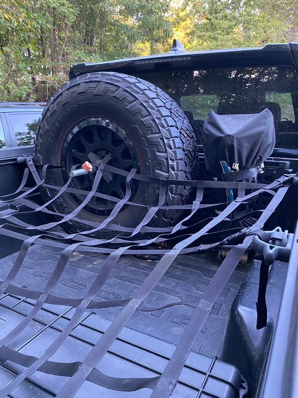

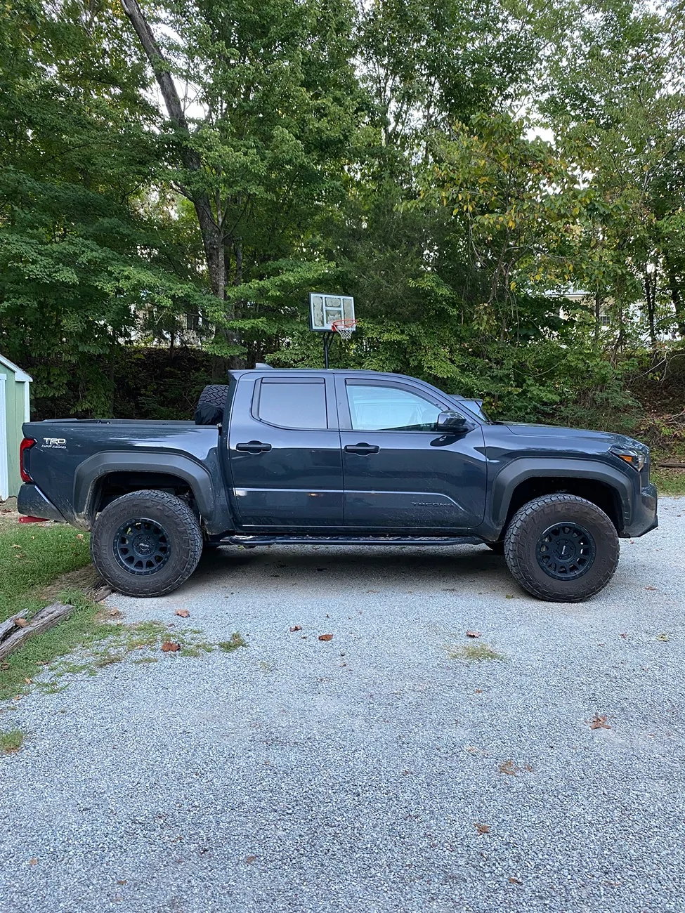

I just installed the Bilsteins 6112/6100 on my 24 Tacoma. It definitely rides better but I’m swapping rear springs. The ones I have Dobinson’s C59-869V don’t seem sufficient for the weight I’m carrying. Full size 35/12.5/17 Nitto recon on Method 305s. Plus a pro eagle talon jack mounted beside it in the bed. An Apache case with a compressor for airing up, some recovery tools etc. Going to change to Icon 51215 rear springs. After full length discussions with various AI systems I learned (if accurate) that the Bilsteins and OME MT64 are Essentially built very similarly, only the Bilsteins are 2.5” and OME are 2.8”, if I remember correctly. Apparently there’s not enough difference to produce a day and night difference in the ride quality between the two (with the other weight my truck has) to justify the cost difference. Also looked at Dirt King MT Trailrunner which would probably provide a better ride if my truck was stock. Unless I wanted to upgrade to fox 2.5 or king both of which would probably need rebuilding every 40,000 miles or so for a whole lot more money than the Bilsteins which are a set and forget set. I don’t know if that helps but thought I’d throw my two cents worth in. lol
Throwing in pictures just for fun.

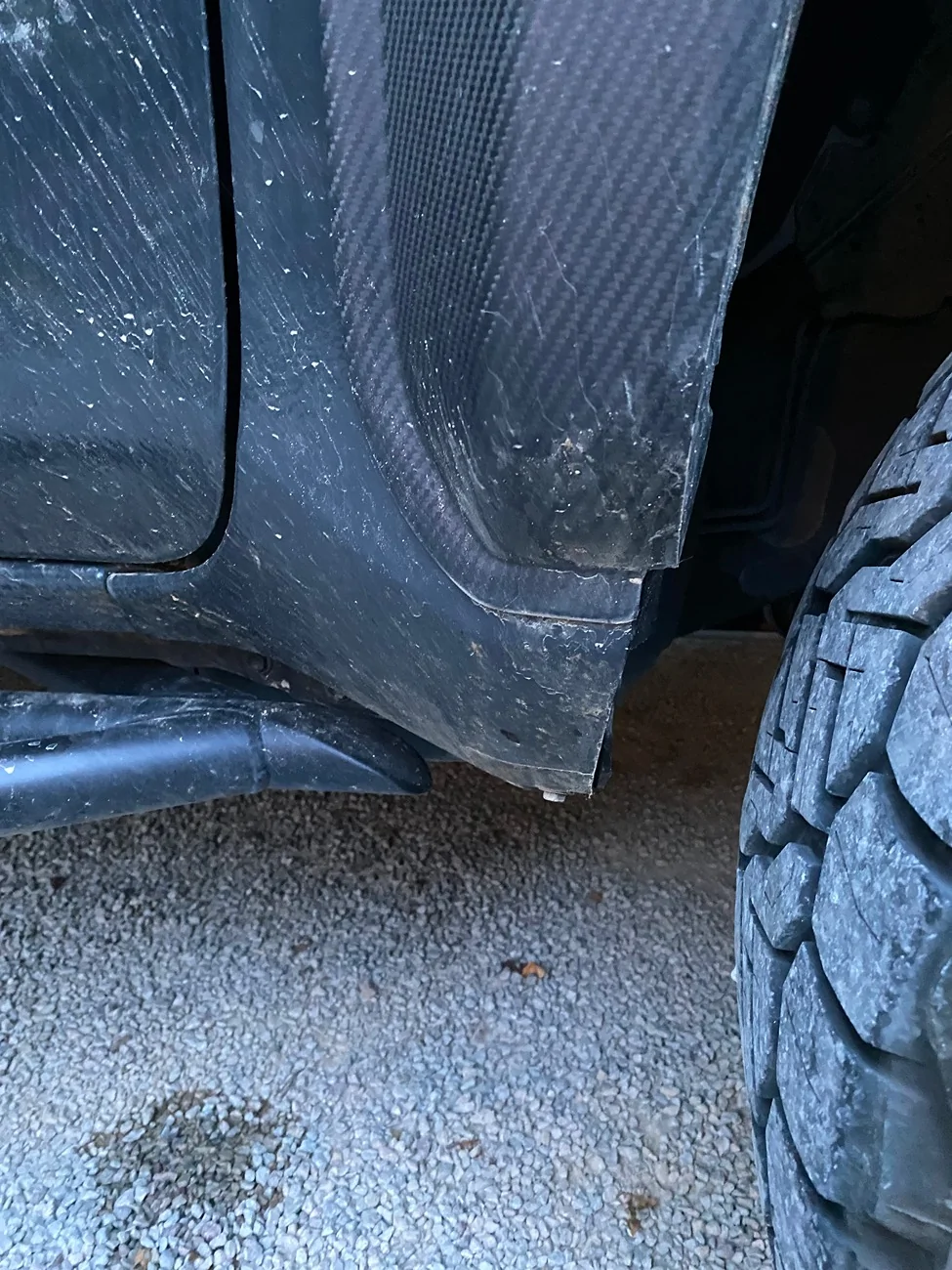

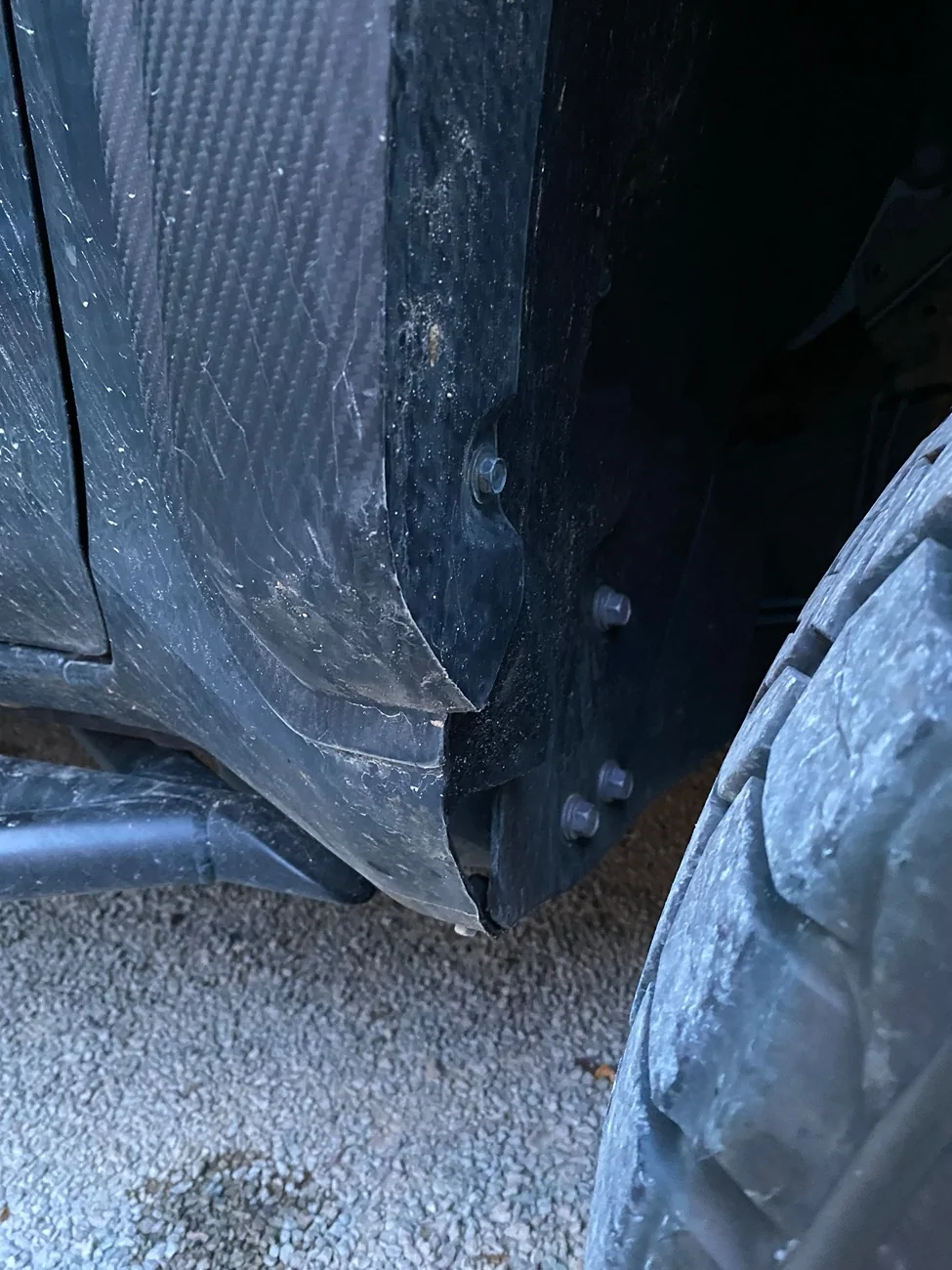

I ended up trimming the very back side of the fender flare bottom. Minimal. Images included. No more rubbing. I could have probably just asked them to move the wheels forward more but I was somewhat frustrated at that point and I live about an hour away from where the alignment was done and really didn’t want to go back. I also installed the east coast gear supply bushing replacement for the drivers side and my axle hyper extended. I had a friend who is a mechanic and he and I tried everything but to no avail. Ended up ordering a new axle which was leaking. Not sure if it was on them or me but they gave me a refund. The axle was under some kind of recall (just not my vehicles axle) so that delayed the replacement. When I finally got the axle reordered and everything put back together it had been close to three weeks that I had gone without a vehicle. Fortunately I was able to share my old 2006 RAV4, with 380,000 plus miles, with my daughter, who is driving it now, and all was well. I did the work myself to try to save money and probably did save money despite buying an axle, considering the quotes I was getting for installation of everything. Anyways I am disabled and not as fast or strong as I used to be but I got it done. First day I got sick, either from pain, heat or a combination and began vilantly vomiting. Should have saw the sign. It was all down hill from there. lol. I’m still trying to recover. Hahaha
