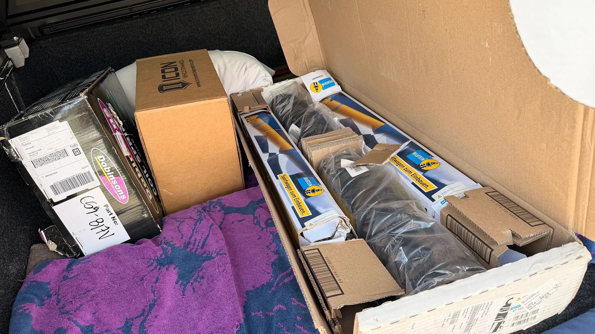

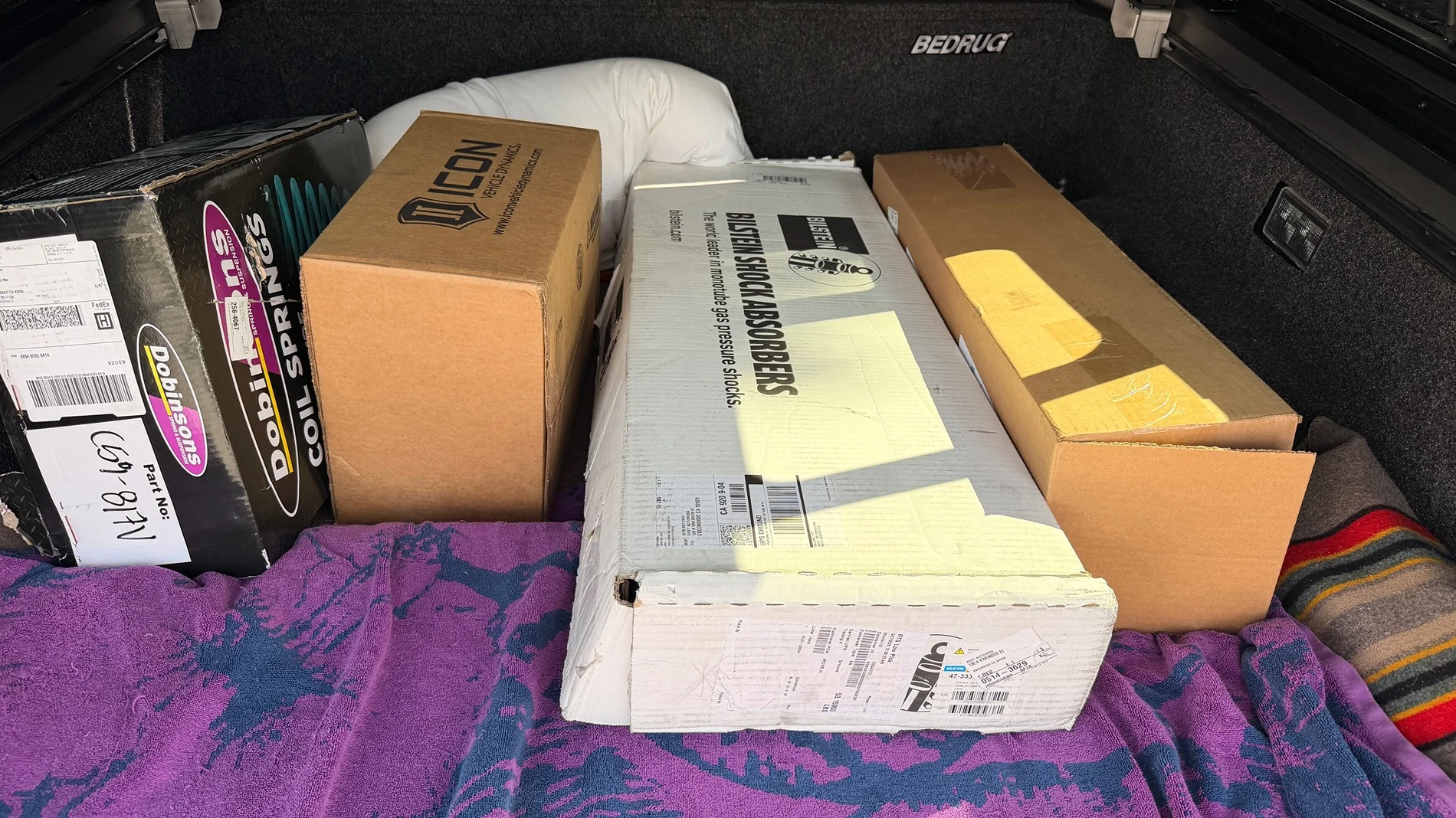

Can I ask where you got them and how much for everything?
Also let us know how they feel.
I bought them from a local jeep shop which was pretty stupid. The plan was to have them install them so I was ok overpaying a bit, but turns out they're just swamped and terrible at communicating / scheduling work ahead of time etc, so I'm having another place install them.
Paid retail for everything. I think $1580 front and rear shocks and $850-900 for the UCAs. Probably could have saved 400 ordering them through jackit or similar. Springs were on sale through mudify for like $260 shipped.
