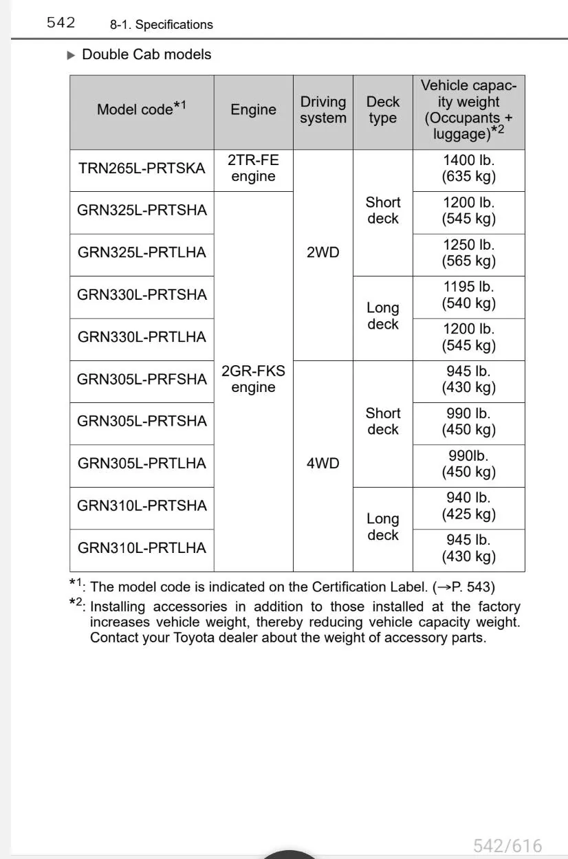

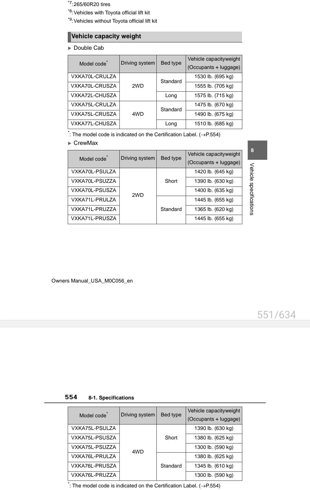

So when you look at the weight capacities in the 2023 Tacoma and 2024 Tundra manuals they list them being a couple hundred pounds less than what seems to be reported at dealers and media reviews. What's that all about? See below:

So after some sleuthing yesterday and opening a can of toyota payload worms I think the 24 Taco payload will be much better than 1200. 24 Tundra and 23 Taco listed sticker/manual payloads are hundreds of pounds lower than real GVWR-curbweight. This appears to go for the 24 Taco too.
GVWR for Offroad Taco according to manual: 6240
Curb weight as tested by Car and Driver (with full tank according to their protocol): 4794
Actual available payload for fully loaded offroad with full tank: 1446
Not too shabby, something without a premium package and sway bar disconnect may actually be approaching 1600 or 1700. I'll happily eat my own criticism in this case.

If it's anything like the Tundra, the GVWR for hybrid goes up accordingly and results in similar available payloads to non hybrid. I can't remember where I read it (or if it's reliable) but I remember hearing 1709 max payload for hybrid models (4x4, double cab only) and something like 1685 for non hybrid in the 24 taco. Maybe things aren't too bad fot the trailhunter if the door sticker says anything over 1000 lbs.
Here is a platinum hybrid tundra, gotta be one of the heaviest trucks they make:

So this is pretty interesting from what someone pulled up from the new manual than was released. If this is the case, you can tack on 750 lbs and subtract driver/passenger weight from there. Kind of confusing how its worded though.
It's very confusing and their wording is not consistent throughout the manual.
Page 613 shows "vehicle capacityweight (occupants + luggage)" as 1200lbs.
Page 664 shows "cargo weight rating" as 450lbs.
They further complicate it by listing it based on the obscure model codes that are difficult to decipher.
It appears that Toyota underrates their door stickers by a couple hundred pounds just to keep us guessing.
