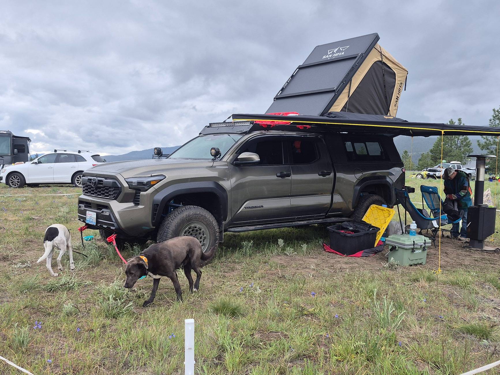

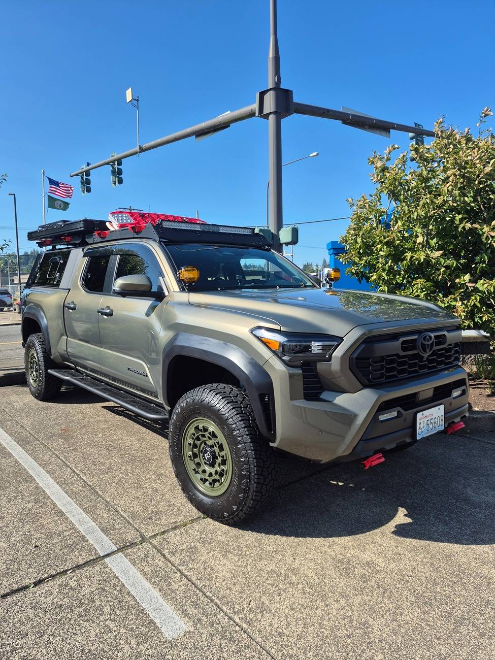

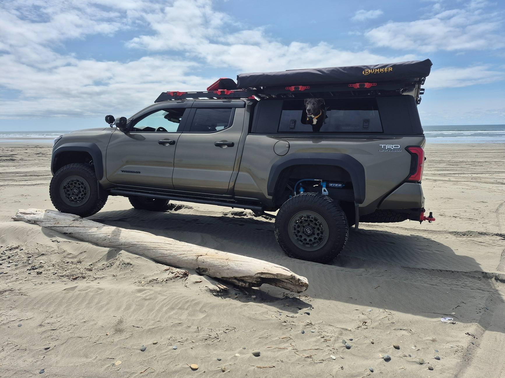

Totally worth the money to upgrade your suspension and upper control arms. I would not go with the pro or the trail hunter package from Toyota.
In fact, I wouldn't go with any package. Toyota is trying to sell you because none of them perform like what a package from king, and I just about bet it will be cheaper.
My local toyota dealership in Olympia, installed the lift so that I would not avoid my warranty..
I upgraded my TRD OR suspension with a package that running for tacos sold me.
I would talk to twan at running for tacos. He is amazing..
The package was the total chaos king coil over package. .I added rear Dobson, 819 coil Springs because of the weight I run and added new king drop links as well.
The way this truck handles is amazing. With the new suspension and my Pizza cutter tires. I can go just about anywhere..?
