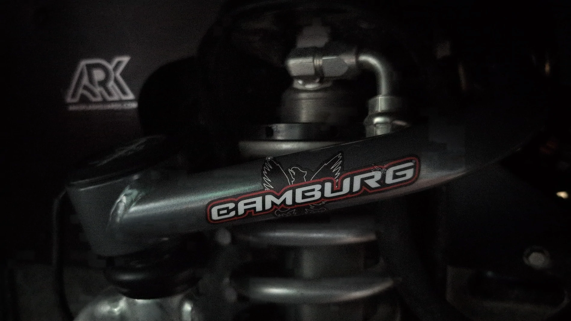

I installed new Camburg UCAs about three weeks after that post and its night and day. Toyota tech was able to get -.1 camber and caster is at 5.5. Adding that much caster makes a huge difference in how planted the truck feels compared to twitching out on those original alignment figures.

From stock with the BFG tires and +55 offset oem wheels to 2.25" front / .5 rear, new UCAs and +25 offset wheels there are a lot of variables in that mix.
The alignment was key. So driving - noticeable difference in the input required to turn at lower speeds. What I mean by that is a micro movement of the wheel doesn't translate to immediate steering changes. It takes a little commitment to get the turn engaged. To me that is ideal from a performance point. It requires the driver to drive with more attention but the benefit is the truck is absolutely stable and planted at speed and when making turns. You loose that Cadillac ease of having a big car turn effortlessly but gain a lot of confidence at speed in suboptimal conditions.
