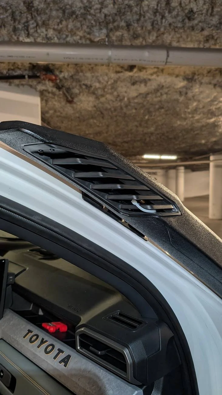

Has anyone tried replacing the scoop at the top of the intake with a cyclone filter cap or something like that? I don’t have the snorkel on my Tacoma, but I was thinking of having one installed at some point down the line.
I wonder if that would make any difference with the sound.

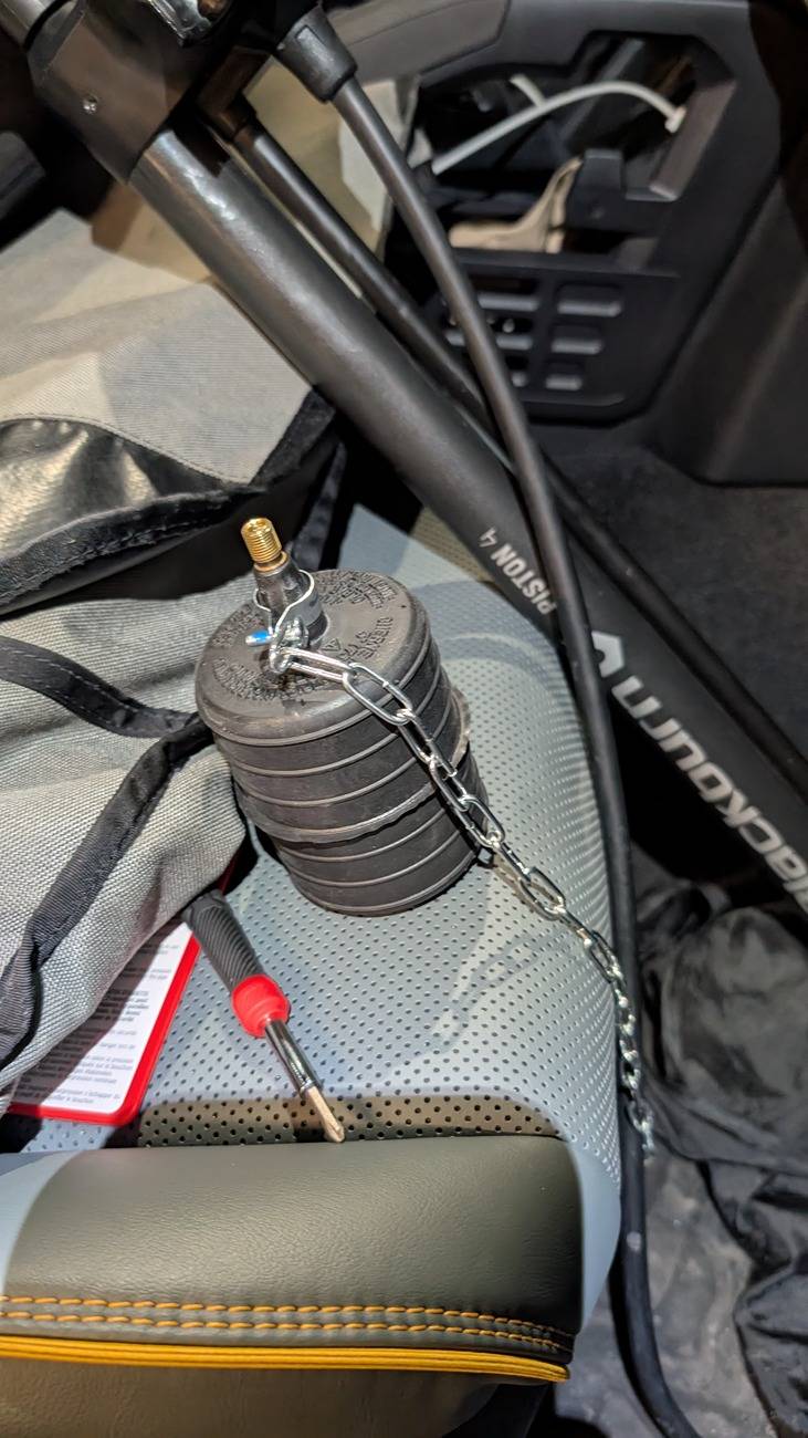

I'm trying to do something similar. I've got the lower rubber cap removed and tried to insert an inflatable toy ball into the top of the snorkel and aired it up. It's blocking most of the air, but now I'm worried it'll deflate over time and go into the air box. I really only want the snorkel noise gone for road trips with the surf-wife, but I'm not sure what I'm proposing is a real solution.

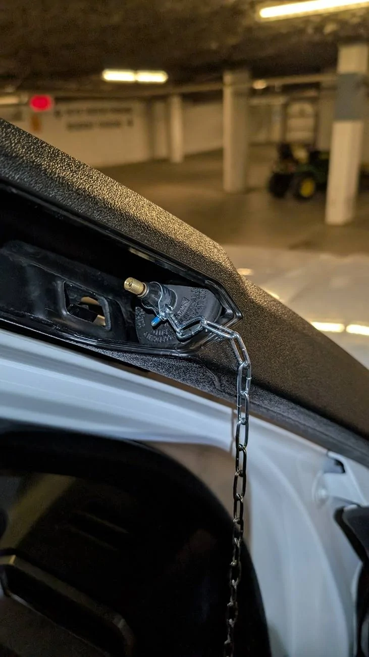

Gonna try a plumbing balloon test plug. It's got a loop that I can mechanically fasten to a zip tie to the louvers of the snorkel.

Quieter... Maybe 40-60% better. I'm surprised its still making any noise to be honest.
I think the only way to completely eliminate the noise is to close the outlet box from under the hood, but that solution is a bit too permanent for me.

I just used a 3" plumbing test ball and a zip tie. You can get the test ball from any plumbing specific store.

Update: I've messed up my MAF sensor with oil from the air filter after making this change. Dealership replaced the sensor. I'll be looking for a TRD pro intake to swap out now.
I can't recommend the modifications I've made to block the snorkel.
