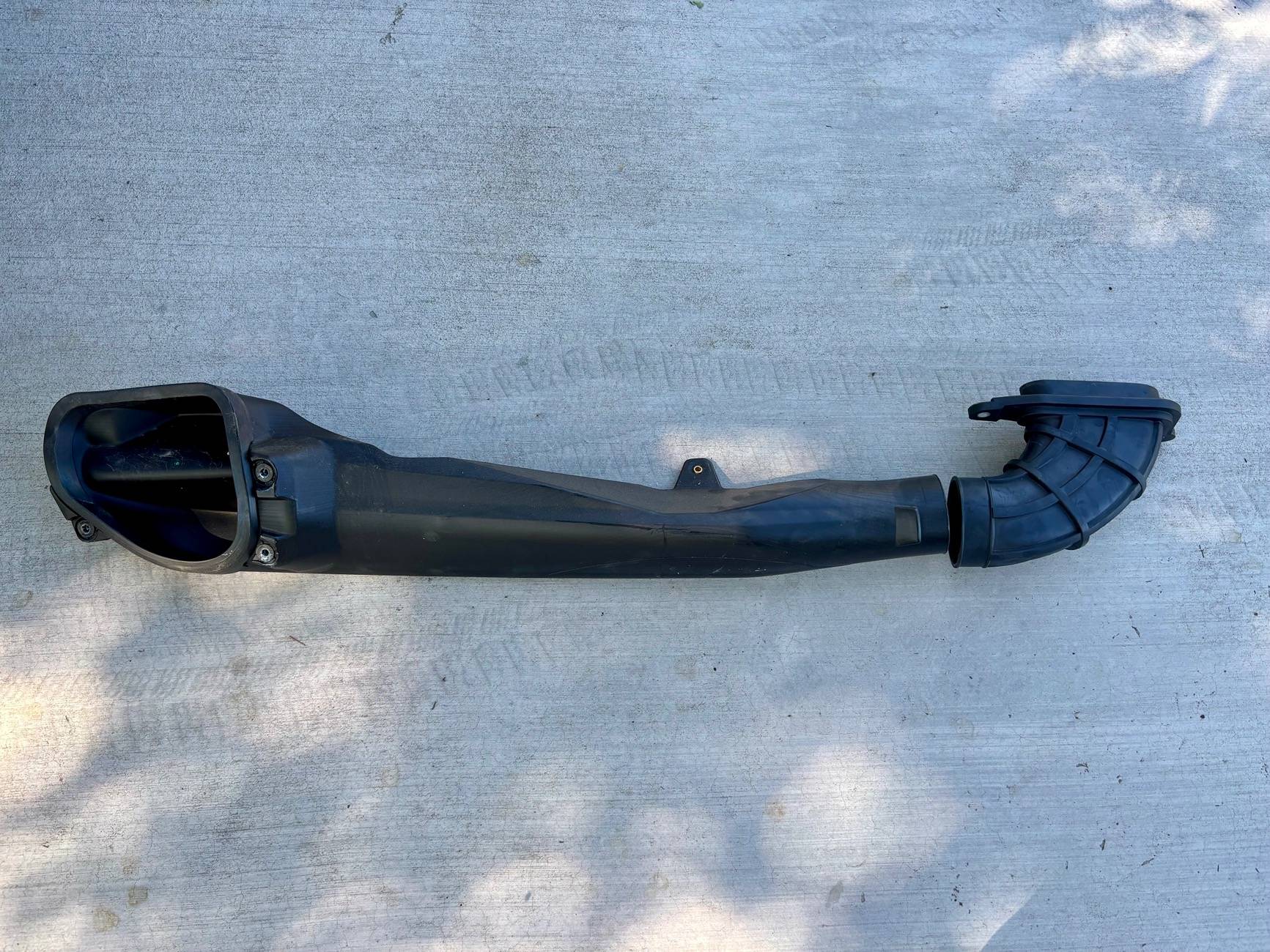

If you are like me and looking to get rid of the high desert air-intake (snorkel) because of how annoyingly loud it is with windows down, I figured it out. I spend too much time in the mountains or out on desert roads with the windows down and the intake noise made my wife and I roll the windows up. Not anymore!

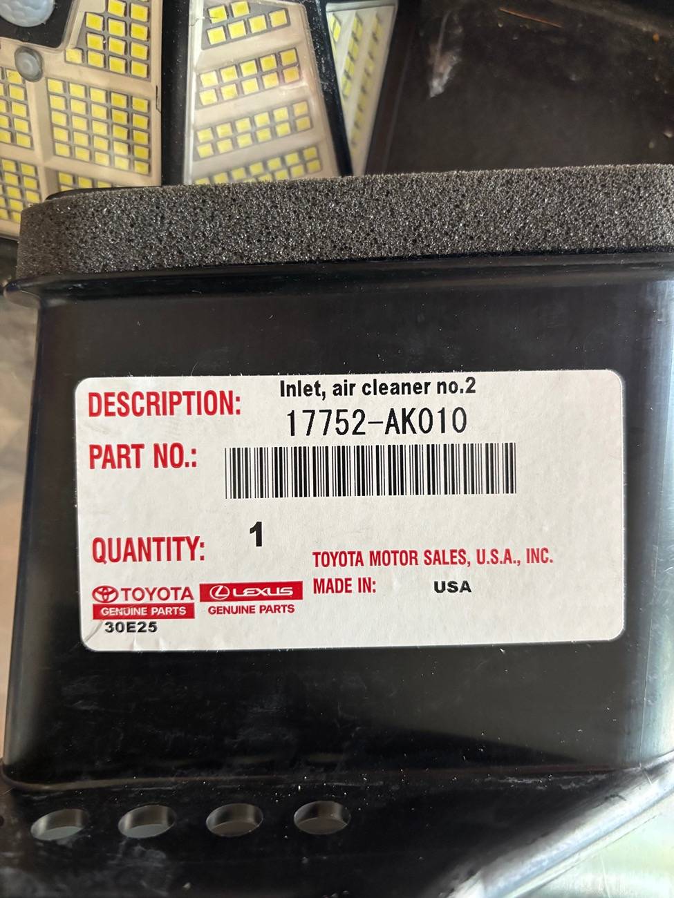

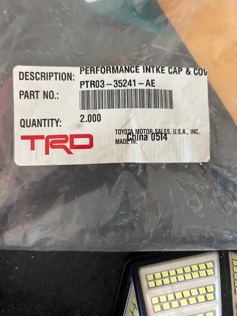

You need 2 parts and 4 clips to convert the Trailhunter airbox to route like the TRD Pro airbox:
PTR03-35241-AE - Taco Coupling Kit (This is the red elbow for the front intake basket and the red cap that will cap the port being used by the high-desert intake)
17752-AK010 - Inlet, Air Cleaner (this is the inlet basket that hooks up to the red elbow and clip in above the front radiator support)
90467-07217 - clips (4 needed to clip in the inlet)
The work is pretty straightforward/intuitive and should not need any instructions. I think their are some YouTube videos out there from other aftermarket intakes that would show you removal. The only 2 bolts are the 10mm bolts holding the rubber elbow that connect to the high-desert intake in the fender.
I cannot say enough about how happy I am with this mod and being able to keep everything factory. Windows down is enjoyable again! I also did not realize how much of the intake noise you actually do hear with the windows up. Just got used to that over the 20K miles, but now it is weird for it to be gone.
