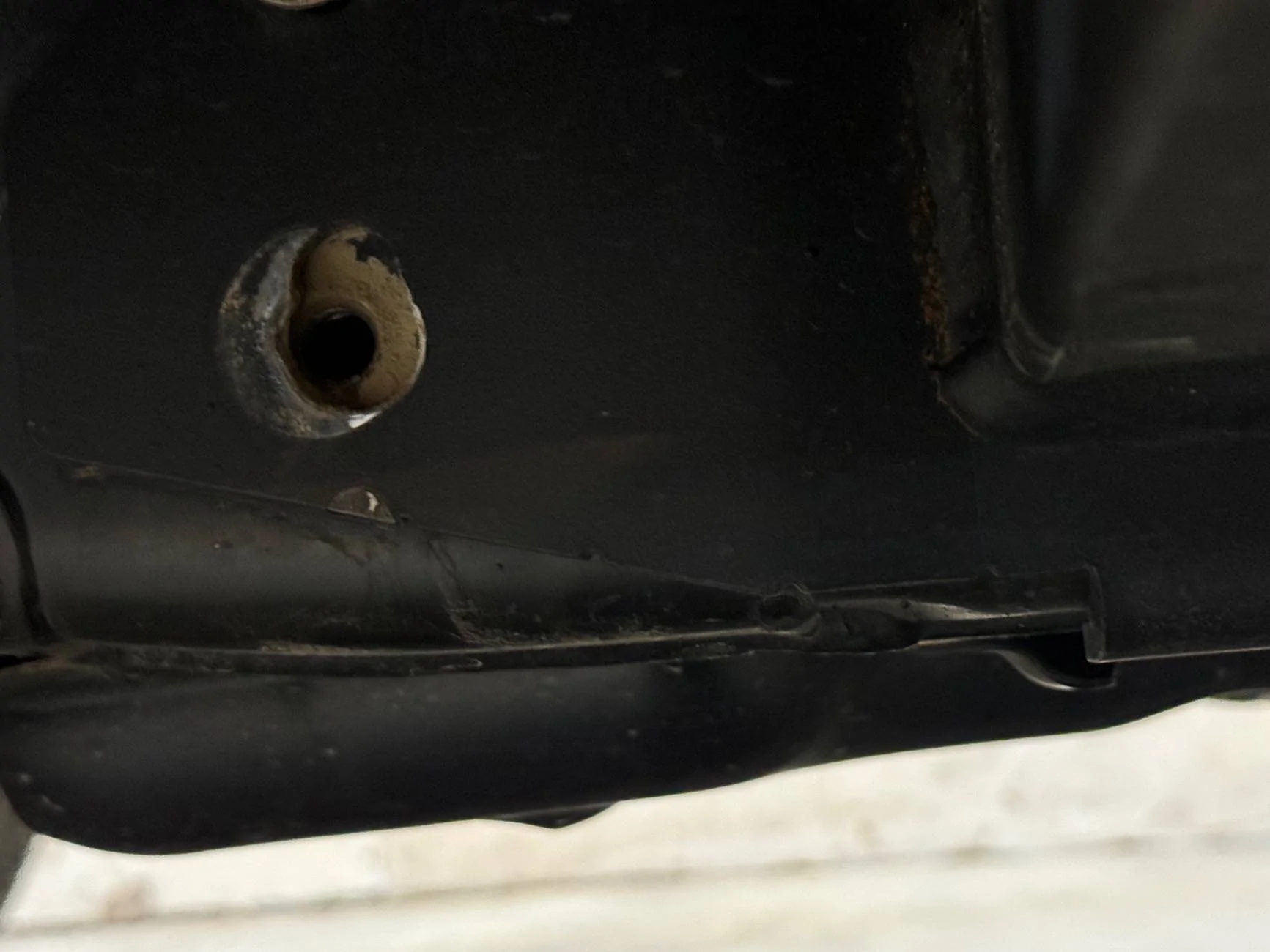

My passenger side front m10 bolts don’t line up, I got everything loose and there’s no play

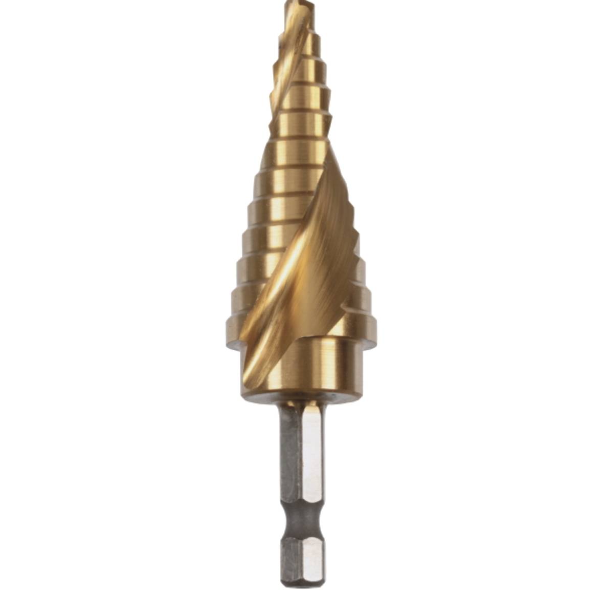

Is had 1 that was off about 1/8 of an inch. Mark the area that is off, pull all the bolts except 1 at the opposite end let the slider down get a step bit to drill it out.

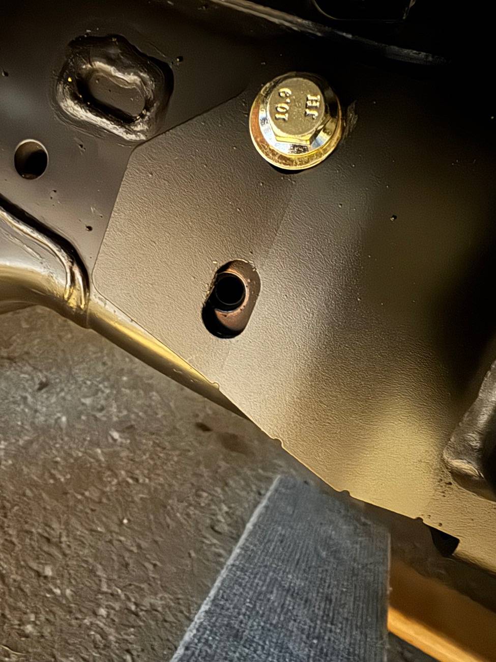

I see what you mean now, I was able to wrangle it some more and yep, passenger bottom rear

Yep mine was also passenger bottom rear. I sent RCI an email but apparently they haven’t corrected it?

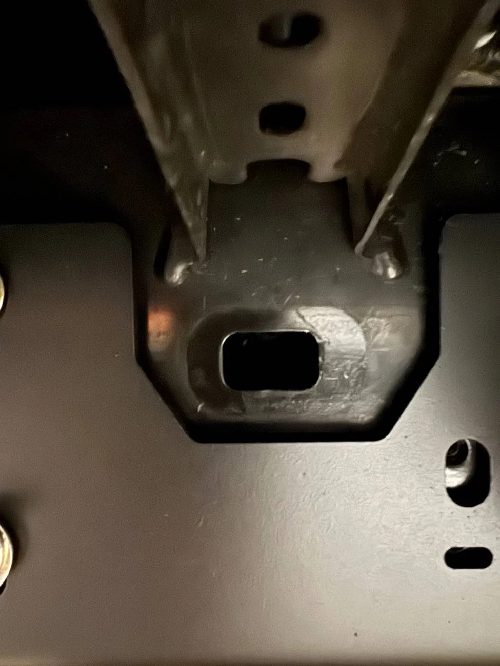

Why did I break out that wide plastic clip? It’s specifically pointed out in the instructions but the slider goes completely around it?

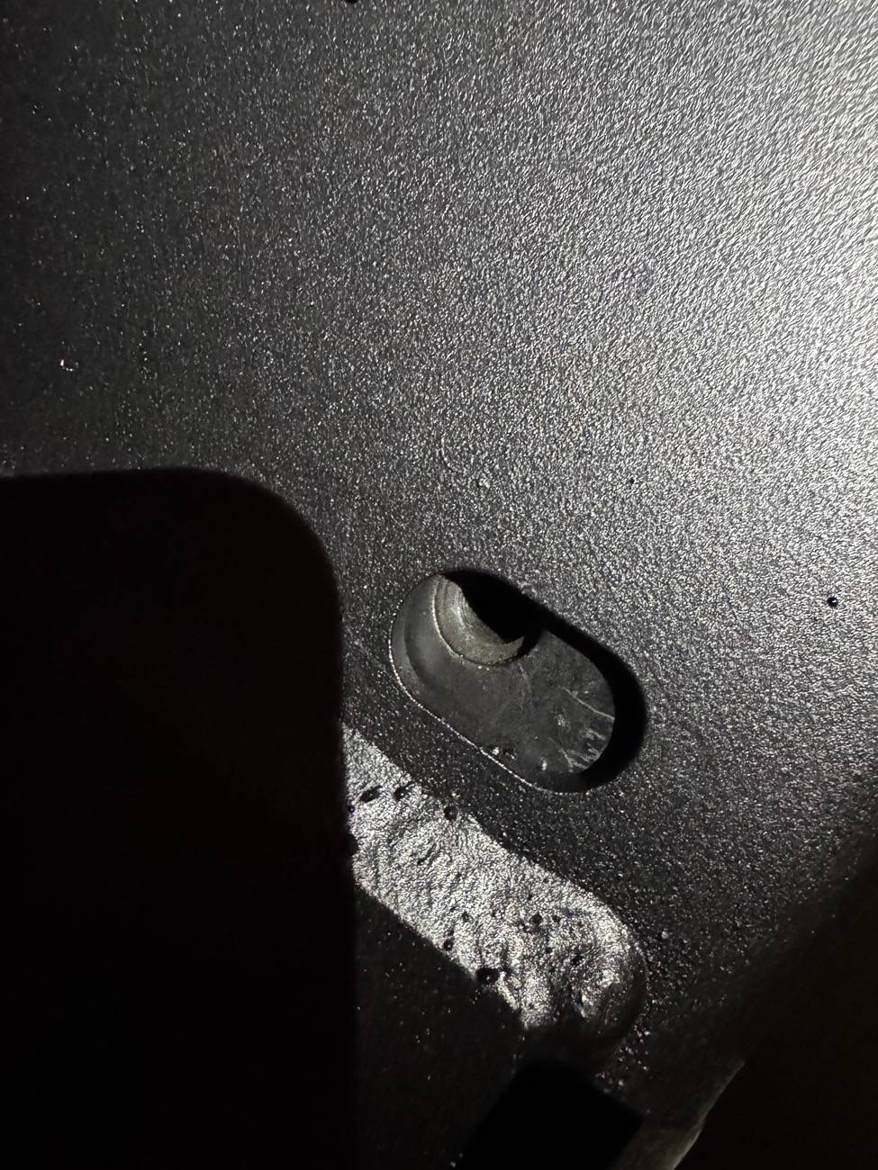

I’ll get you detailed pictures tomorrow of the area on the slider that had to be opened up, not the pickup frame! the plastic one plugs and … I’m going to paint the bolts!

Lower rear passenger bolt hole needed drilled.

Thanks! That wasn't a huge move on that hole and we will see if your feedback ever worked.

7 of 8 bolts in this is what you get for the passenger rear bottom

Instructions have you pop the clip covering this hole, not sure why
