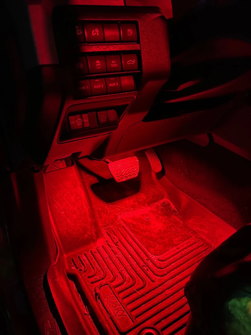

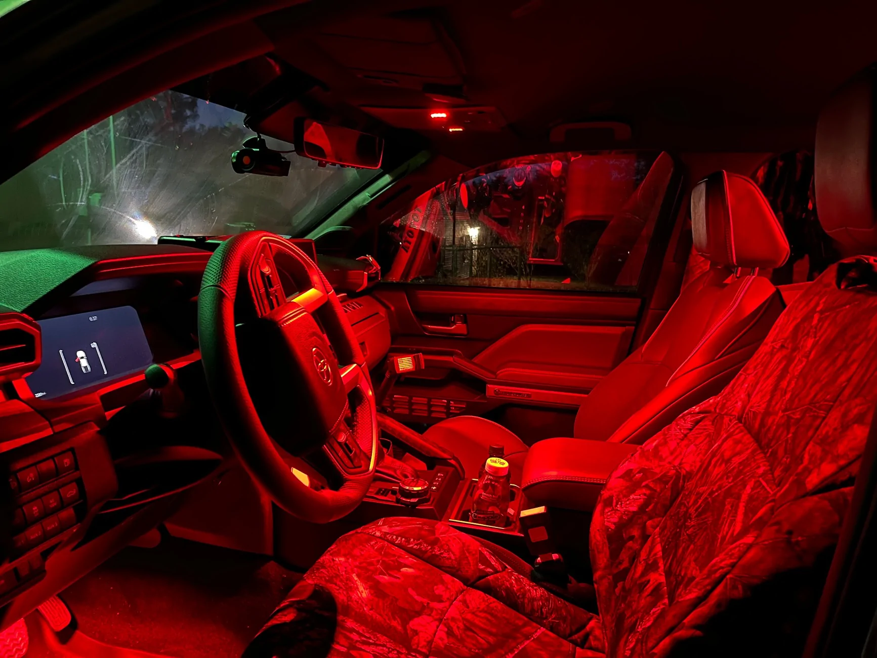

I have all my meso lights set to red for hunting season. Will change them back to white after season ends. I also installed the extra set of the door courtesy lights in the footwells so everything would match

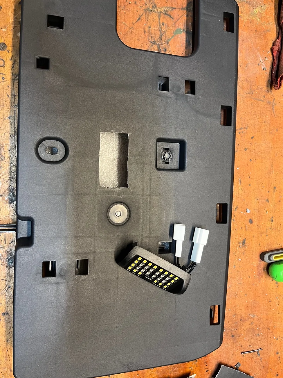

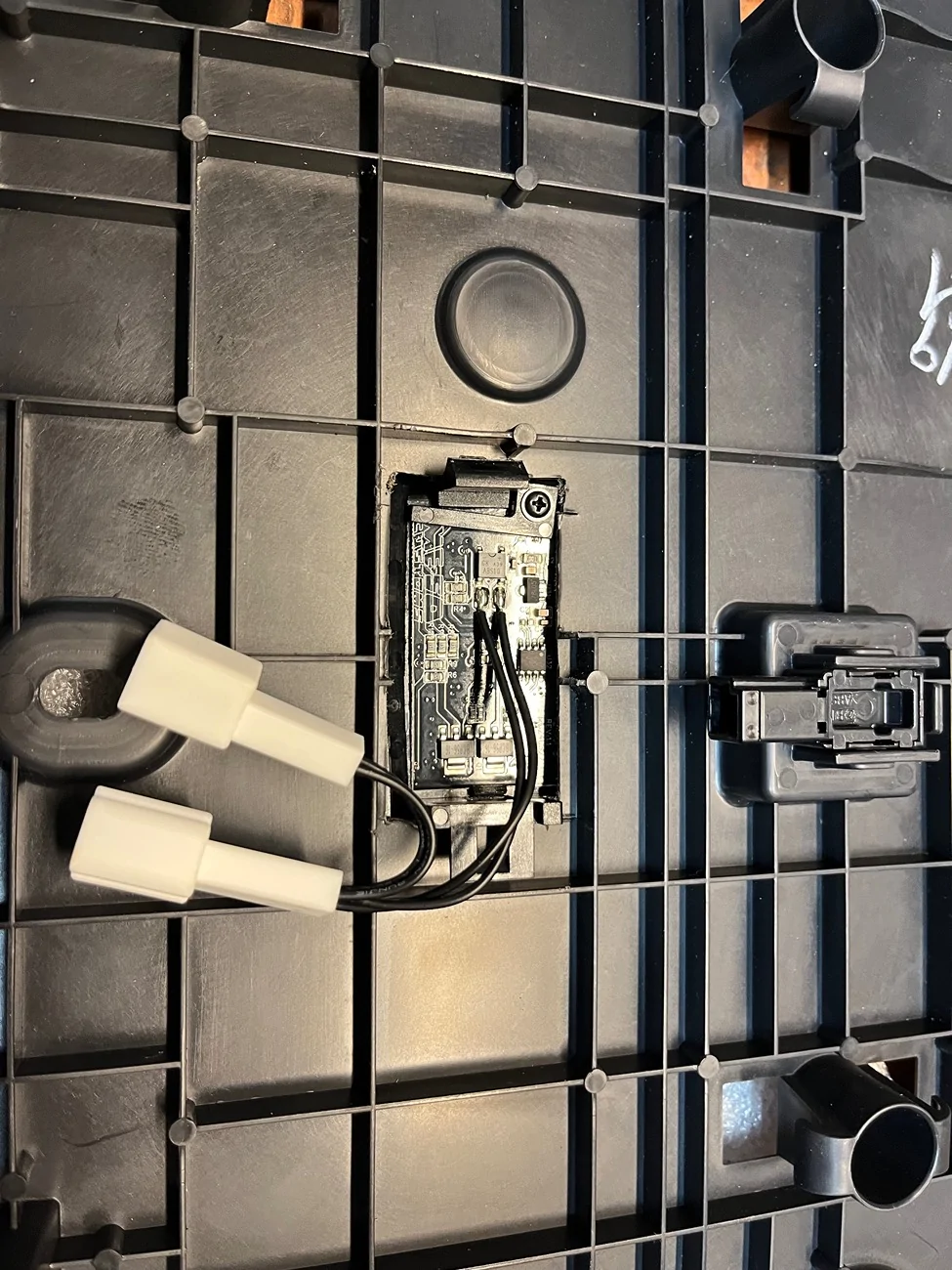

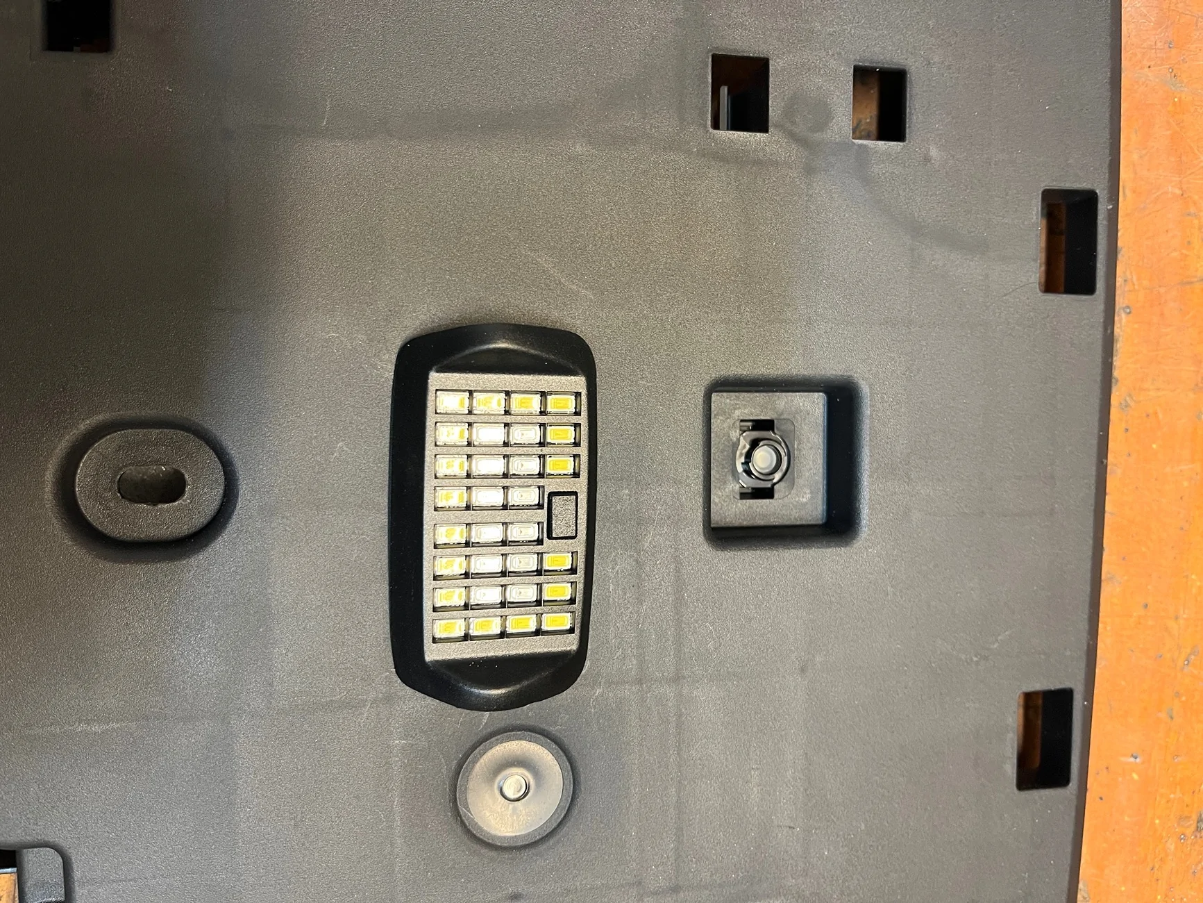

All you need to do is remove the upper panel and just cut a hole for the meso light.. plugs into the factory plug

This is what I did a while back. Really simple to do

Just a straight edge and utility knife. Holes don’t have to be perfect. Just keep fitting the light till ya get it to snap in. Plug and play after that
