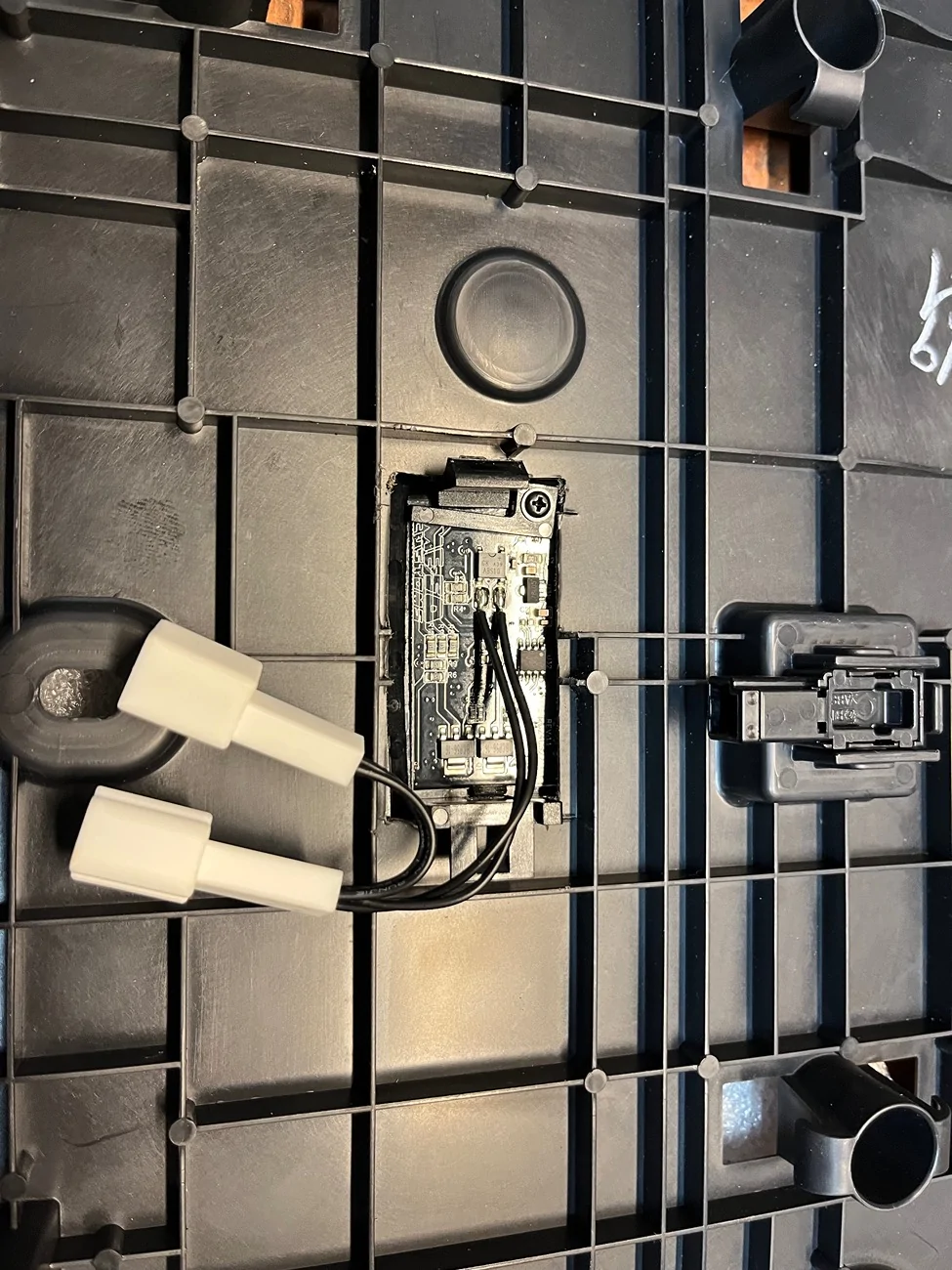

You’re going to have to be careful if using Velcro because the back of the lights are open with all the electronics exposed. That’s why I decided to do the cut instead.

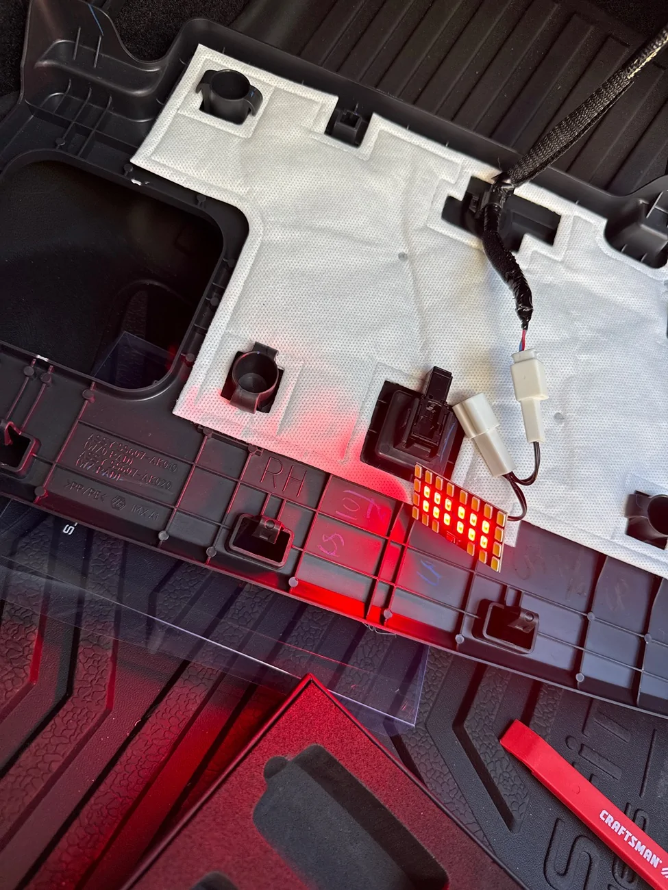

I took off the panel yesterday and I unclipped the OEM light then attached a Meso light. The wire is not long enough for me to Velcro it anywhere that will point the light to illuminate the space to my liking, so I will cut. First I need to get replacement lights from Meso since the mounts are broken even though the LED works. The mounts are broken over the exterior housing but the little piece inside that holds the circuit board to the housing.
Agree, I see what you mean after looking at it yesterday. I have a bunch of insulation on my panel so I will cut enough of that out of the way.

Quick update: Meso responded to my email within 3 days and sent a prepaid return shipping label. I’ll get that printed tomorrow and sent back to them. They will send replacements.

Well, you do need to cut a hole like the guidance above indicates.
