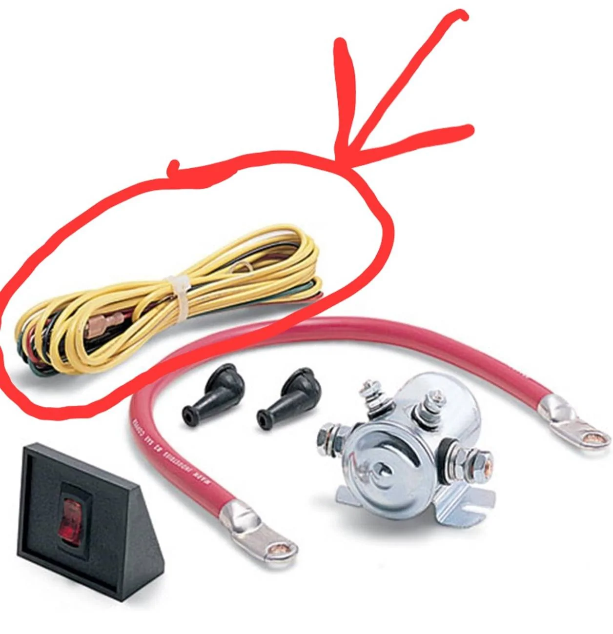

If I understand correctly, the yellow wires run up to the aux switch next to the steering wheel. Where the yellow wires long enough to reach from the solenoid next to the battery all the way up to the aux switch? Or does this get installed completely different than what I'm thinking?
You’re thinking correctly. And I do believe I had to extend that wire. But only by a few feet.

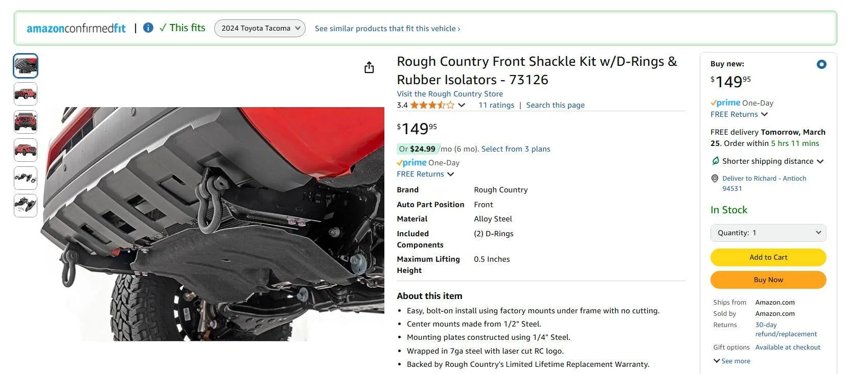

@jettaway what did you do for front recovery points?
RC Themselves obviously want to sell you theirs:
2024 Tacoma Rough Country Hidden Winch Installed on TRD Pro. No Cutting Necessary! 1742843195441-9d
but since you were able to retain the OEM skidplate, did this cause issues?

I still use the oem front hook points upgraded to the NYTOP version.
It works to get the job done
