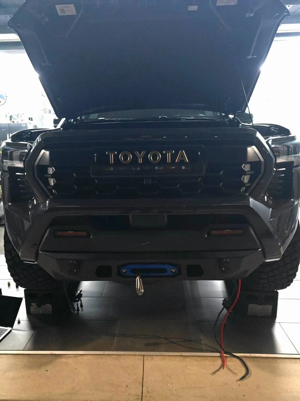

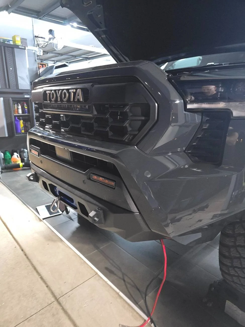

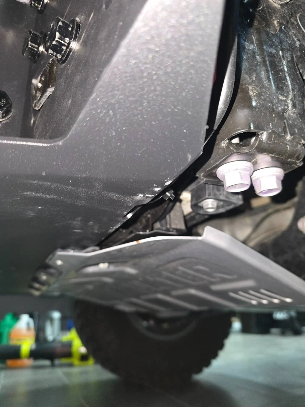

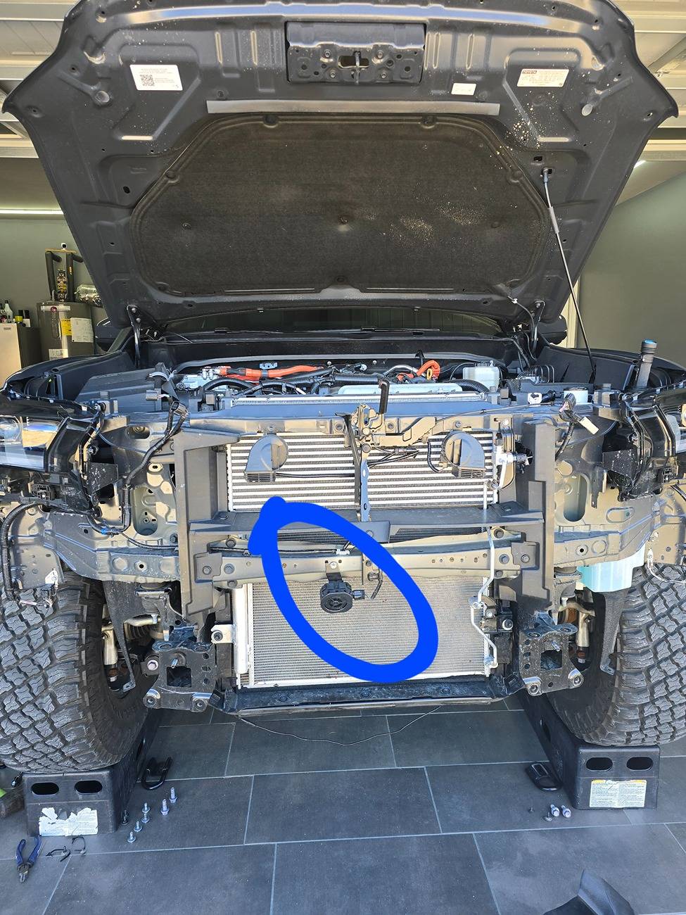

I went with the DV8 offroad bumper. Fits well and was still able to use the factory skid plates on my Trailhunter. I used the Openroad Panther 3s 12k winch. The only thing I had to relocate was circled in blue.
Are you able to reach the free spool?

Yes. it's tight but the square openings on the side of the fairlead. I was able to rotate the handle forward to make it a little easier. Now, connecting the hard wire controller might be another story. I have 2 wireless controllers and I think I'll keep a couple of spare batteries handy to make sure they don't go dead.
Awesome! I like this bumper. There is a 10% off code now. It looks really good on your truck! I think I'm going to pull the trigger now. How did you run the power cables? Did you get extended positive and negative that run all the way back to the battery? Or did you use some other type of system that brings the power up to the engine bay?
