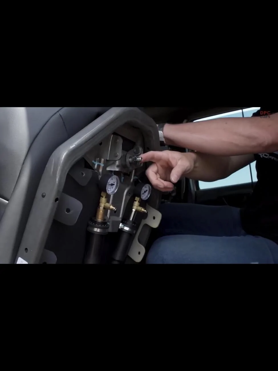

attached a photo from a YouTube video. I’m wondering if it has something to do with the piece his finger is pointing at? The seats pivots forwards and back there.
yes, I think so. My guess is there is some type of urethane bushing in there that’s supposed to allow it to slide smoothly without metal to metal contact but it’s not sliding smoothly.
Makes sense. Might be why my "clunk" doesn't seem as pronounced now. Things must be wearing in there...which could be good or bad ?
