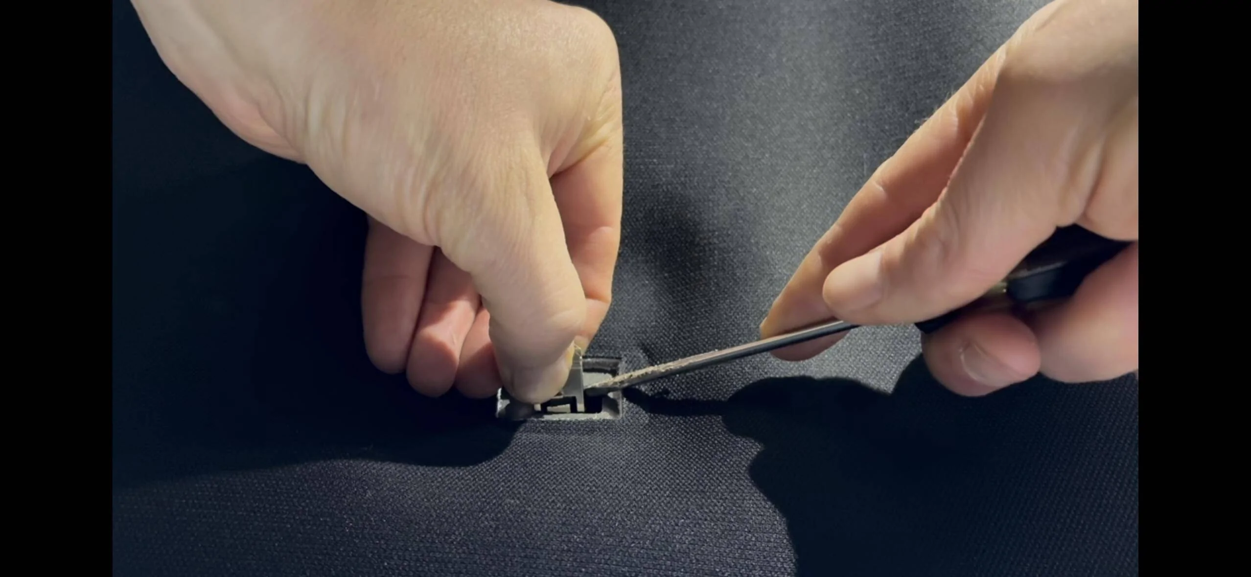

Unlike past generations, the rear hangers don't twist to remove. You need to pop off the cover and then remove the metal clip that holds the hanger. Two small screwdrivers or spudgers will do the trick on the cover.

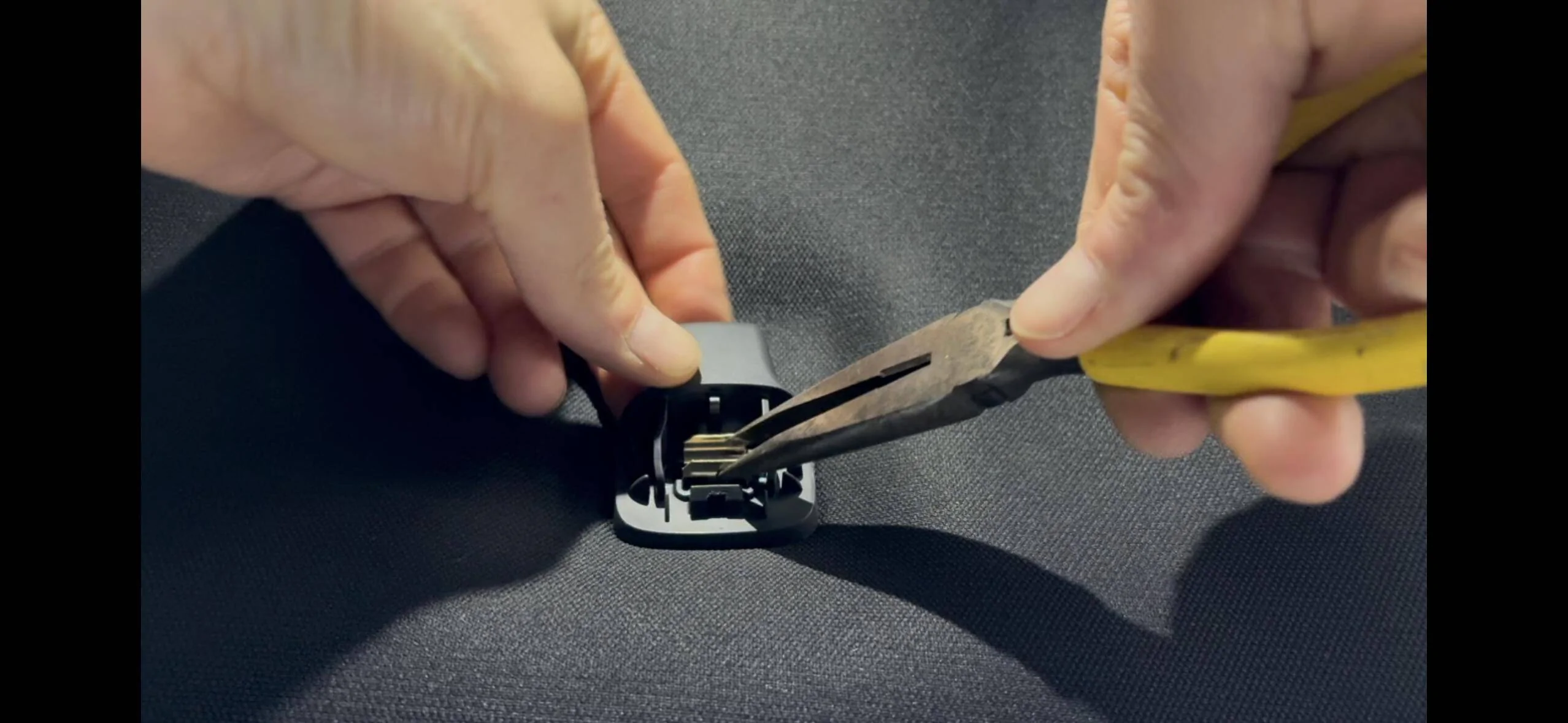

Release the hanger from the metal clip. Needlenose pliers help.

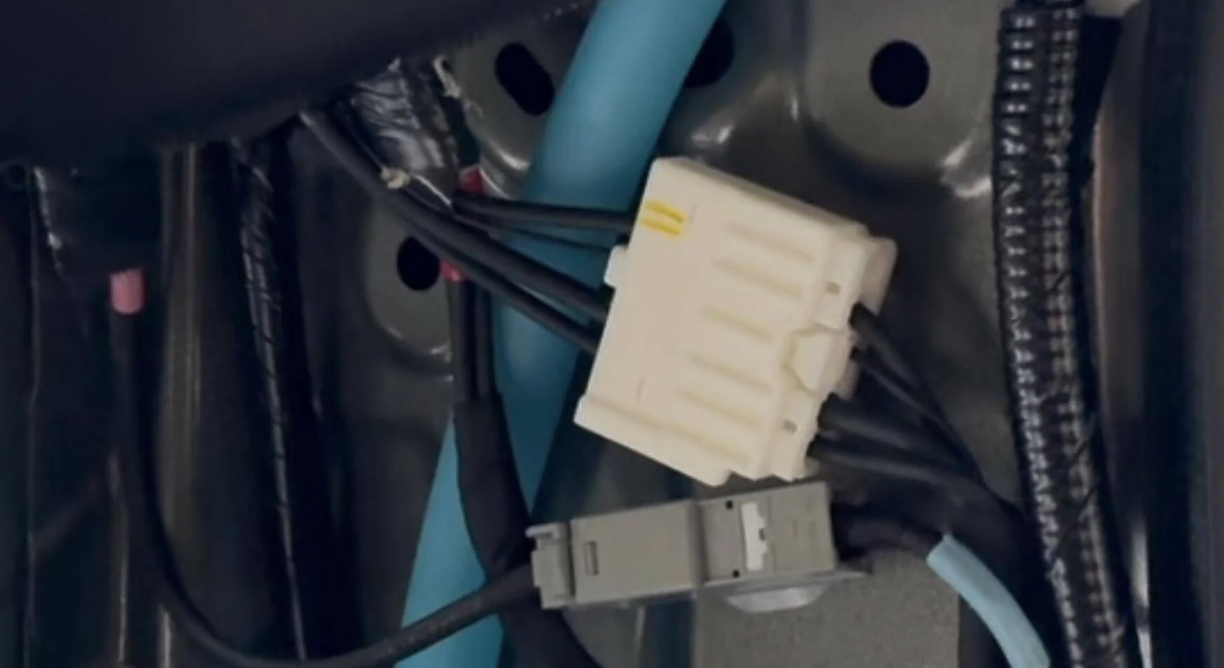

Remove C-pillar covers on both sides for ease of access to antenna connector. The driver's side C-pillar covers the white connector that can be disconnected to make the process easier. Also, cut or remove the tape that holds the antenna harness to the edge of the headliner at the top of C-pillar.
Drop the rear portion of the headliner that is above the rear window so you can see the antenna harness/antenna connection.
Remove the 10mm bolt that holds the antenna harness to the roof above the rear window. This bolt appears to act as a ground for the harness as well. You will re-use this bolt later on when stashing the shark fin antenna in the dashboard, if that is where you choose to put the antenna.
If anyone is interested in camera removal or relocation, the grey connector next to the white connector is where the camera near the 3rd brake light camera connects.

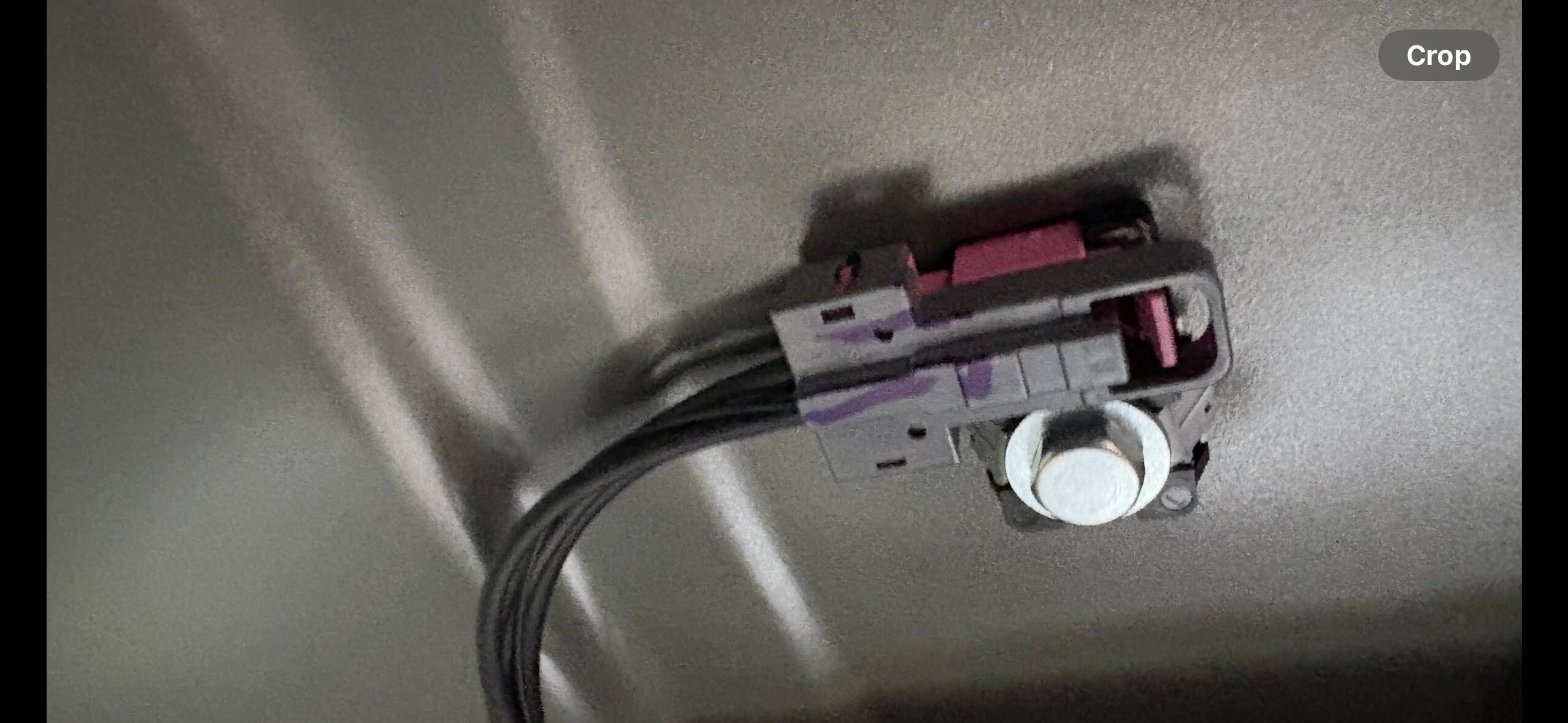

Remove the 10mm bolt holding the antenna harness to the bottom of the shark fin antenna. At this point you can remove the shark fin from the top side of the roof as well. Unclip the wiring harness between the antenna and white connector.

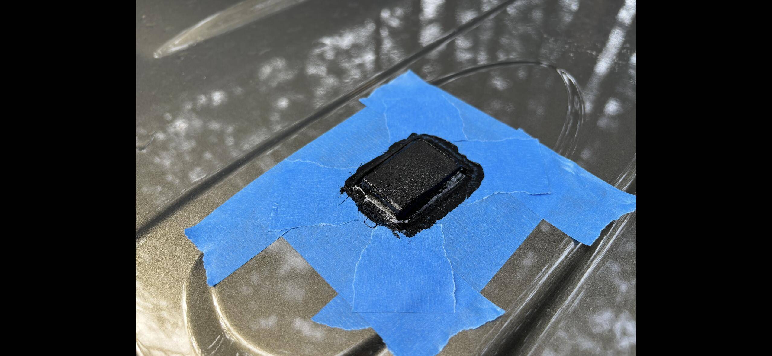

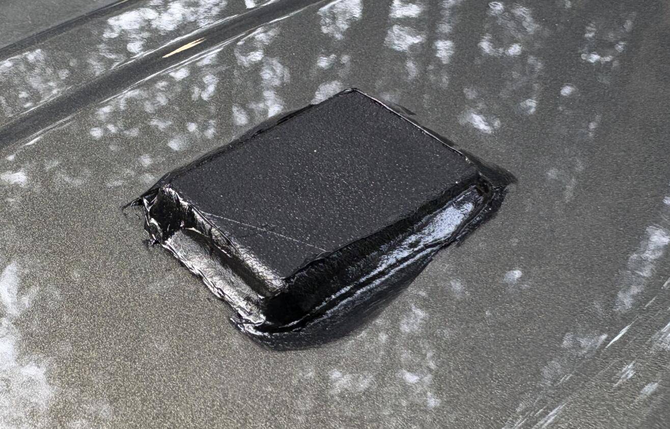

I purchased these plastic plugs to cover the hole.
I had to shave off most of the ribs/fins to fit the plug into the hole using a box cutter. I then sanded the plastic surfaces that would be seeing the adhesive because the otherwise shiny surface doesn't allow for a great surface to adhere to.
2024 Tacoma Shark fin antenna relocate to inside dashboard IMG_7617
I taped off the roof about an 1/8" away from outline of the plastic plug, loaded the plug up with Sikaflex 291 and pushed the plug into the hole.
2024 Tacoma Shark fin antenna relocate to inside dashboard IMG_7618
Here's the final product. Not super pretty but it's held out a couple of North Oregon Coast deluges, so I'm happy. Plus my new Kimbo camper won't need a spacer below it to lift it above the shark fin.

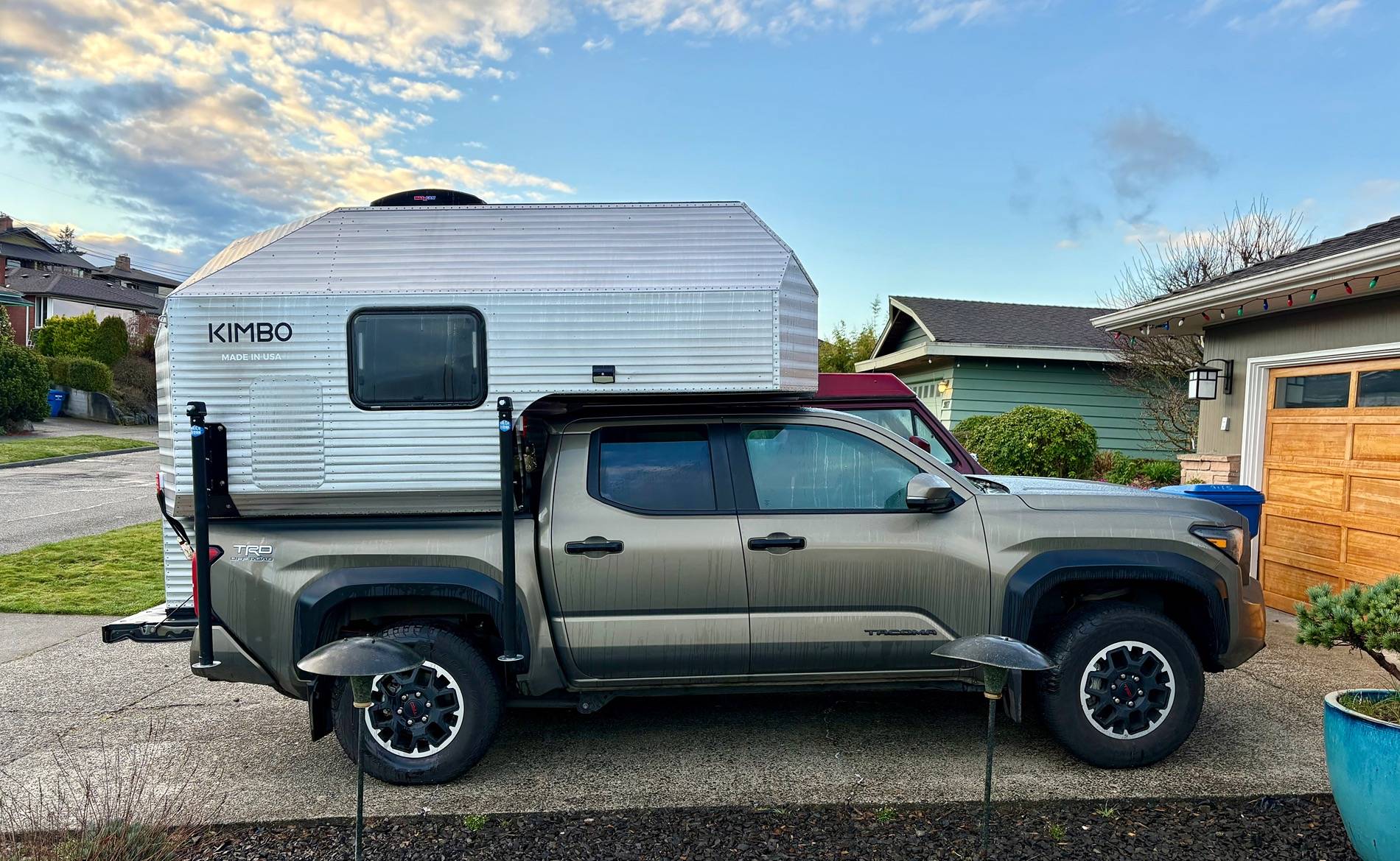

Camper is on and works great! I did need to purchase 2 of Kimbos rubber mats to between the truck bed and camper instead of just one. The bed rails are tall enough that they were going to be connecting with the bolt heads of the jack stand supports.

Nice looking setup; classy with the color of your Tacoma.
