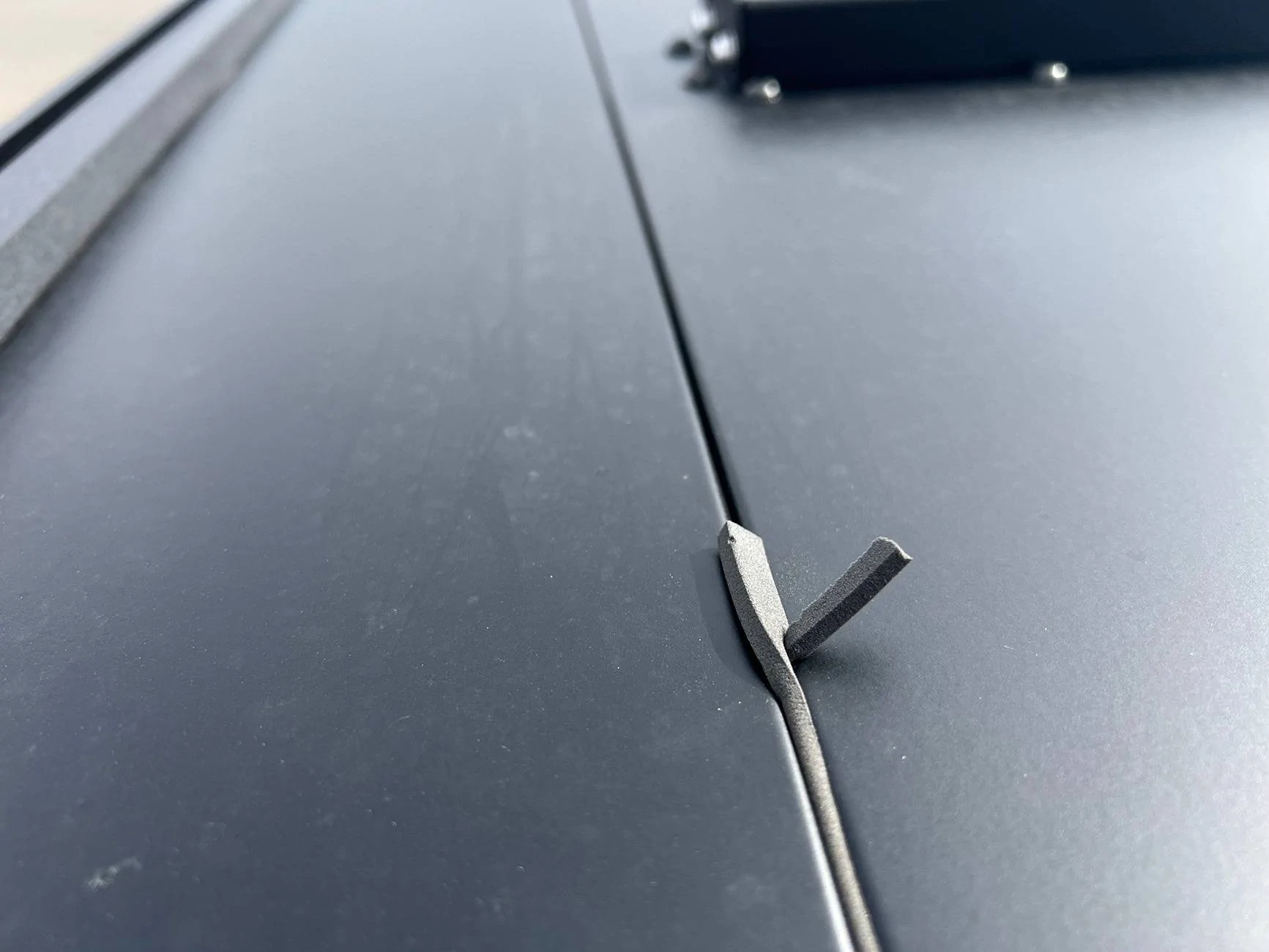

We've had one rain storm and one snow storm since install. And for both, I found water in the bed. Some up front, some in back. Water here/there on the inside metal seem joints (hard to isolate precisely). If I had been asleep in there, I'd have been wet at my head and ankles.
The dealer was a bit reluctant to even chat about it. Their 1st response made it sound expected. That "no topper/tonneau is guaranteed to be water tight."
But they have agreed to check it out (I just have not been in yet). I'll report back, but to be honest, I did not get a good feeling about their ability/willingness to helpout given they reported my experience to be "normal." We'll see.

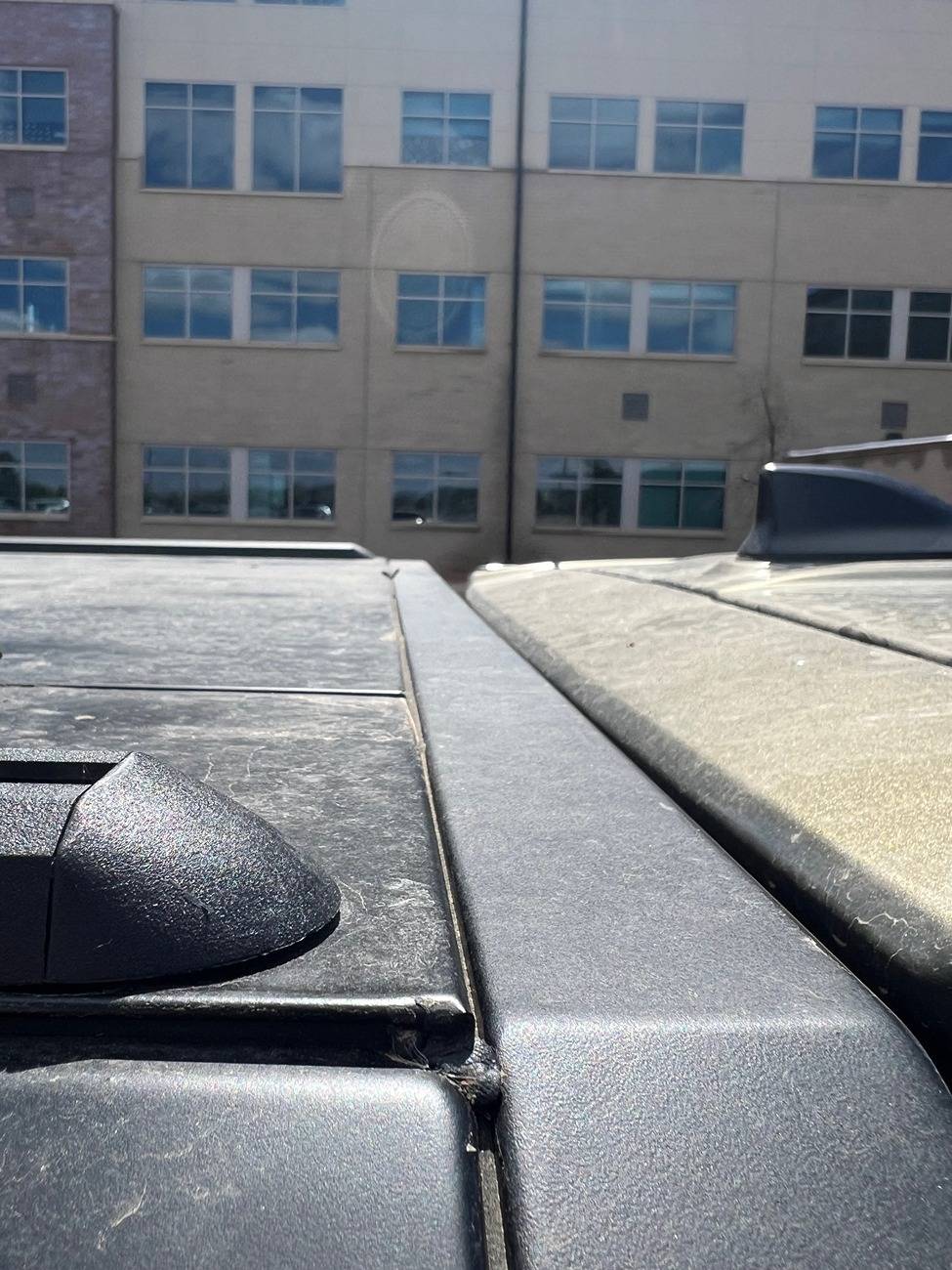

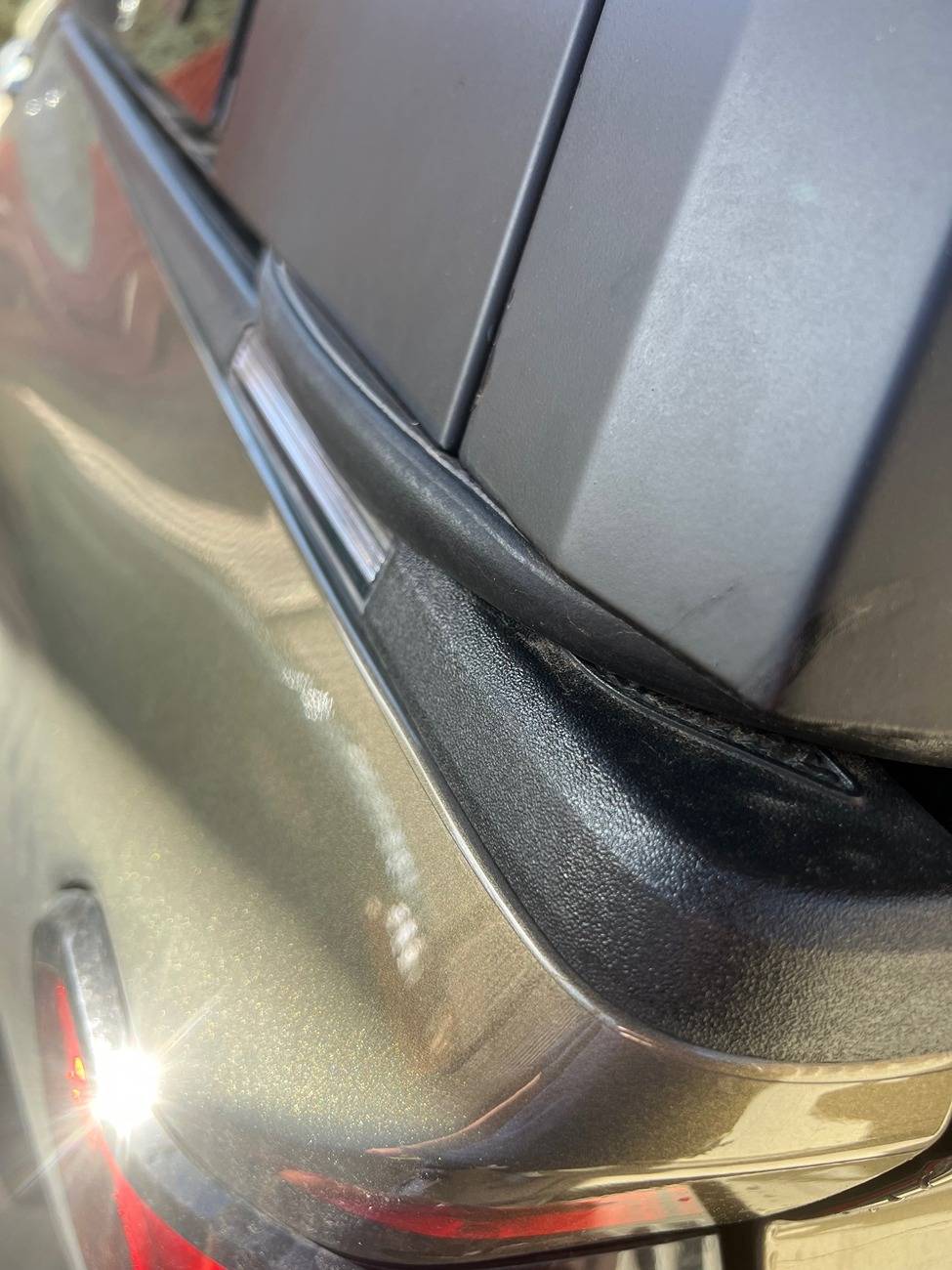

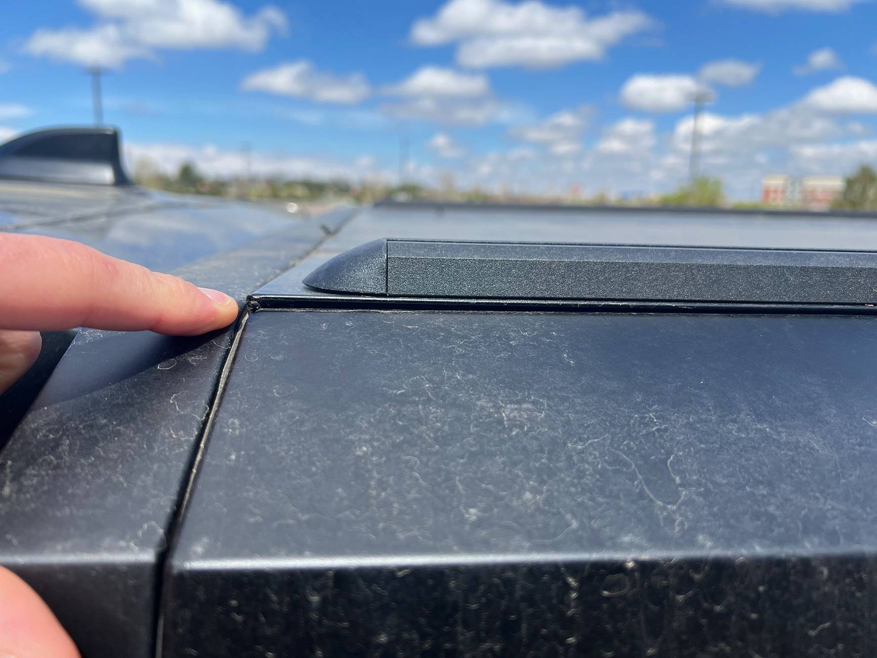

Anyone else out there with a SmartCap? What has been your experience? Is mine defective. was install poorly done?

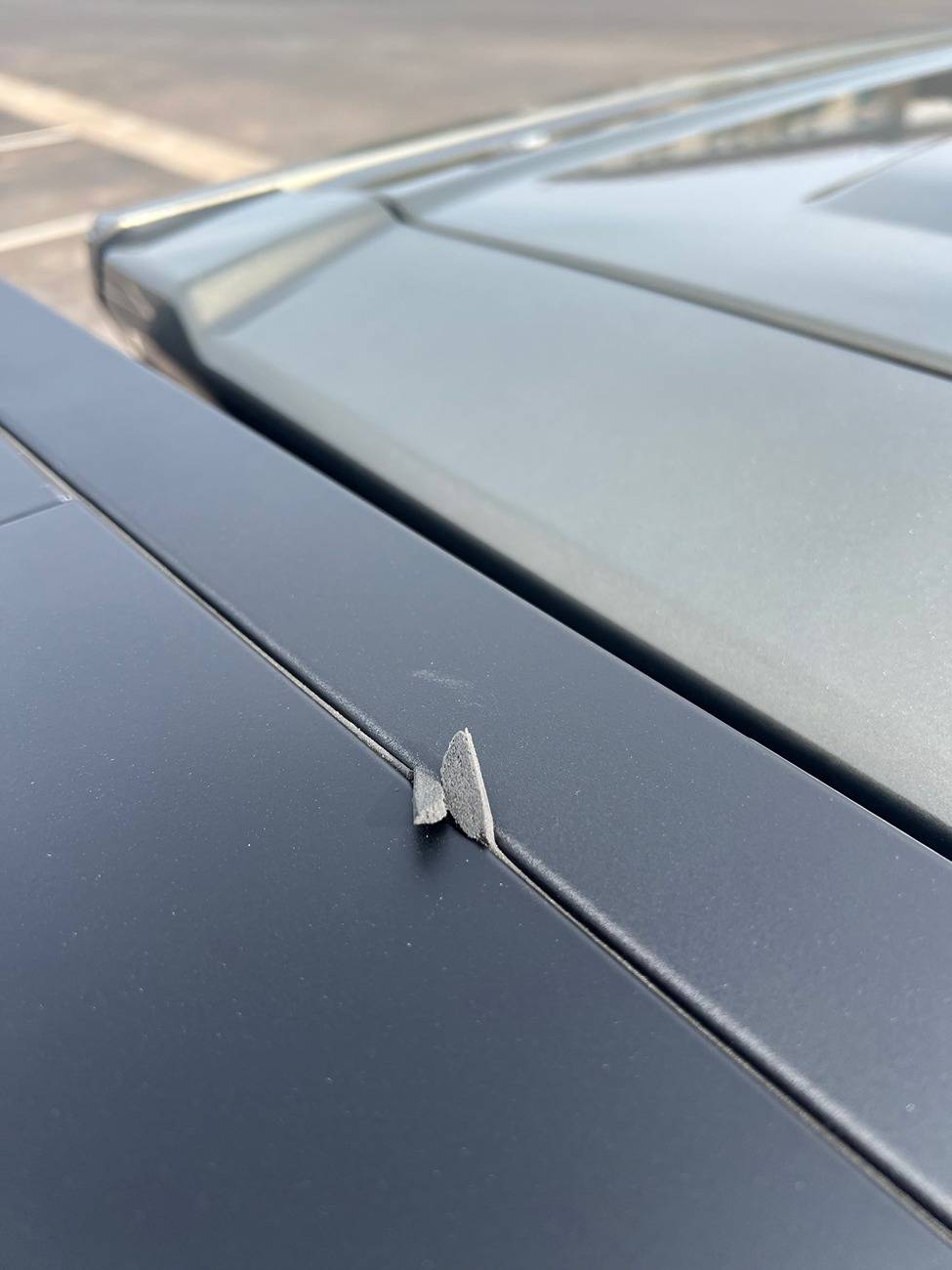

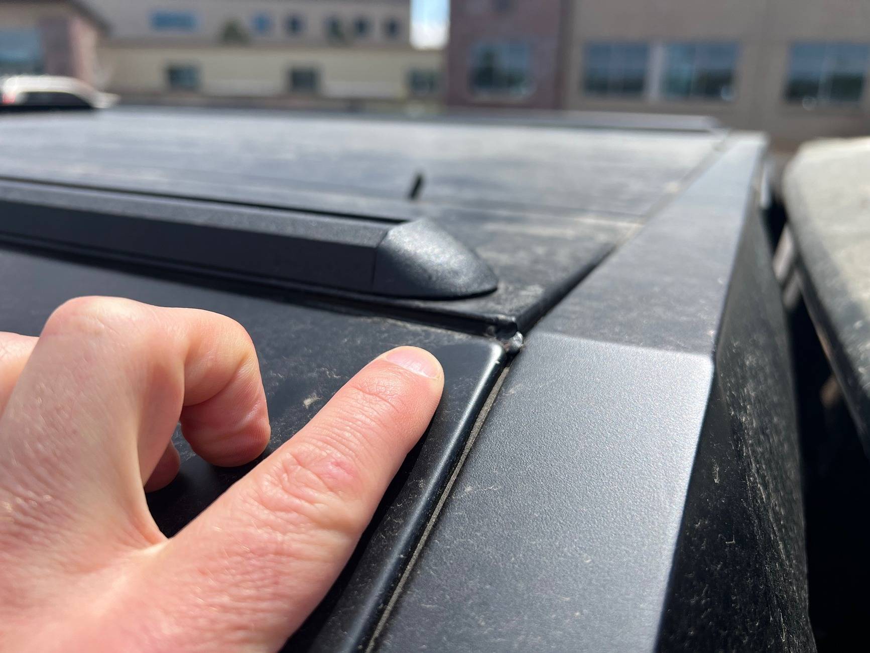

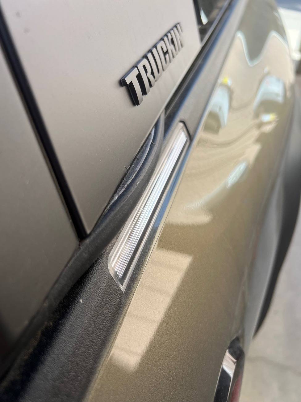

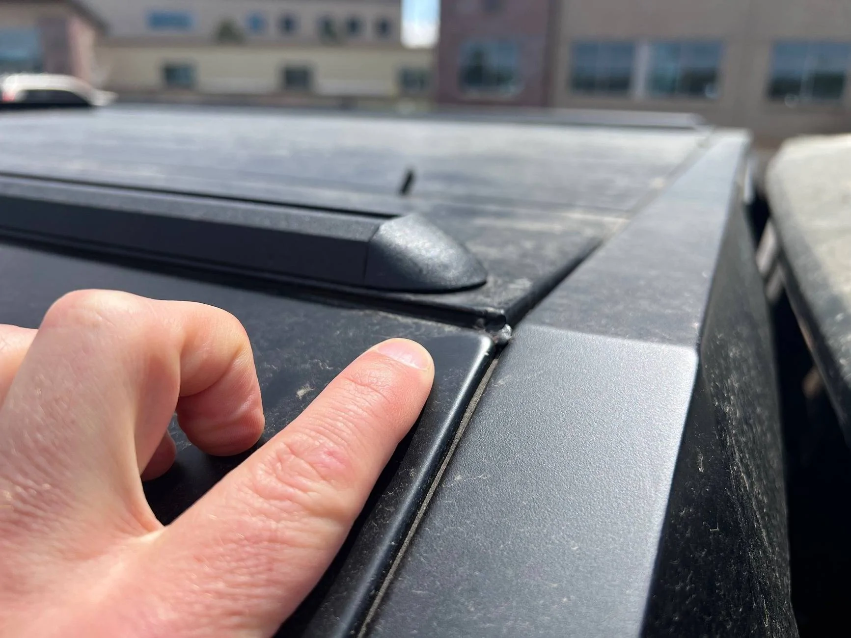

I added some photos. Not sure they help. Wonder what others have noted on there installs. Seems to me the gaskets shouldn't be popping out. Also the front end of the unit seems a bit askew or not level and with some obvious gap in the seams? And the bed rail gasket is a bit bulging in the rear, both sides?
You got a really bad install, is there another RSI dealer in your area?

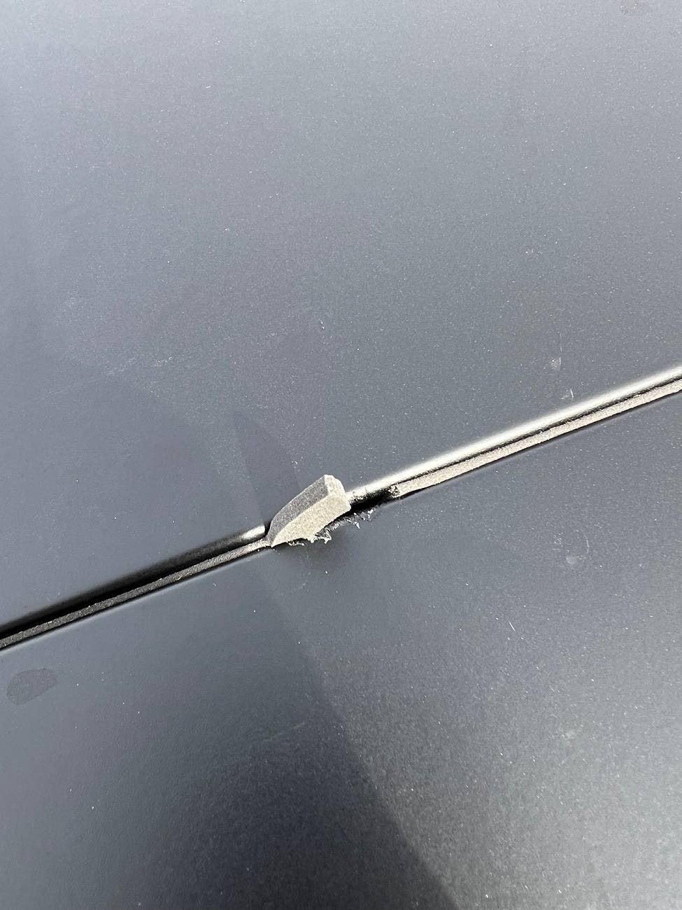

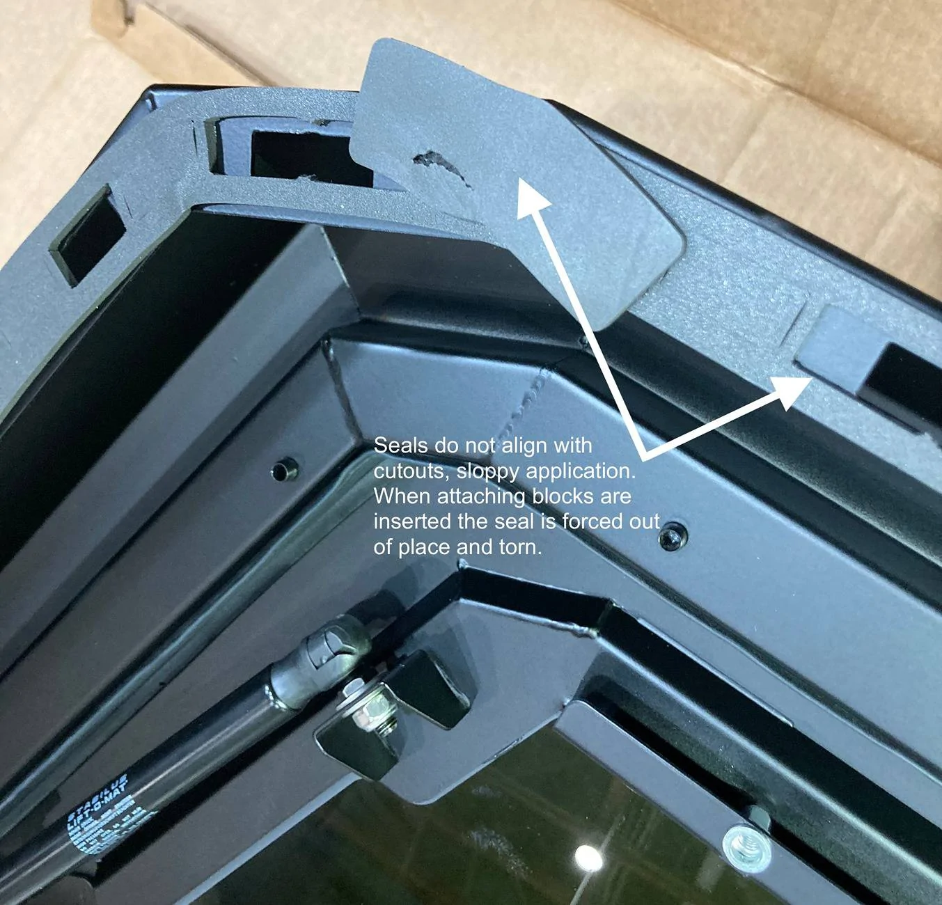

Mine leaked too, smartcap warranty support does not respond. The careless way they installed the seals caused all the problems. The seals pop'd out at almost every attach point.

I’ve had mine for 10,000 miles and it’s dry as a bone.
Some kid put yours together and I’ll bet he didn’t use a torque wrench.

I did finally get mine wet and had one leak. My brother and I assembled this one using the correct torque on all bolts. Still had 4 or 5 spots where the seal popped up over couple months or so of use (mine was from the first production run of 6' shells from last September) but it had not been out in the rain.
Rather than tear it down and trying new seals I got some butyl rubber calk and hit the bad spots (note: I made the decision to do this if it leaked back when I first put it on). We happened to have rain off and on for three days and I left the truck out. No more leaking.

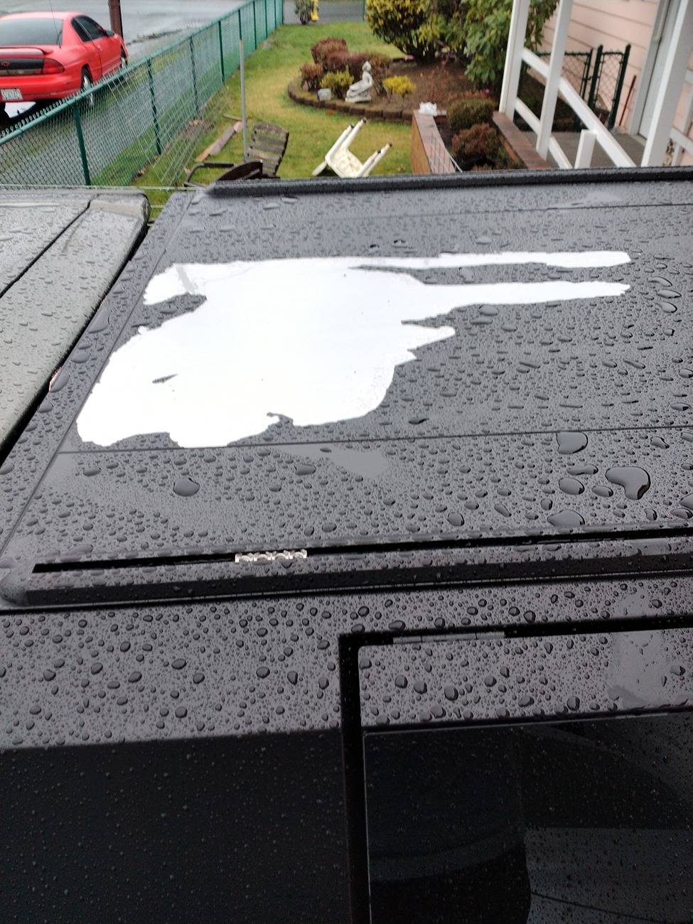

Same here, i had a first production line, 6'er and not only leaked but the powder coat came off the top after 4 months of back-and-forth and threatening to go to the Better Business Bureau, they finally replaced the whole thing along with giving me the fold down stainless steel table for my troubles ?

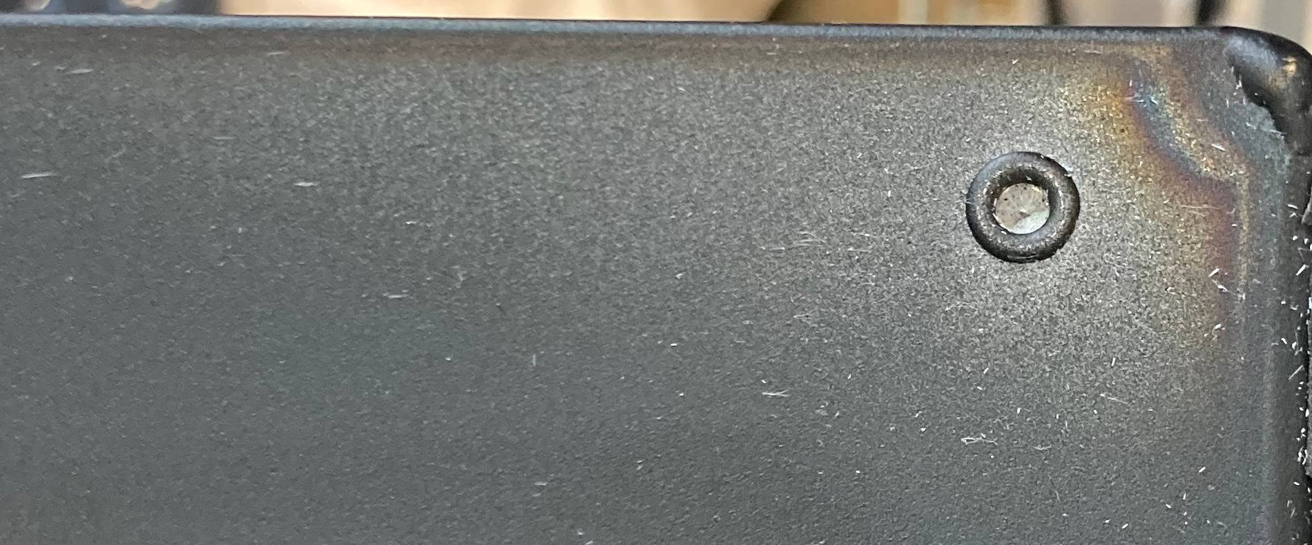

Well it's been almost a month and I finally got new seals. Not all of them just some of them.
If you get a Customer service representative named "Winnie" be prepared for a poor experience. She still won't answer my question about the missing paint with no primer under the topcoat.
