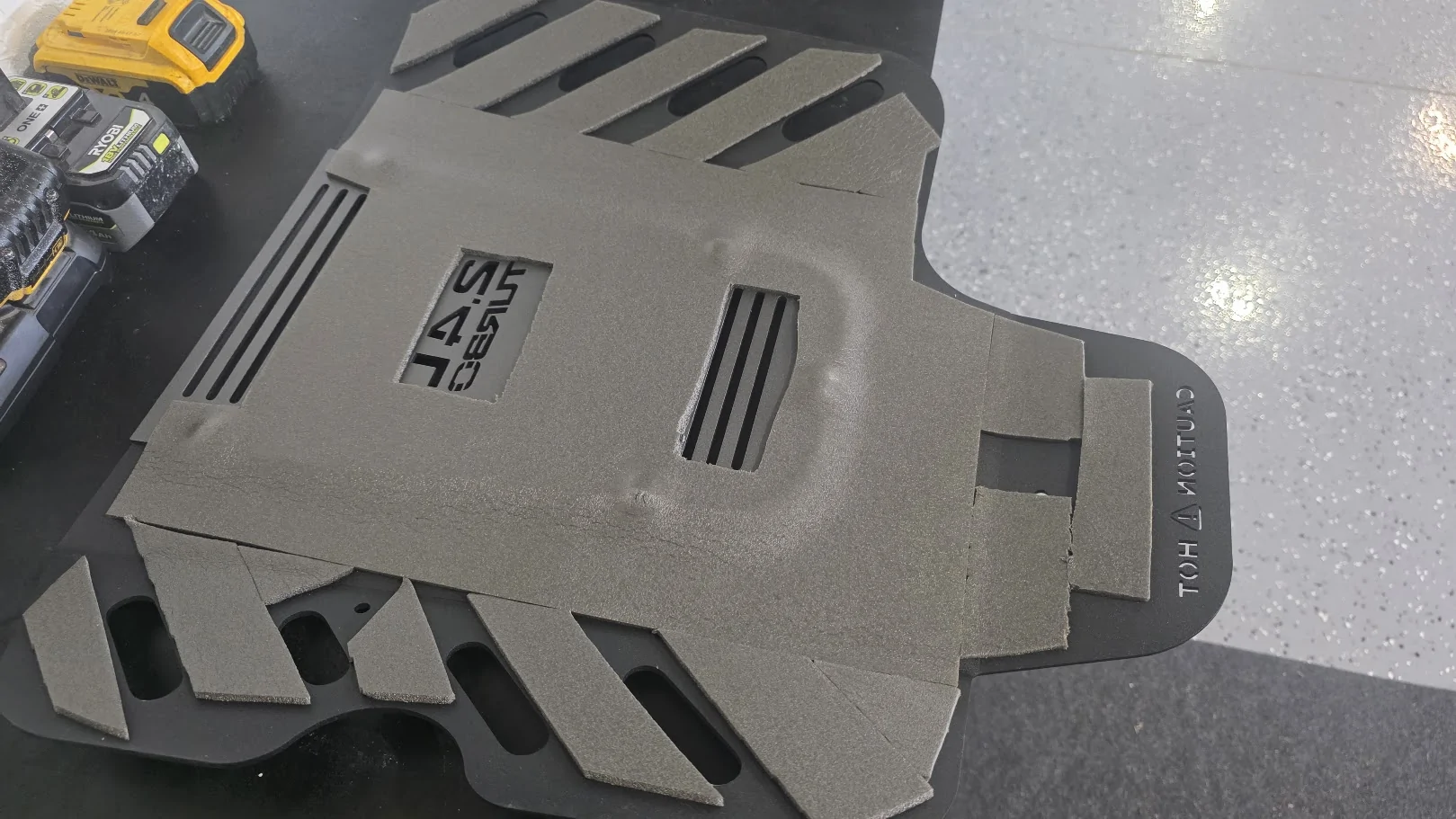

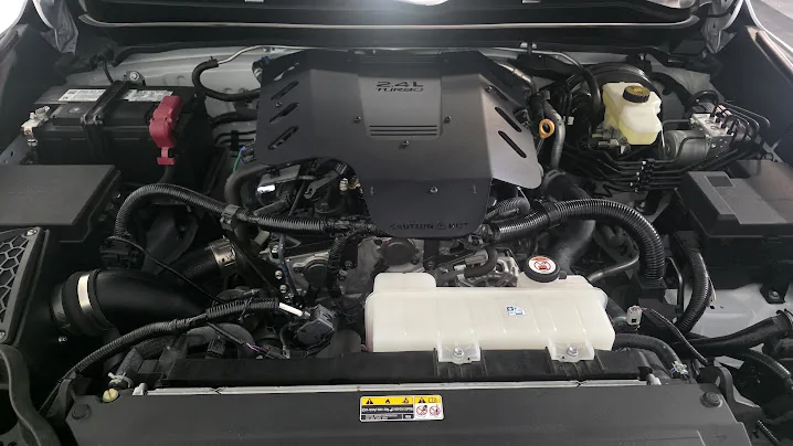

I am a big fan of turbo inline engines, however this one is a bit a noisy and not in a good way. My first attempt to quiet it down was with an engine cover. This had no noticable result in the cab, or from outside of the truck. I applied a close cell adhesive back foam to hopefully absorb some noises. Approximately 5k miles on the truck since this was installed.

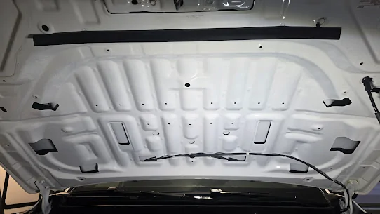

I was hesitant to use underhood sound deadener, as the heat seems like it could be an issue. But I have seen many utilize it with success, and the deadener I purchased is rated for underhood use.
Under the hood (again):

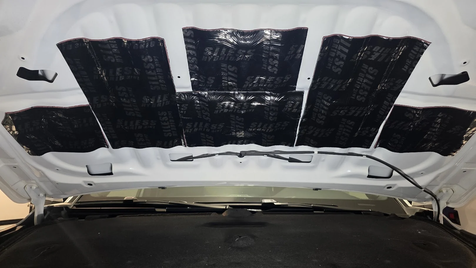

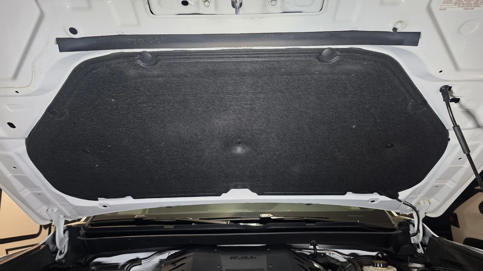

This time I removed my factory underhood material that is intended to quiet the engine. Gave it a quick wipe down, and installed some small peices of 3 layer deadener to the outer sheet metal, then full size sheets to the inner. Then reinstalled the hood liner. This had GREAT results and I highly reccomend this if you find the engine noise not to your liking.

aha, mine looks exactly the same. i used siless max tho

Is the Siless stuff heavy? Think it would give Redline hood struts a problem?
I was actually going to add the hood struts, but havent yet so I cant speak to that. I dont forsee an issue as it didnt add much weight overall. I could weigh a square this weekend and tell you exactly how much we put on there.
From the picture that Drifte posted, I can tell you my hood has practically the same layout of sound deadener. I have the no name brand hood struts installed, and it is not an issue, it actually counter balances it a bit better rather than the hood popping up all squirrely it does it nice n smooth. On the way down, less effort is now needed to get the hood fully closed. Still has a somewhat loud sound, but less than before, and a small kind of thud closing .

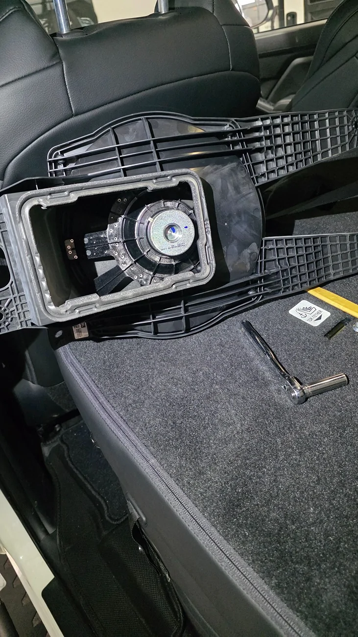

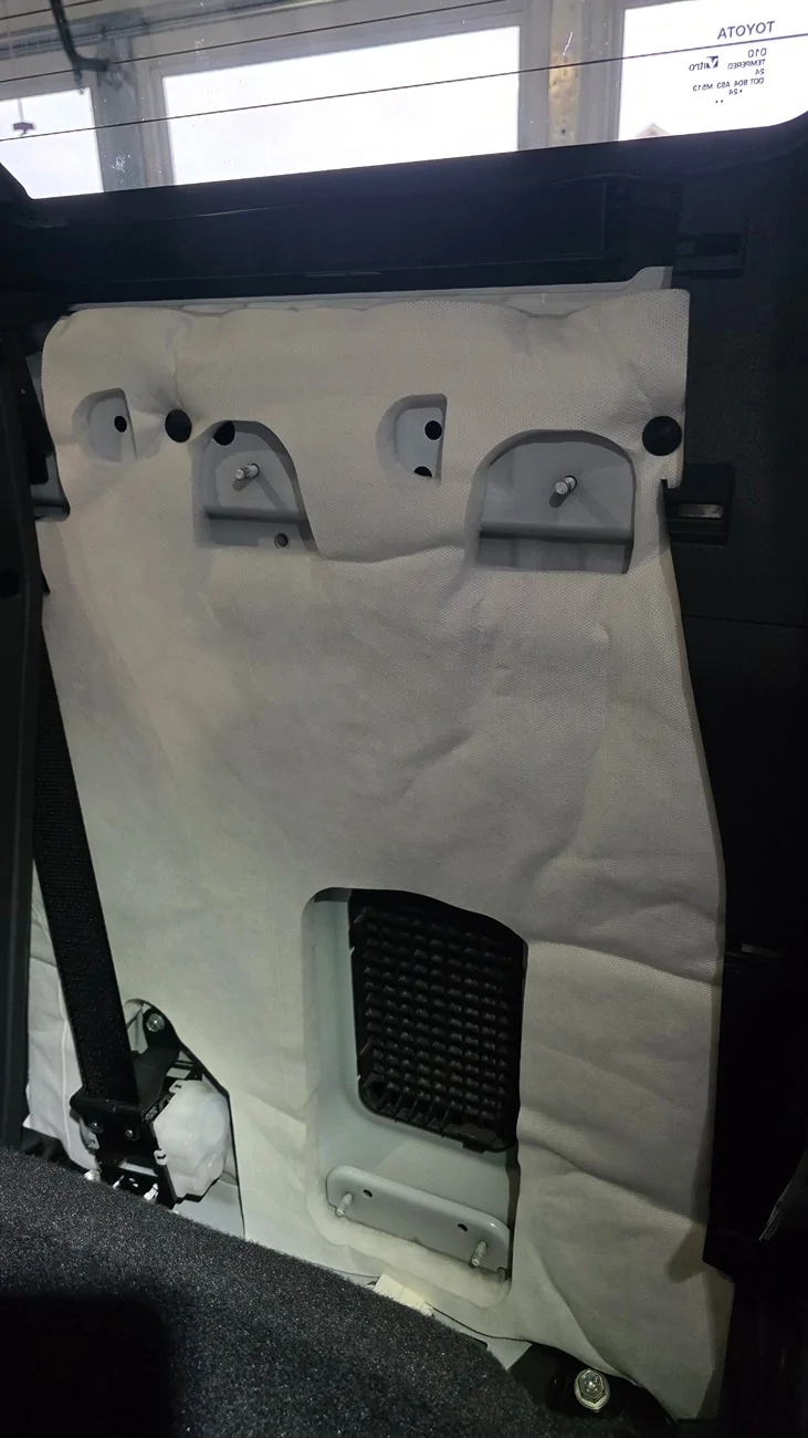

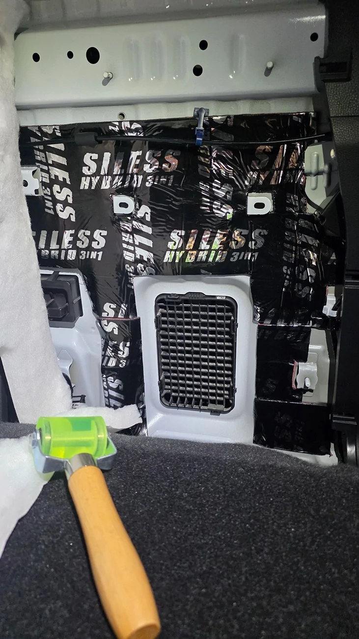

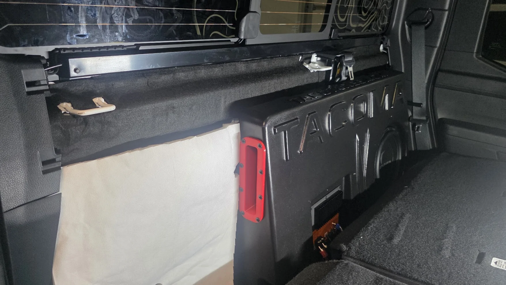

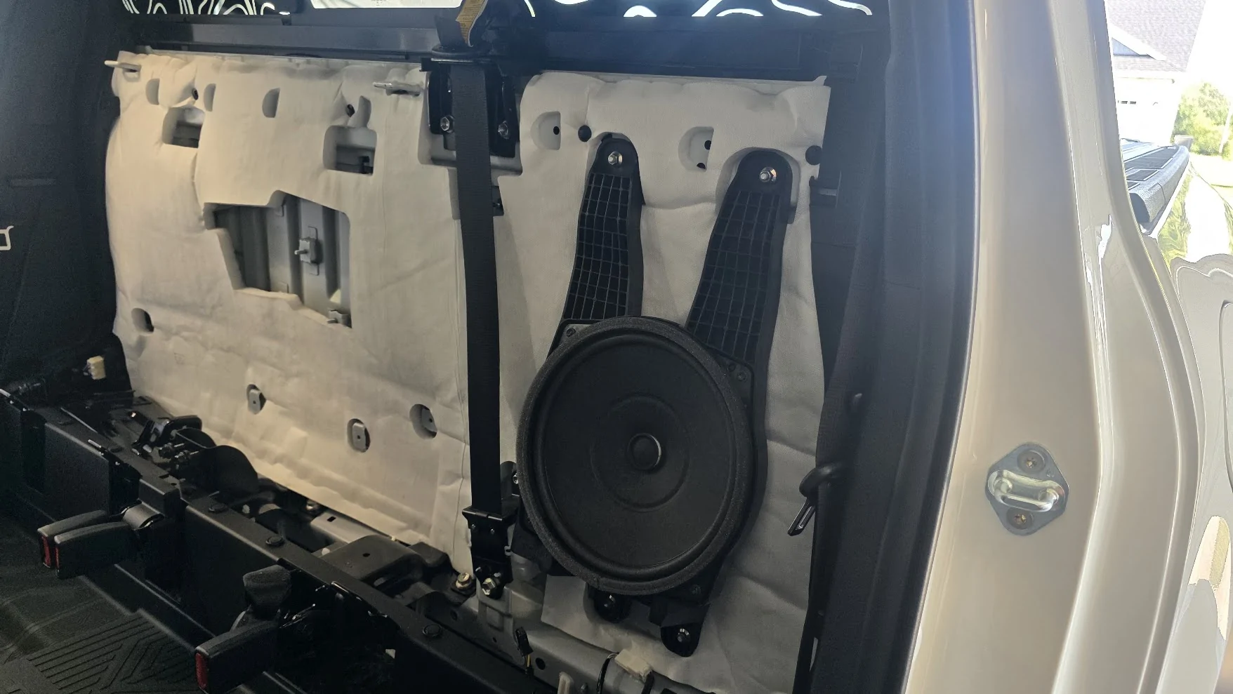

Had some time today to inspect the jbl sub and space behind the rear seats. I had my suspision the jbl sub was infinite baffle given it's small space but ability to get low. As it turns out. It is IB, and I may revisit that to build a higher output IB sub setup. With the sub cover popped off (very easy) I can see some wasted space. And an opportunity for a little deadening as that back wall had some ring to it and seems to be a single wall panel. Placebo effect or not, my wife and I agreed the bass needed turned down a notch after I did this treatment.
For the record, I design A/V systems and often use JBL components for my basis of design. My preference is flat response but absurdly low bass response. I like the sound I get from this trucks factory system, I'd like more low end but to properly do that can be expensive. I do not like punchy subs haphazardly tied into a random audio signa in a tiny sealed enclosure.

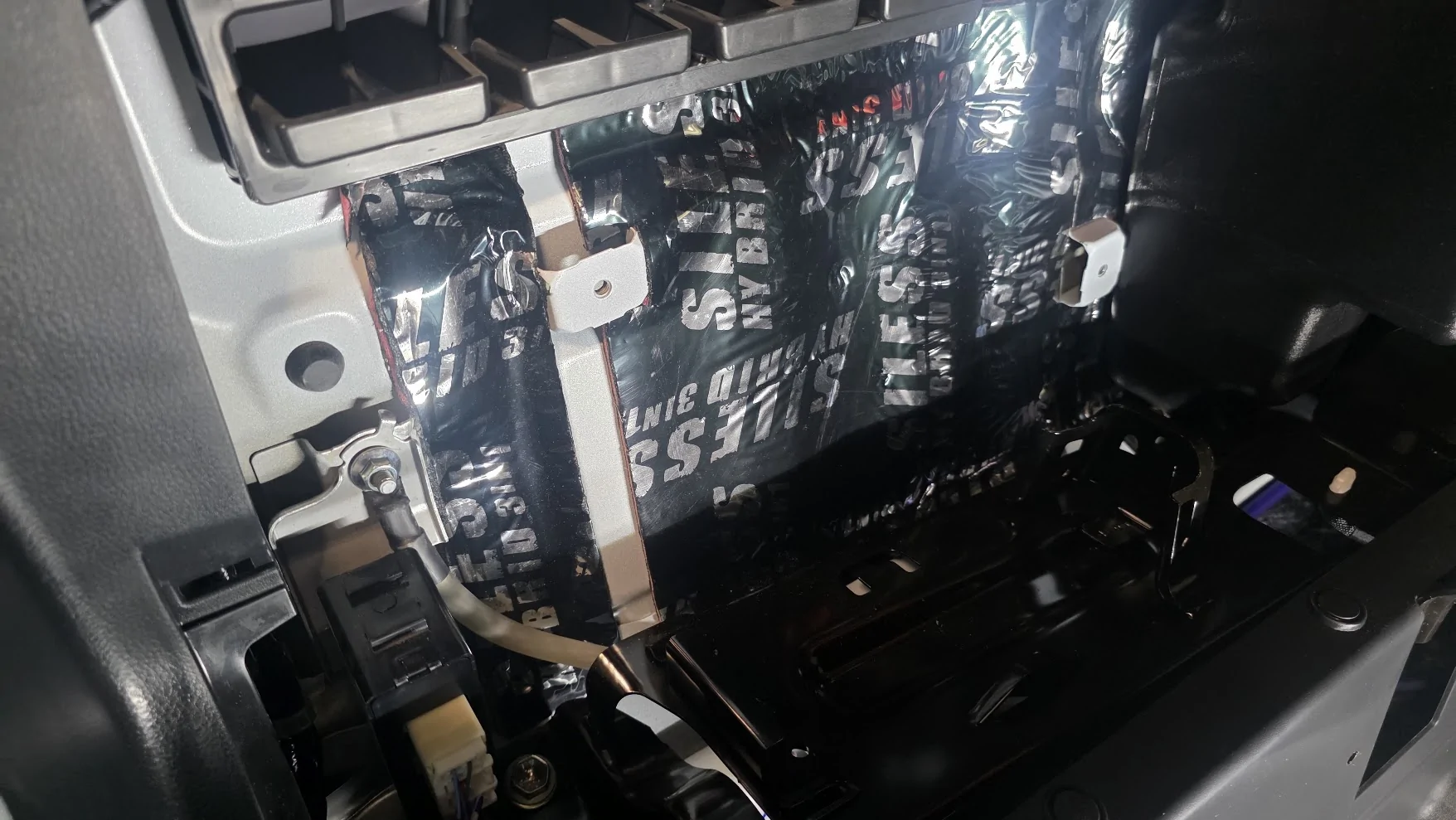

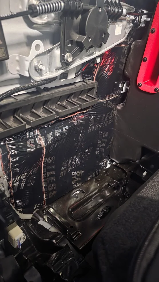

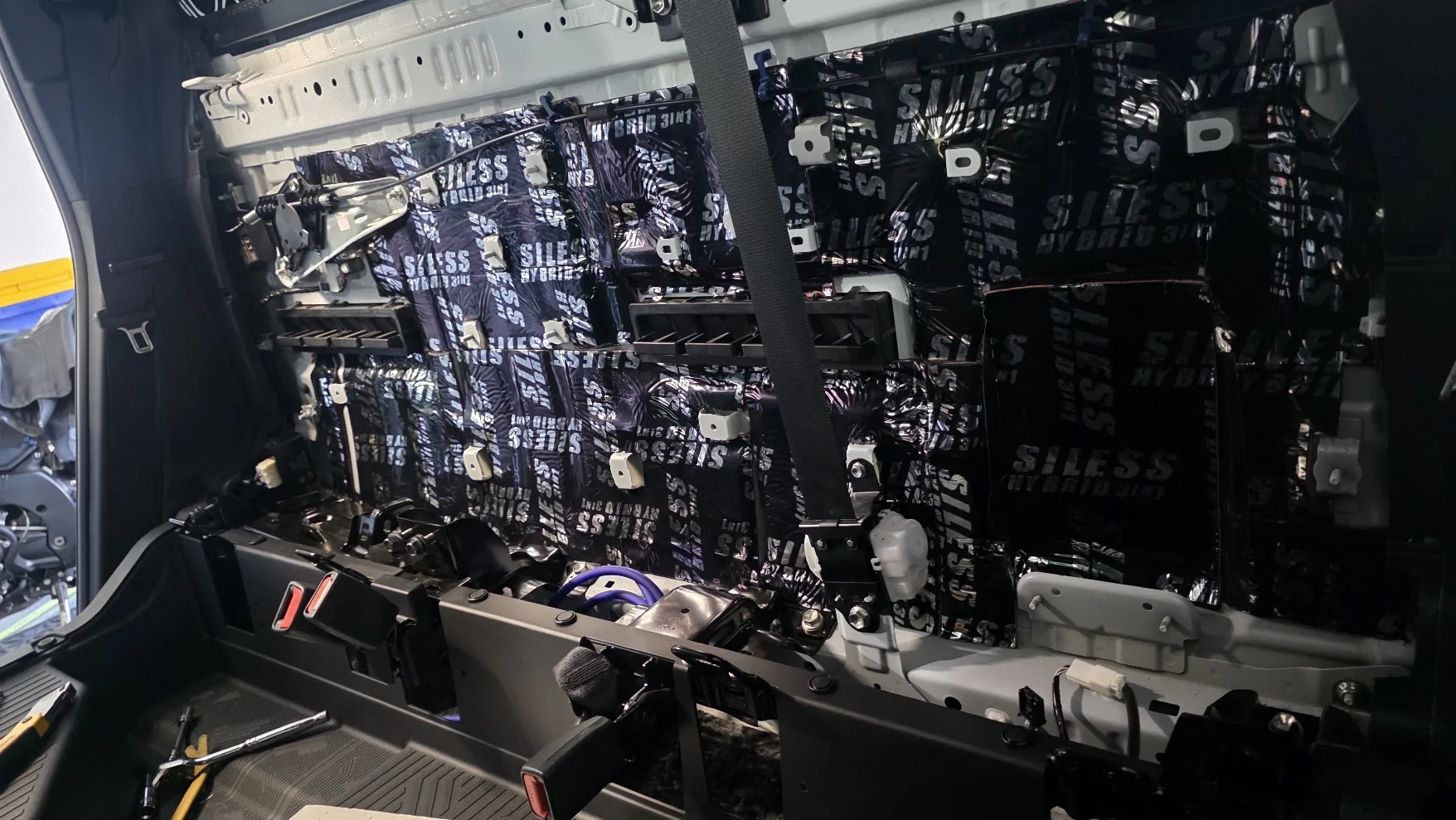

Did some additional deadening when adding the behind the seat sub. Had to block off the factory subs vent as well, used a thick sheet of plastic.

The Dude
Richard
Feb 12, 2024
166
108
Calgary, Canada
ā€˜25 SS Red Sport Prem. ā€˜99 4Runner
I’ve been reading, and you said ā€œblock off the factory sub’s portā€, and I was like ā€œwait……what?!?ā€. Then I saw the last pic, well done sir.
