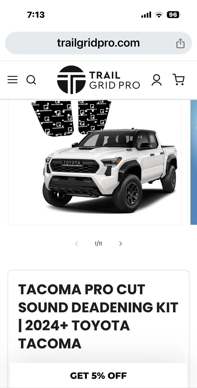

I get a little buzz from the passenger door panel with the music turned up. Now I do sound deaden most of my vehicles but in this case the buzz is from the plastic panels joining together. I buy a box of sound deadener and a roll of 157mil dampening mat. I install a couple pieces on the door skin, most specifically behind the speaker. It doesnt take much to get rid of the ring, and it improves the sound from the speakers. That kit above almost looks like they want you to install it on the inner door skin, which I cant see a benefit from.

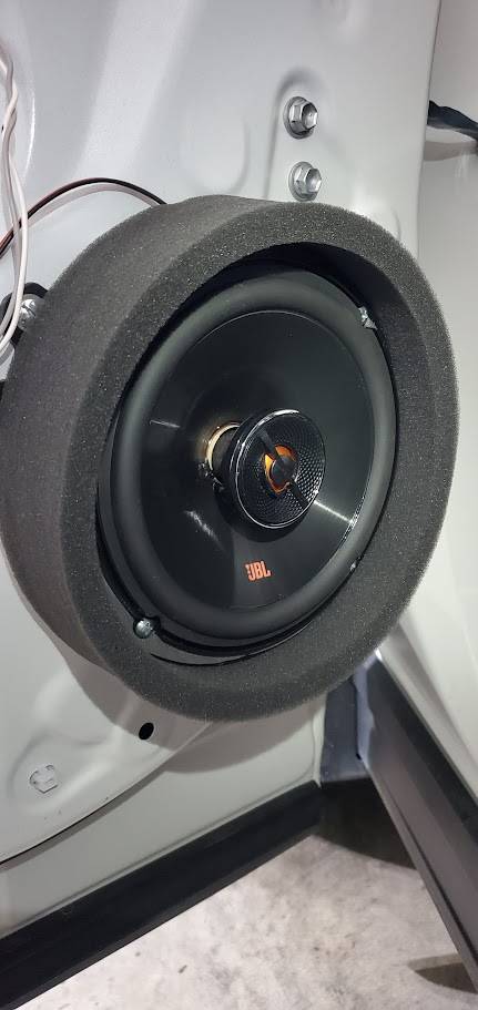

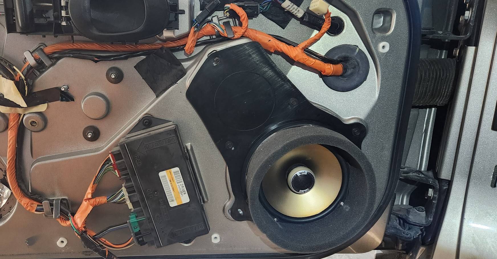

A little off topic, but these foam rings around your speakers seem to help with midbass, overall getting the sound directed out of the door panel. Probably a slight improvement to rattles etc. Have a pic of them on the rav and the vette here:
2024 Tacoma Sound Deadening Kit Effectiveness speaker ring 2

@Drifte Nice job.
That is something I need to add to my list before doing any mods on my sound system.
