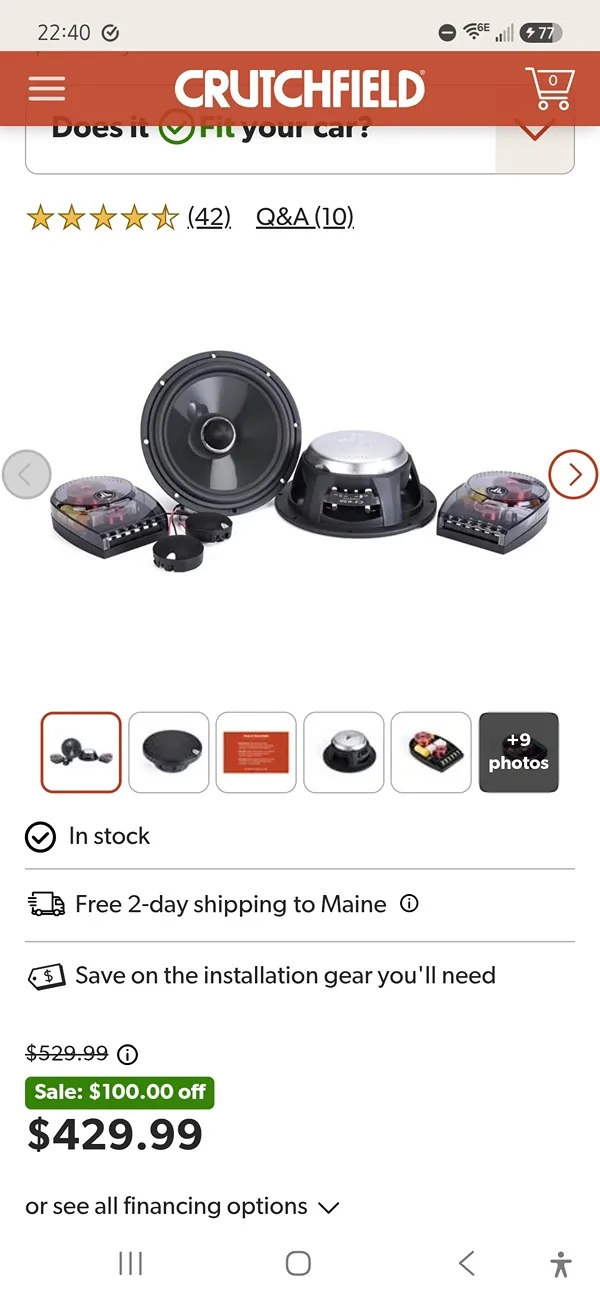

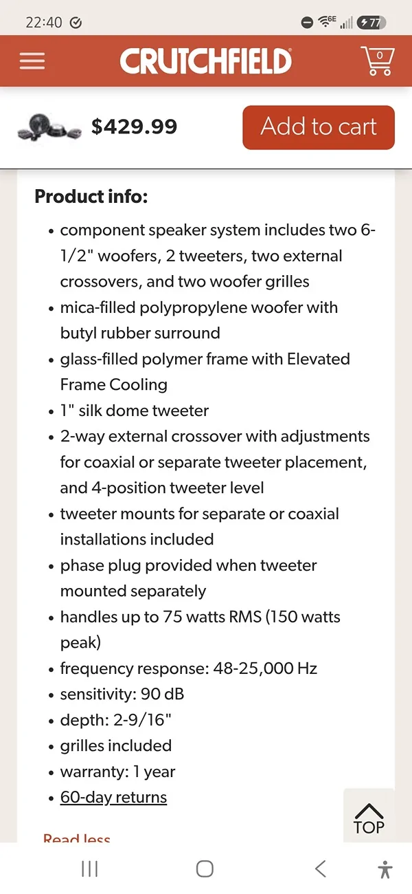

I pulled the trigger and bought this today.
Surprised you went with 6.5" speakers - 6x9 and 8" speakers are a direct drop-in to the stock door panel. More bass with the added benefit of more sensitivity (louder with less amplifier power). Where are you going to put the tweeters? You could get JBL a-pillars that have the tweeter grille.
How will you integrate the dash speakers into this setup? Still keep them wired in parallel?

I bought this as a package from Crutchfield. It was already assembled for the '26 Taco TRD Sport. They recommended the speaker set up.
The tweeters will go in the current dash locations. The only thing I didn’t do was to get the sound insulation for the doors. I thing while I have the doors apart, I will use some duct tape to seal all of the openings in the door. I don’t play music loud, so I should be ok with this package. I just like to be able to hear the bass guitar, and the cymbals sharply.
Definitely do not use duct tape on the doors man. Get some actual butyl sound deadening. Hopefully the tweeters come with adapter plates, because they will not just drop in to the dash speaker locations. Also, where do you plan to mount the crossovers? I guess wire it into the dash speaker and run new wires from the crossover into the door? You’ll need to run new wires anyway you do it unfortunately unless you want to cut and splice factory wires.

If you want to seal up big holes on the door, you have to use something rigid like MDF, ABS, HDPE, etc. and straight up bolt that to the door - otherwise you are basically creating a passive radiator enclosure for the speakers with a completely unknown tuning frequency. Duct tape is not solid at all and will vibrate and flex just like a speaker would when you play music. You don't see speaker cabinets made out of flexible materials for this very reason.
Generally, car speakers are intended for free-air/open baffle use because car doors are not completely sealed (unless you are talking about competition level audio builds). You will be fine to leave the large holes open, as covering them with duct tape will likely result in a worse sound. Definitely use butyl sound deadening on the outer door skin to help tone down extra vibration.
I fear that you will be disappointed in this speaker change. You're switching from a high sensitivity, low wattage 7" woofer and 3.5" midrange to a lower sensitivity, higher wattage 6.5" woofer and a tweeter. It will not be as loud as the factory setup, it will have less bass, and you will probably have shrill/screeching highs because the tweeter will be firing upwards directly into the windshield and reflecting very high frequencies all around the cab. You also won't be able to make any meaningful adjustments because you don't have a digital signal processing unit (DSP).
People fall into this rabbit hole all the time and the fact of the matter is you need a DSP and an amplifier if you want to change out your speakers and actually make a positive difference. The factory sound system is tuned for the factory speakers - changing that up will result in a sound that is 99% more likely to sound WORSE - UNLESS you get a DSP to correct the signal and an amplifier to send those new speakers the power they need, you will be disappointed.
