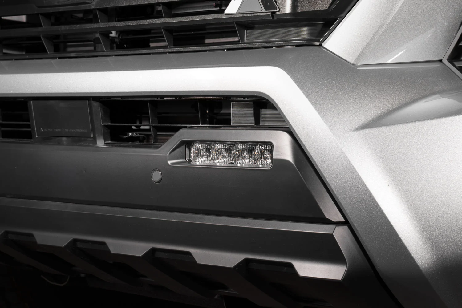

Thanks for the video! Can you post some pictures of the SS6 fogs installed but turned off? I'd like to see how well they fit into the bumper openings. All the photos/videos I've seen have the fogs turned on or the backlights on so it's hard to tell just how well they fit.

I can gladly grab some additional images on my truck, but here is one captured by our media team that might not have made it onto the website. They're a perfect fit, quite literally!

Thank you! It looks like they fill up the bumper openings nicely.
