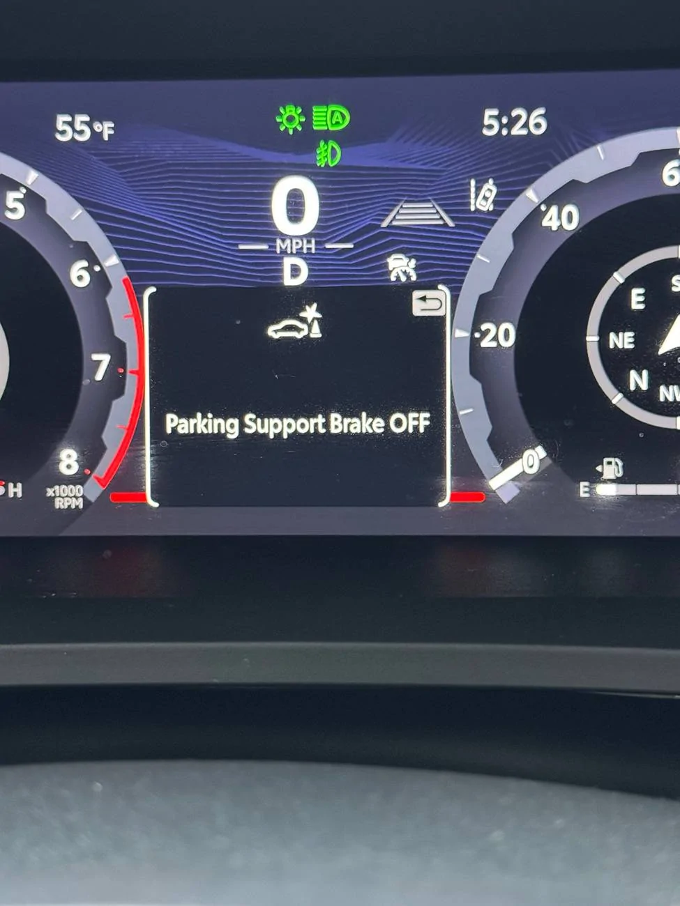

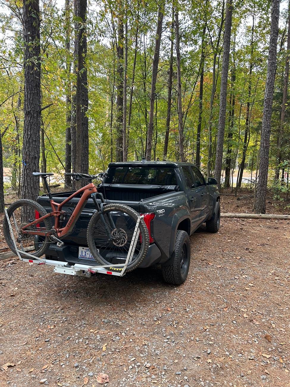

24 TRD OR Premium… have had the truck for a couple of weeks and loaded up for a gravel race yesterday with a couple of buddies, excited to show off my new taco. Problem was, we couldn’t back out of the driveway. Spent several minutes fumbling around the menus/settings and looking for a button to turn off the sensors, and finally just backed up very, very slow. Happened again at the gas station.
Someone on another forum said to press the “Tow/Haul” button when something is in the hitch and it will disable the sensors. That didn’t work either. Sat in the driveway today and went thru the MID display and it seems like the ”PSKD” or Parking Support Brake is what turns off that setting. I was hoping for a quick button on the dash such as selecting Tow/Haul, but no dice.
I’m going to go thru the manual but, surely someone else has had to deal with this also. Post up if you know what’s up.

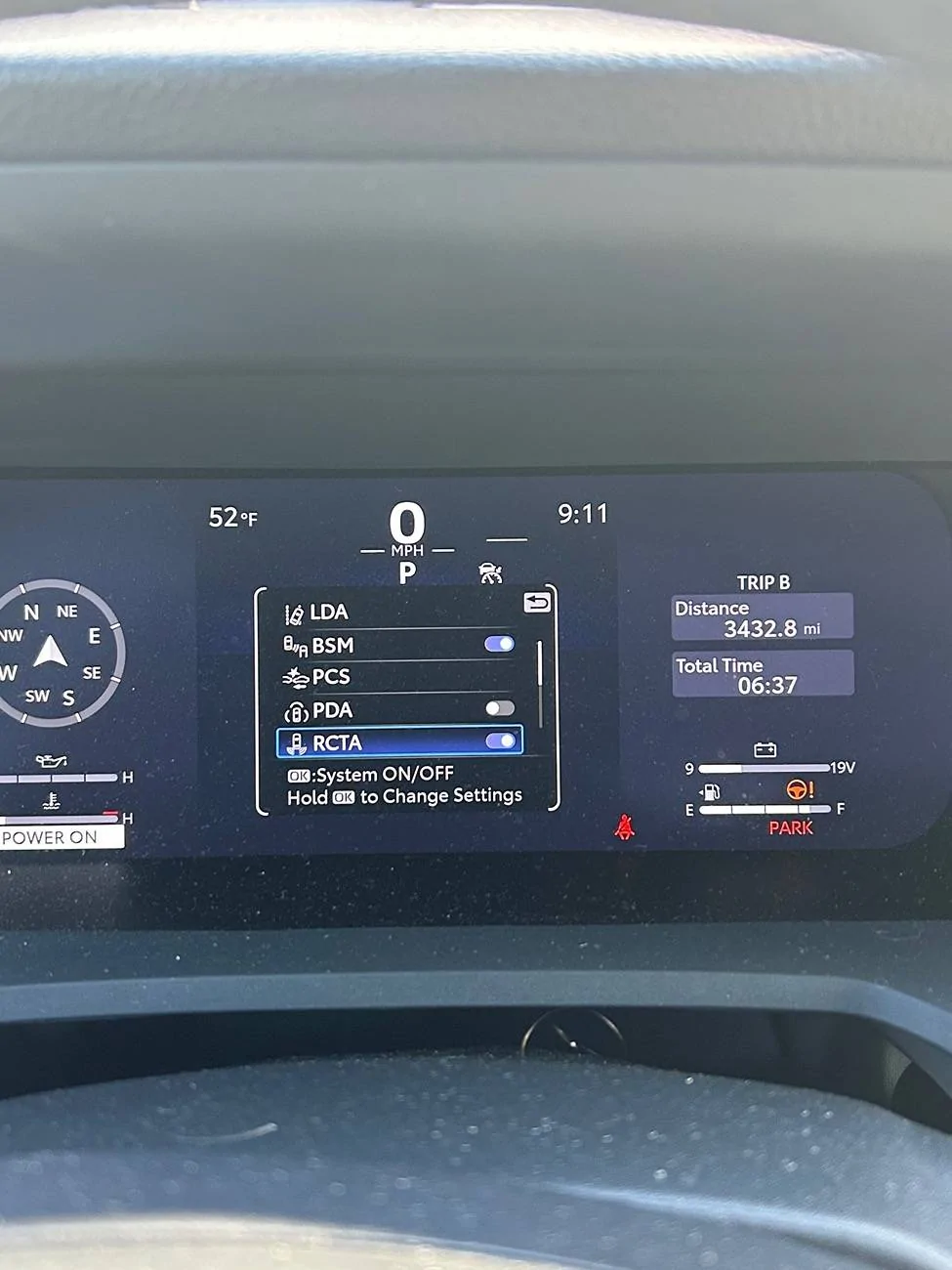

Shut off the parking sensors in the MID. I can’t remember exactly but there’s 2 that need shut off.

That doesn't read right. The manual and a Google search should get it for you. If you turn off PKSB you'll still get the audio warning easy to turn off with a screen tap but won't have the brakes slam on.
Early on I did not like that setup opposed to my wife's German car having a center console button for instant bypass but with use and time think it is okay or better because there's no need to keep pushing the bypass button like my wife's car. For example, it stays on while rack is on.

I have a single tray 1up rack and have never had any issues with or without a bike on it. I've never turned ON or OFF any sensors either.

1 or 2 trays, I have to disable the PKSB. Anything but a super slow backwards crawl slams on the brakes.

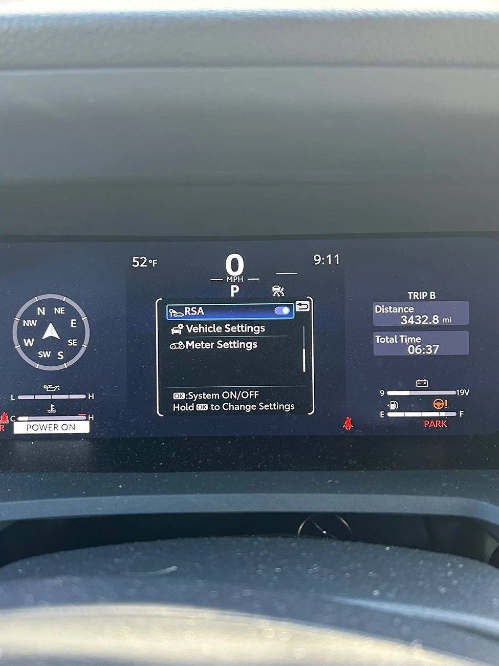

I just looked through my menus and I don't see PKSD anywhere. I have a non premium TRD Sport.
its part of the 3.0 safety sense you should have it under settings, press and hold

Nope, that’s correct. It must be a part of the towing tech or premium package with all of the cameras.

@bitflogger @Burgi did you have to get a different hitch pin from 1up to accommodate the wider receiver on the 2024 tacoma? Thanks
The 1Up doesn’t use… rather, isn’t secured to the receiver with a hitch pin. It uses either an 8 or 10mm safety torx, can’t remember which, to tighten down the internal mechanism which forces a large ball bearing against the inside of the receiver. This creates enough tension and friction to keep the rack from sliding out.
