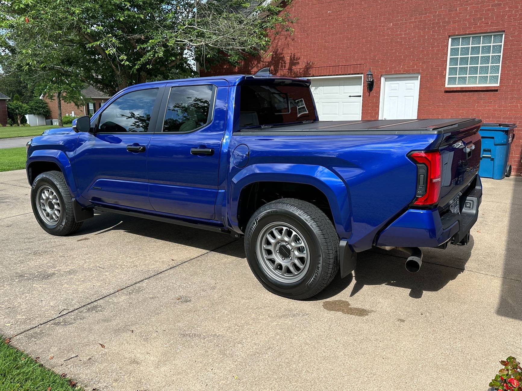

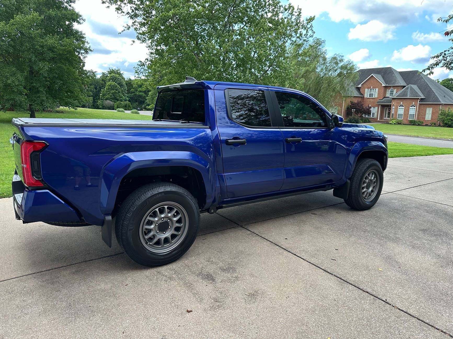

Long time lurker, first time poster. I just happened on to this thread and thought I would throw out my Limited on here, the good bad and ugly.
Here is a list of my chrome-delete mods in order I did them. I still have the chrome upper grille, but it is the last piece of chrome on the truck (pics were taken prior to replacing the lug nuts with black ones). I am still debating what I want to do with the upper grille, not really wanting to take the entire front of the truck apart to put a replacement on. Also so far everything I have done can be undone so I rather not spray it with rattle can.
The black badges were already on the truck from the dealer.
OEM Painted Mirror covers
Hard Tri-Fold Bed Cover
Hood Struts
Rough Country 2pc Skid Plate, removed front air dam
Raceline Rouge +35 Wheels in Titanium (seems like most do black wheels so I wanted different)
Michelin Defender LTX M/S2 Tires
Black replacement Raceline center caps (Replaced Titanium originals)
Exterior Door handle covers in matte black
Plasti Dipped Black Tailgate Latch
WeatherTech Gray Floor Liners (I have the light gray interior)
Front Lower Bumper Cover Overlay

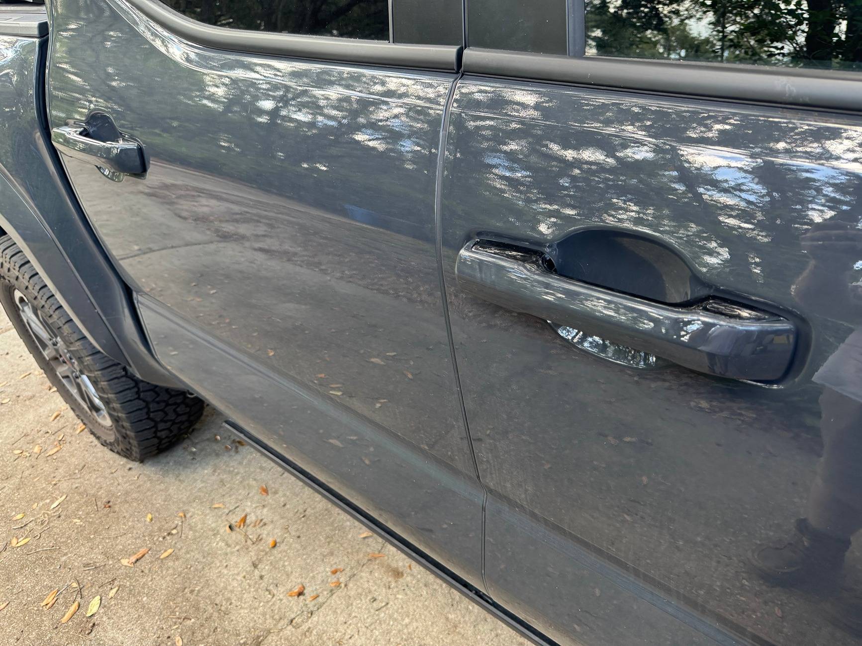

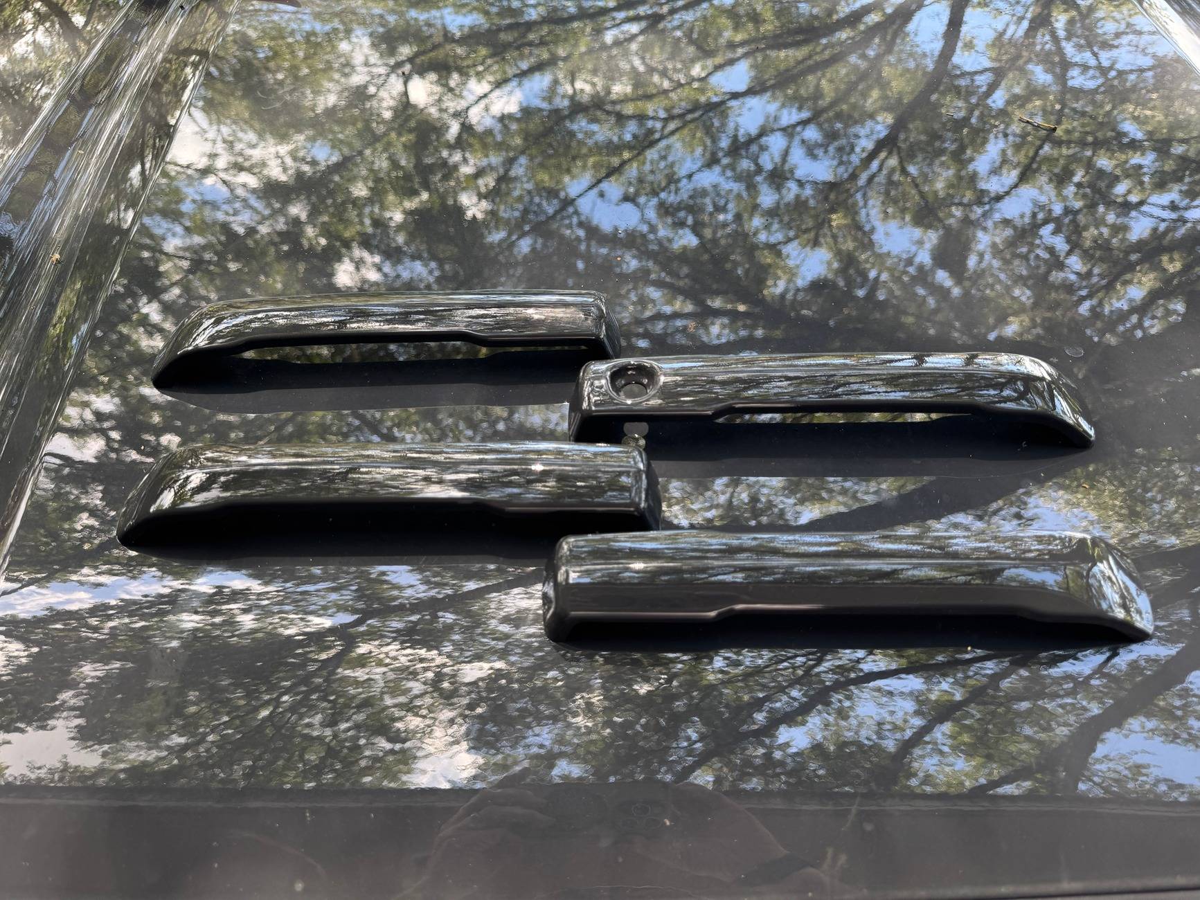

@Eesh29 here you go too
I didn't remove my chrome overlays, the Rave ones are designed to fit over them. the Rave ones are very thin, like a 1/16 inch or ~2mm thick. I know someone else in the thread said they removed the chrome, but I have no idea how you'd get the Rave ones to fit over the remaining door handle without them looking sloppy and not solid at all. Maybe they got different ones.
Here are some photos:
The best color comparison image I could get. They are a hair darker than factory, like there was enough primer to fully hide the black before being sprayed UG
chrome peeking out
installed
Video showing the ill fit a the front and back. There was double sided tape in those areas, but the fit is so poor they came loose.

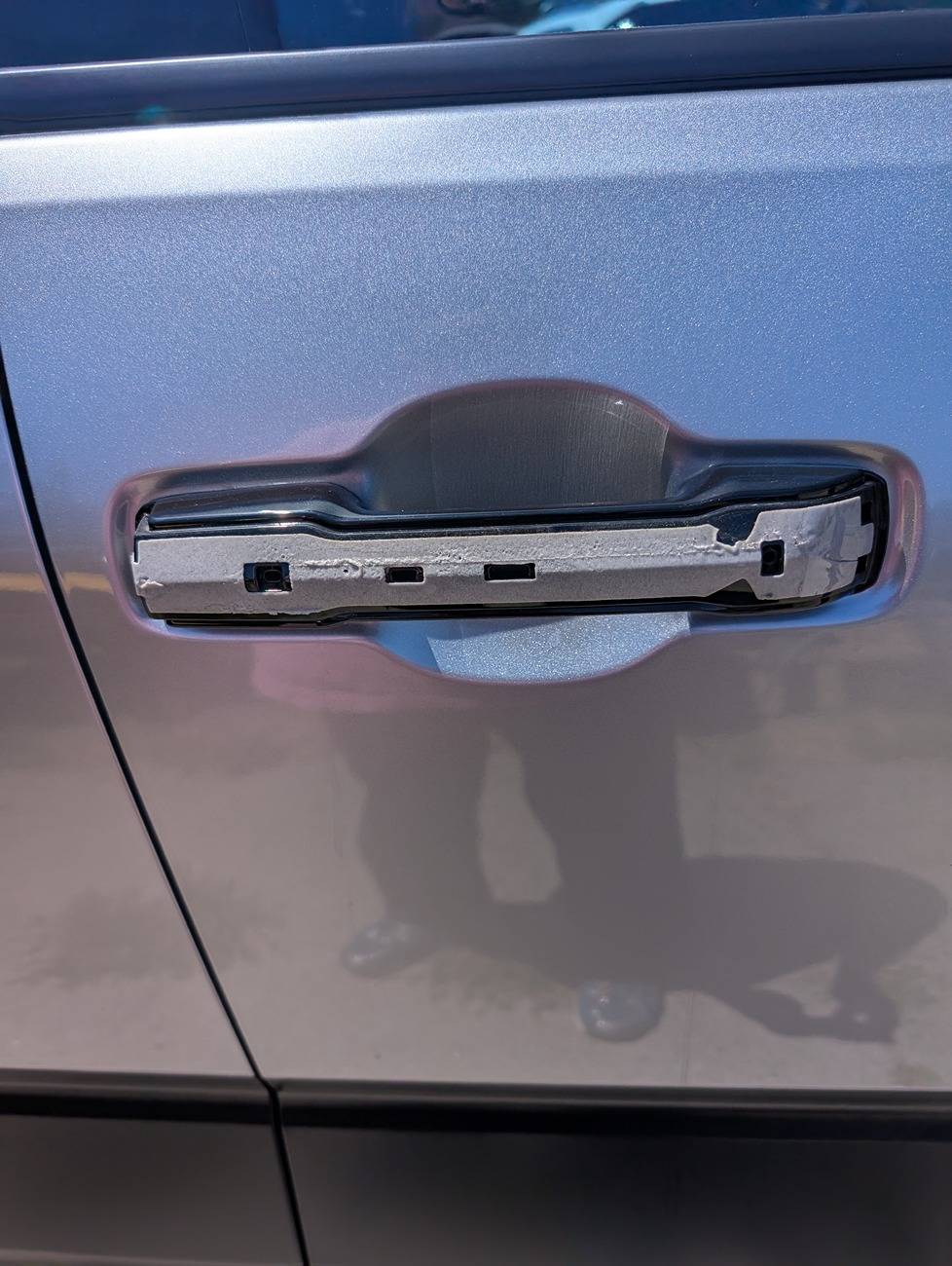

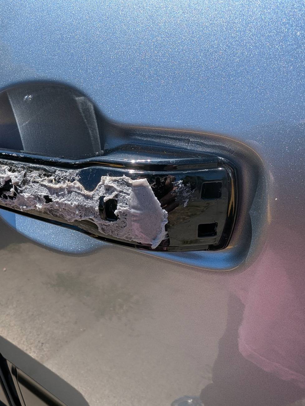

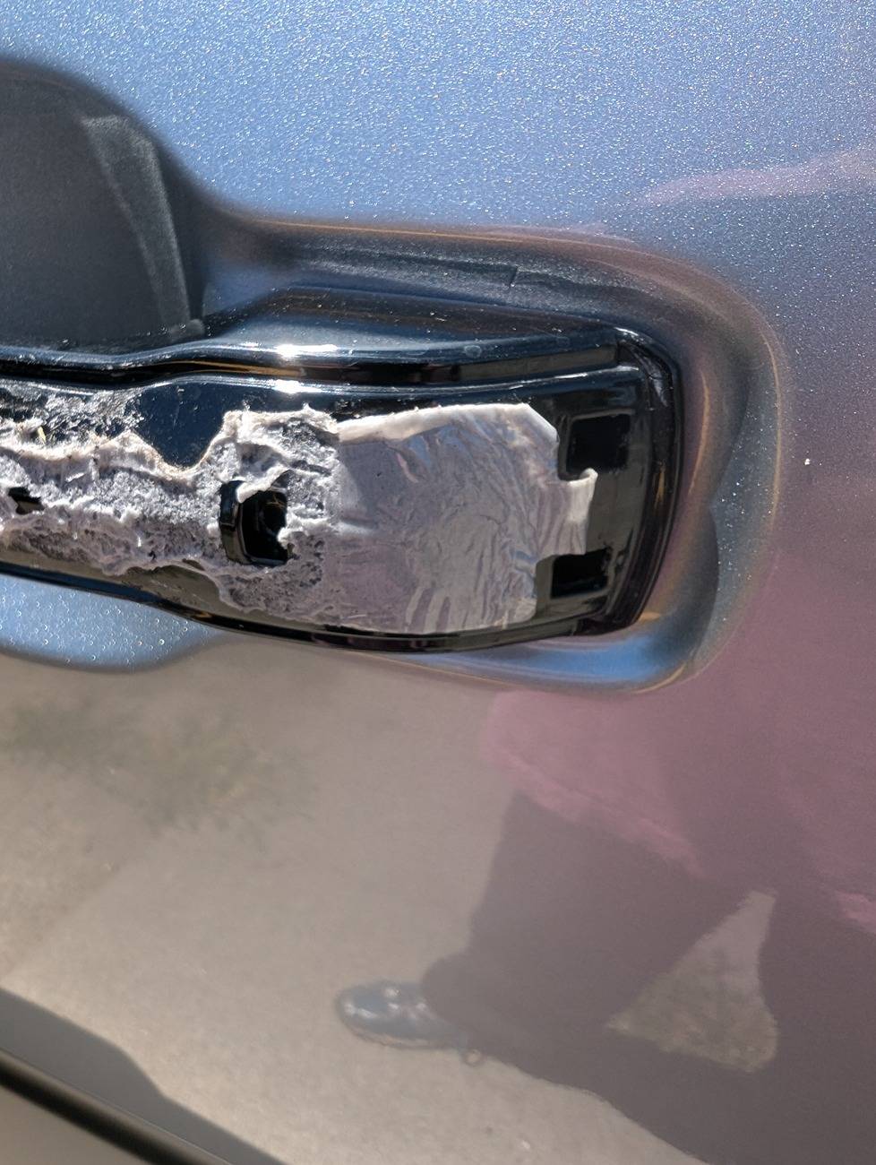

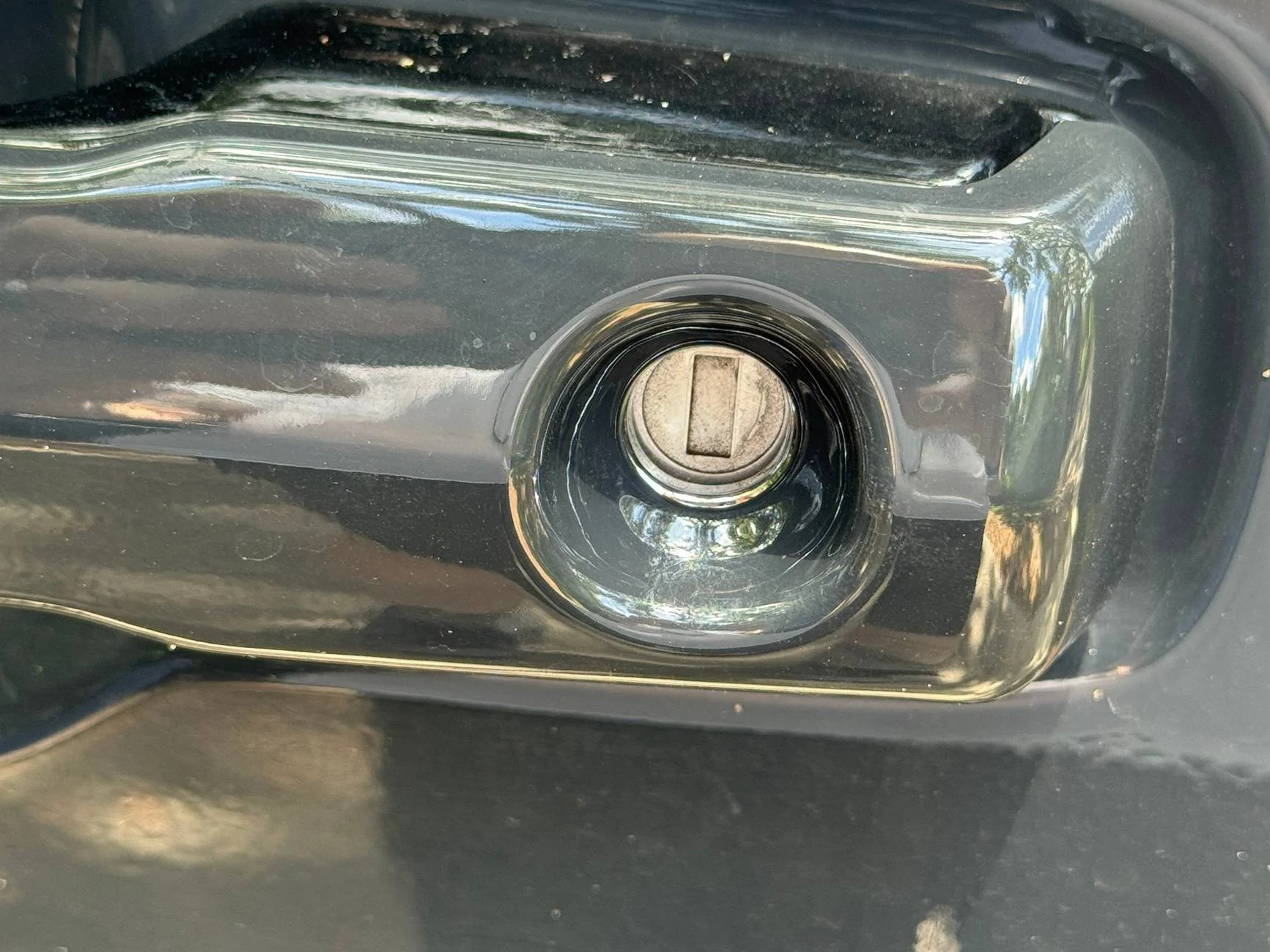

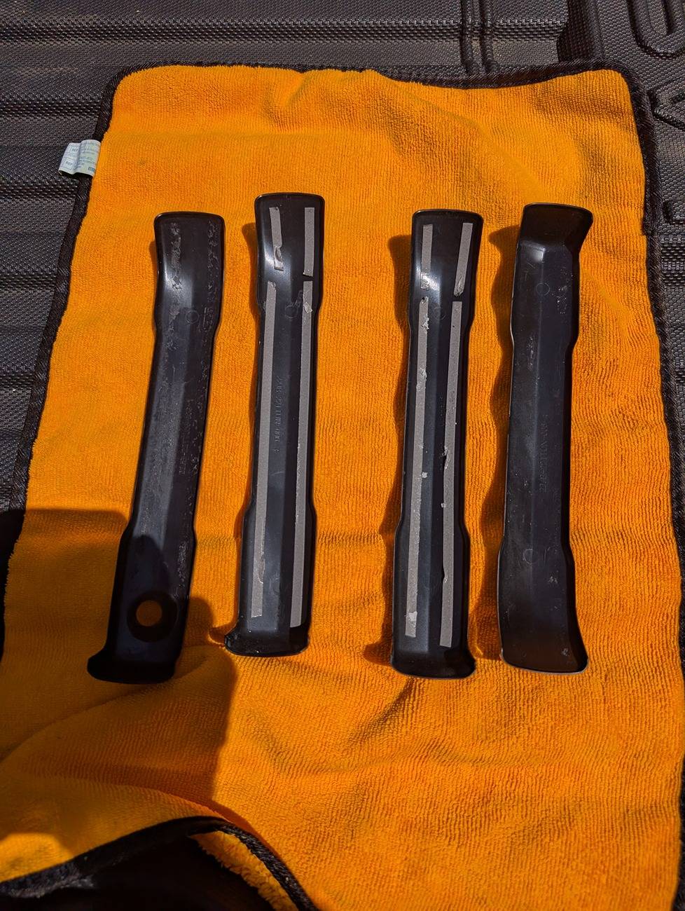

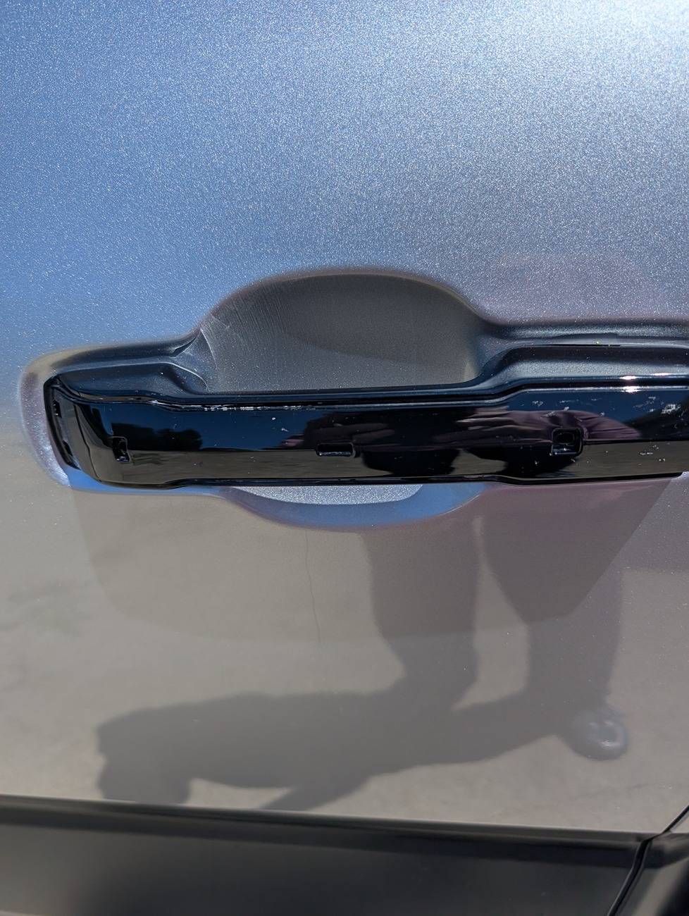

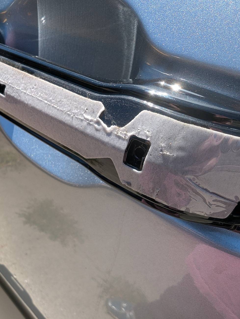

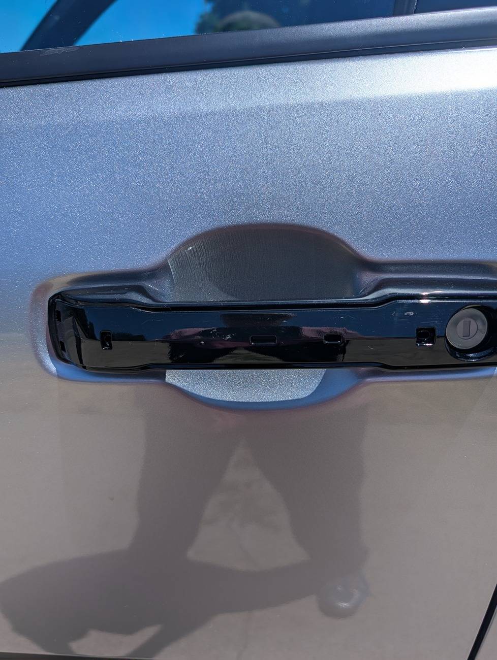

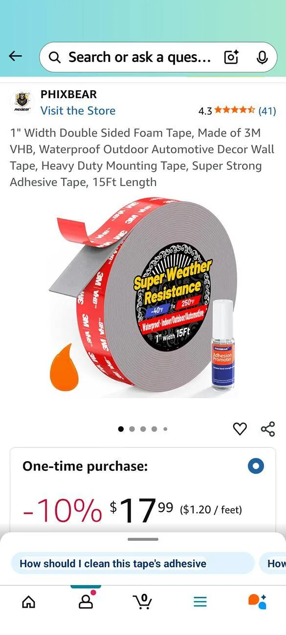

i am in the middle of redoing my covers
seems the stock adhesive has to b removed from the door handles

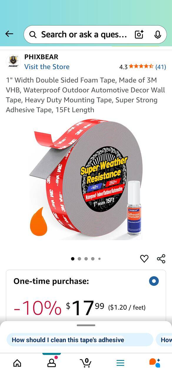

after some research that is 3M VHB adhesive tape dbb sided aircraft spec
as the adhesive strips that come on the Rave r not near enuff surface area & they dont stick very well at all to another VHB tape
i got this to redo my handle covers. It is 3M VBH 1" wide x 12'
will report back once done
OK here is some pix of the process so far
ALL of the old stock adhesive has to b removed ,best left out on sun & slowly peel of with my thumb nail rolling on to it self as like a wad of chewing gum

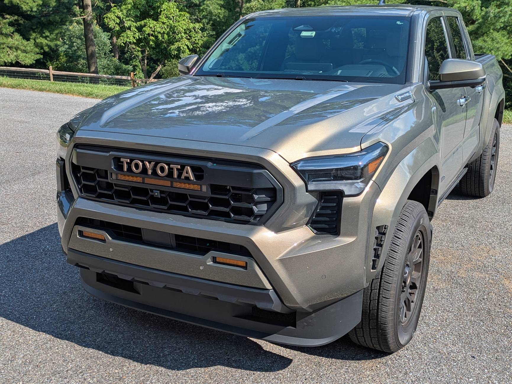

I'm leaving the handles and the i-force max badging. But I did do the tailgate letters to black and then switched out the mirror backs, grille, upper bumper, and wheels. Everything is OEM except the lightbar/fogs (Diode Dynamics). The upper bumper was a custom color match paint job +PPF so I don't have to constantly be fighting touch-up.
