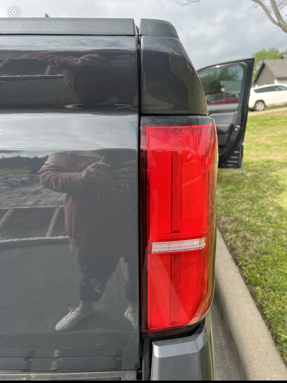

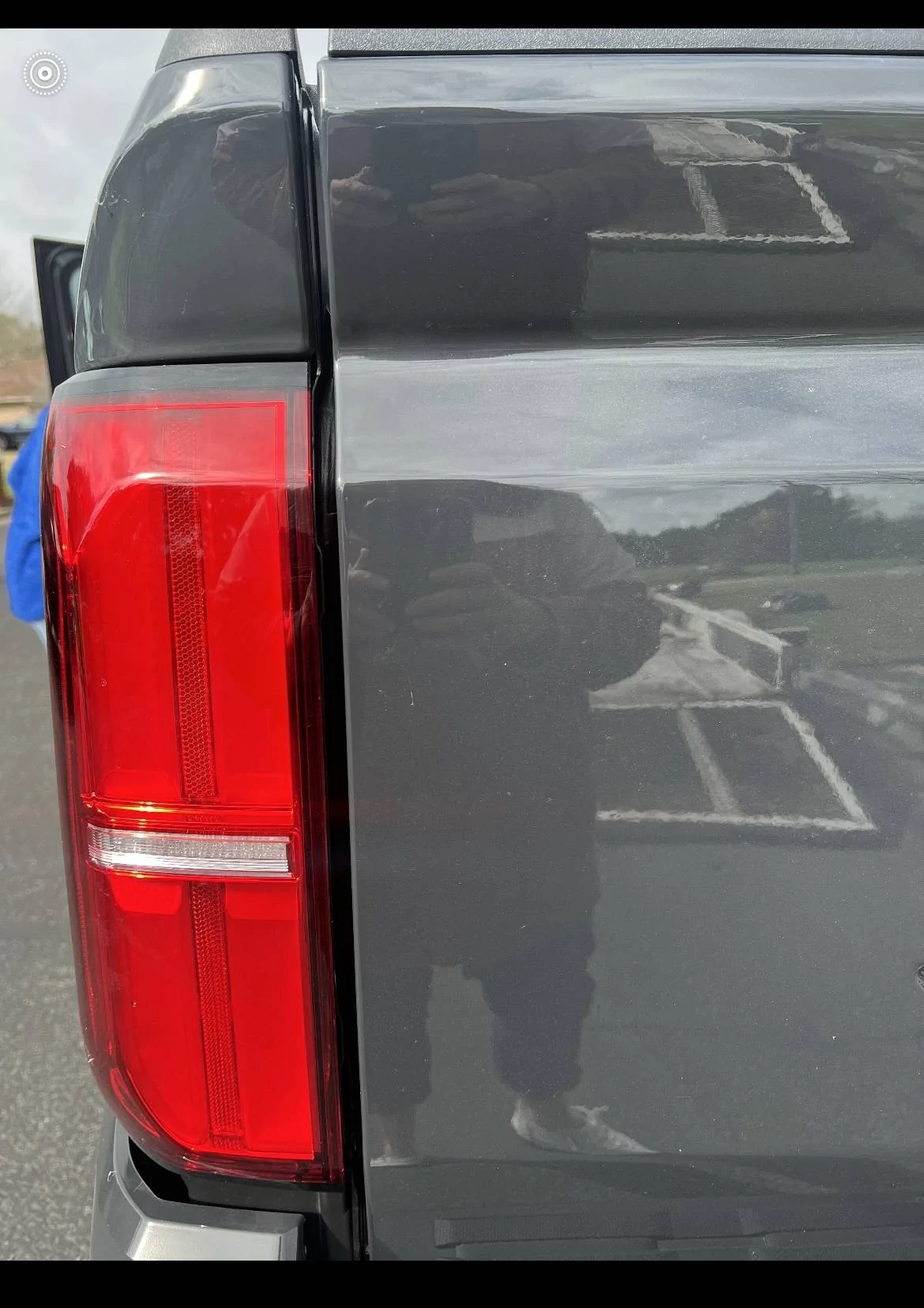

My truck has the wider gap on the left, but the tailgate also sticks out and is far from flush with rear fender.
First 2 pics right side, second 2 left.
I’ll mess with the latch. See if I can get it to be more snug on that one side.

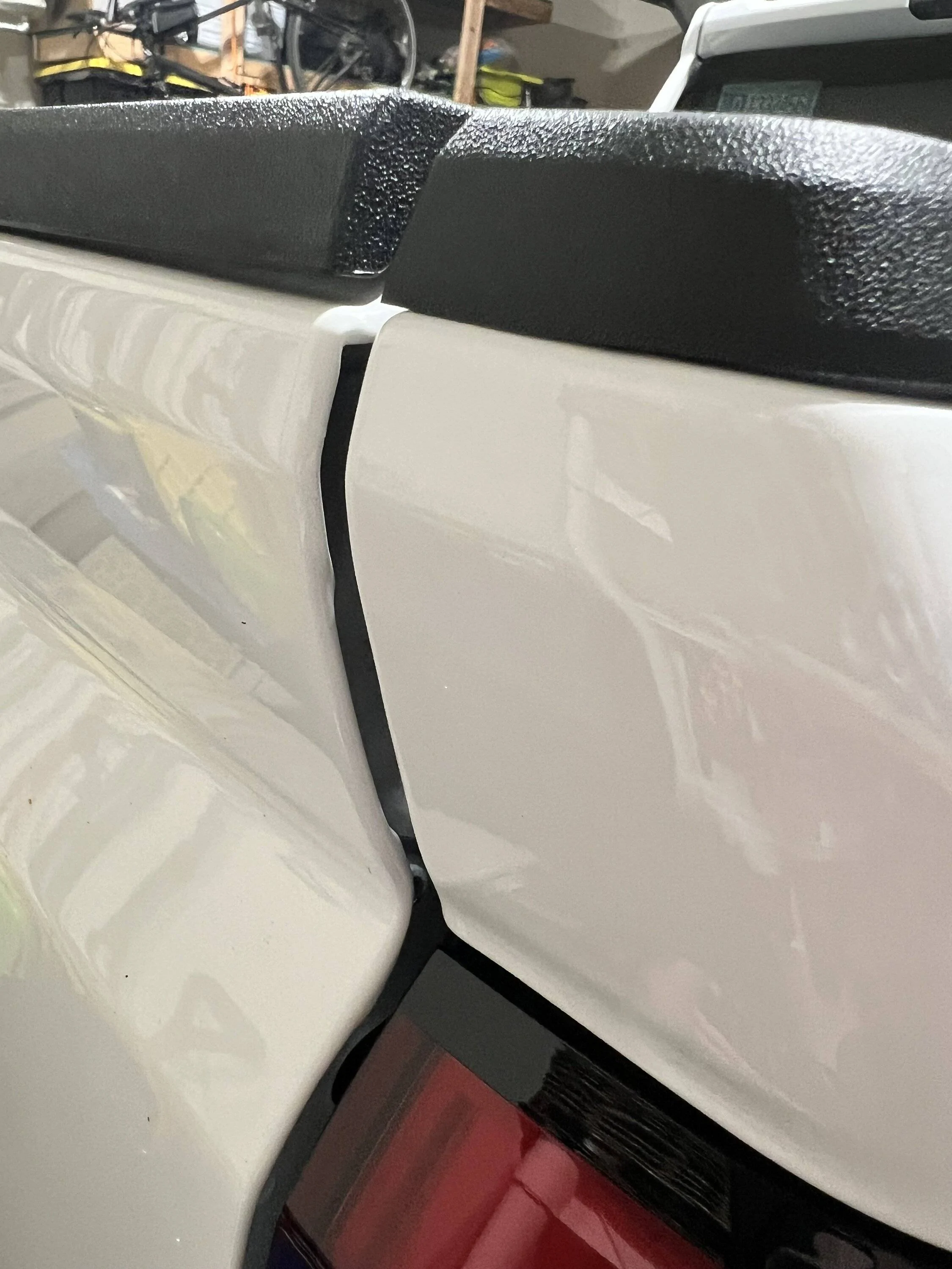

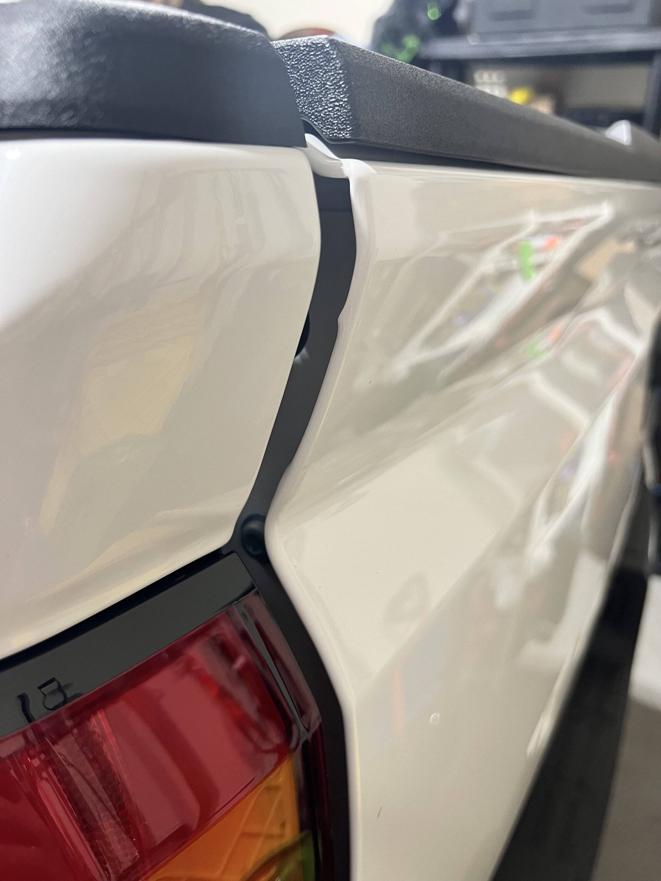

I have a 2024 Tacoma Limited. Had the issue with the power tailgate not closing all the way. Got that fixed. My other issue is the gap on the left side of our tailgate is bigger than the gap on the right side. Service department tells me this is how the 24 models are made. Anyone else notice if their tailgate is off like this? Pictures attached.
Jdavis, your pics look just like my Limited I picked up the other day…. Here is your fix, I did this last night and now it’s perfect!
Open your gate about 15 degrees, from the right side give the gate a good push to the left, instant fix!!

There is a quick fix for this, performed this on my 24 limited, open the gate about 15 degrees, from the right side give the gate a hard push to the left, there ya go!

Mine was the same way, you guys do realize you can push the tailgate over to the side you want to make the gap even? That’s all I did with mine now it’s lined up perfect
I just did this. It took 4 or 5 hard pushes but now the gap is even on both sides. Thanks!
