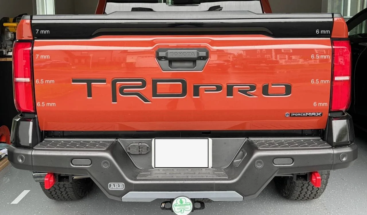

I measured my tailgate fit and it is better than I remembered and probably well within spec for a tailgate. I would still like to know if there is an adjustment procedure.
See attached image.

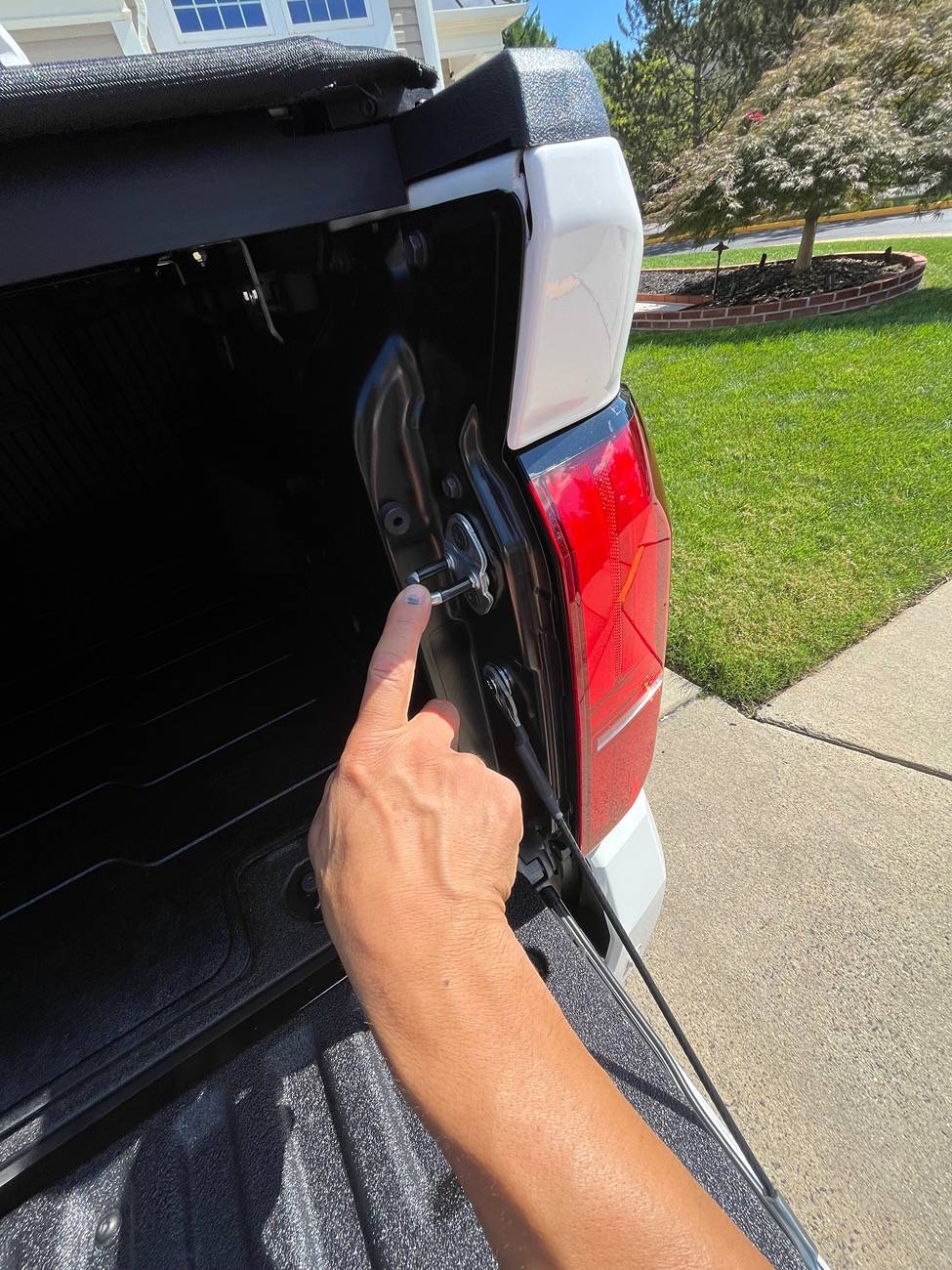

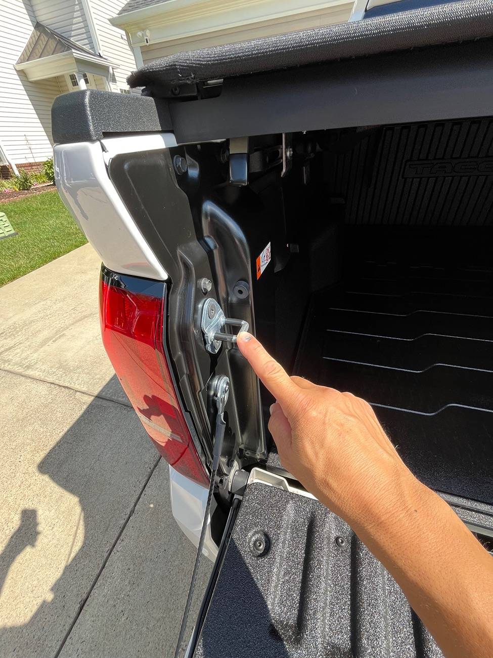

So apparently there is no Toyota solution to the tailgate from sliding left and right according to my dealer. Before I picked up my truck I literally went to at least 10 brand new trucks and shook the tailgates. 8-10 were loose! Then driving away I saw a few 3rd gen’s on the road and they were off centered as well. I may try to wrap some electrical tape on the upper left latch and see if that prevents it from pivoting.

So I decided to wrap the left and right bed latches with electrical tape. It seems to prevent the tailgate from shifting left/right. I intentionally hit speed bumps and jerked to wheel left/right to test and it didn’t move. I’m sure if you hit a big bump in the road or go 4 wheeling then it will move but otherwise it seems all good. Don’t over wrap it with electrical tape or else it will not unlatch itself if you have the power tailgate.

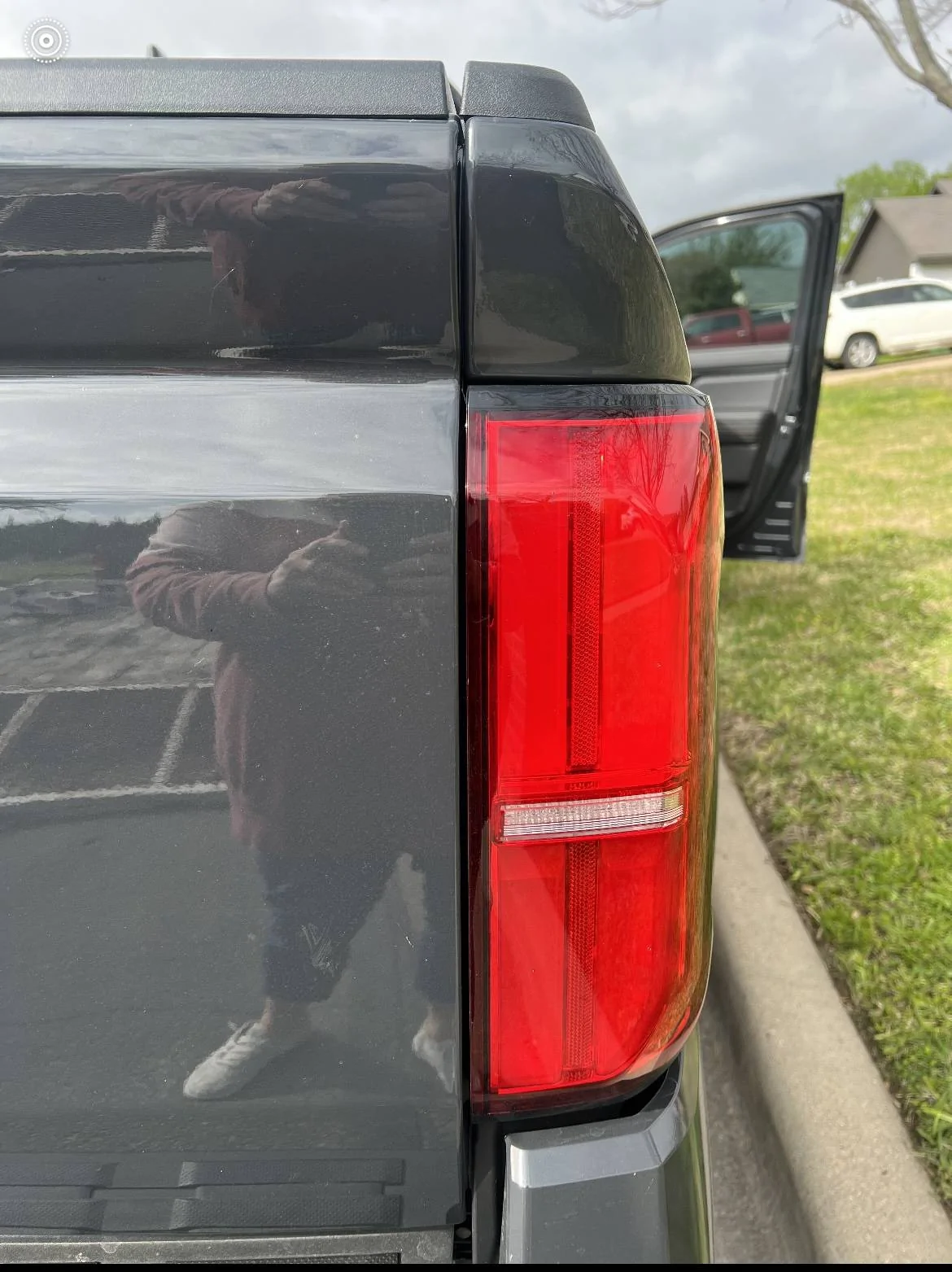

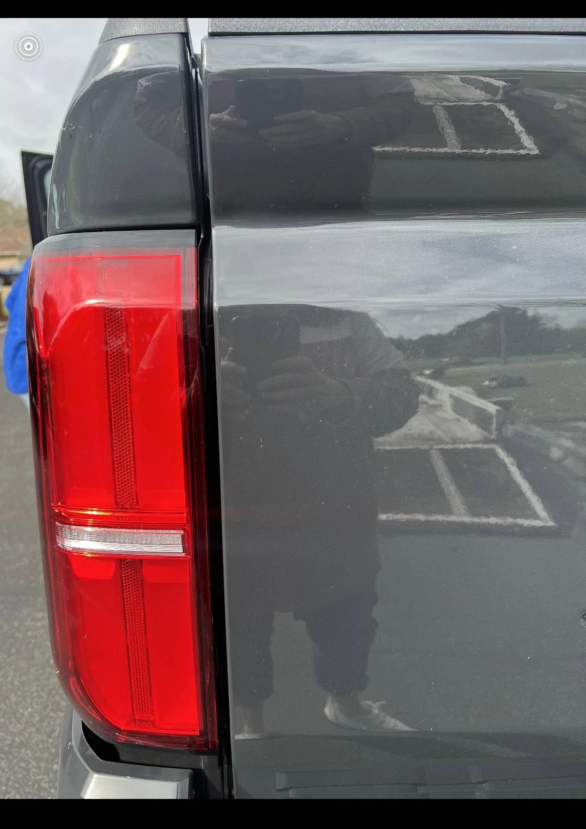

I have a 2024 Tacoma Limited. Had the issue with the power tailgate not closing all the way. Got that fixed. My other issue is the gap on the left side of our tailgate is bigger than the gap on the right side. Service department tells me this is how the 24 models are made. Anyone else notice if their tailgate is off like this? Pictures attached.

Same thing in my (non-power) 2024 Tacoma Offroad...and when you open it the left side latch makes a pop sound like it's under a stress. Not good at all.
