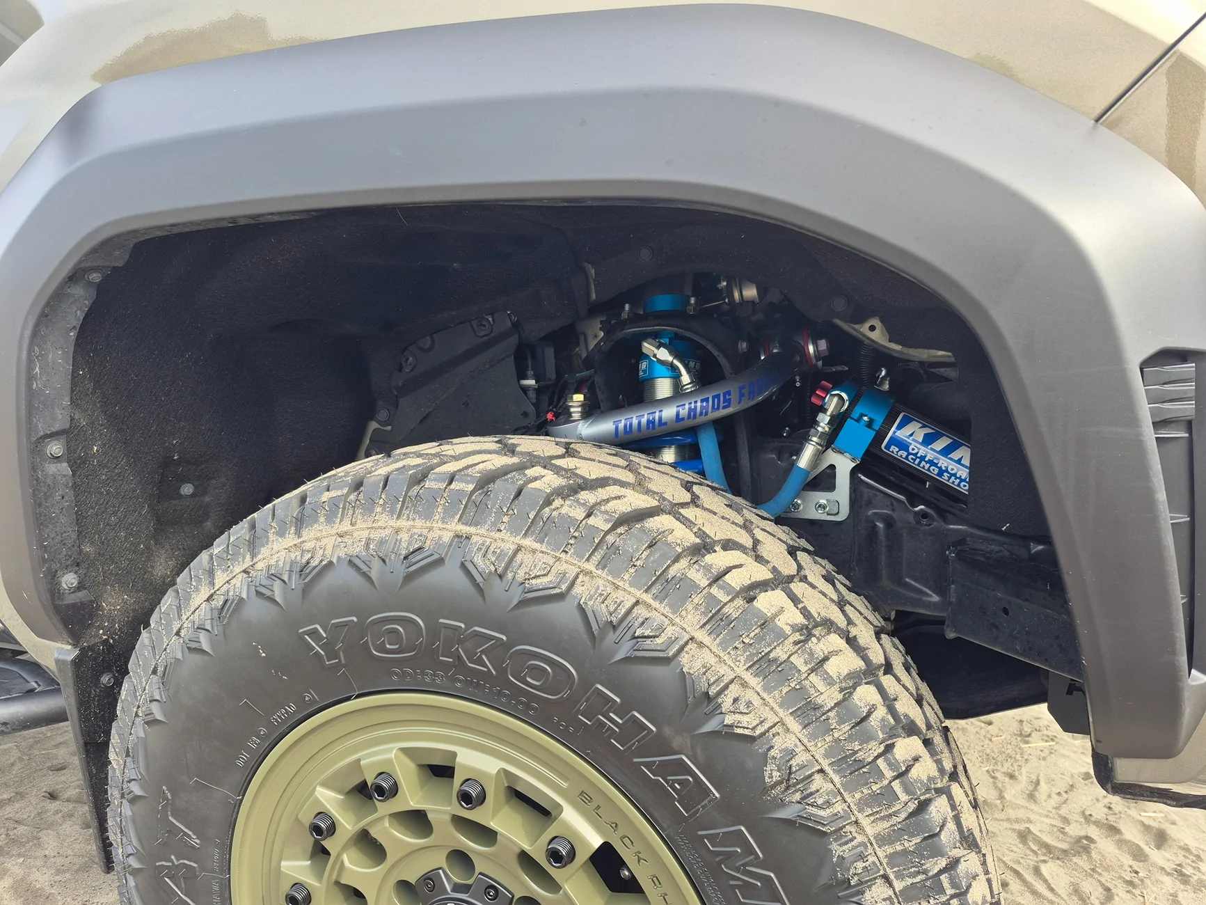

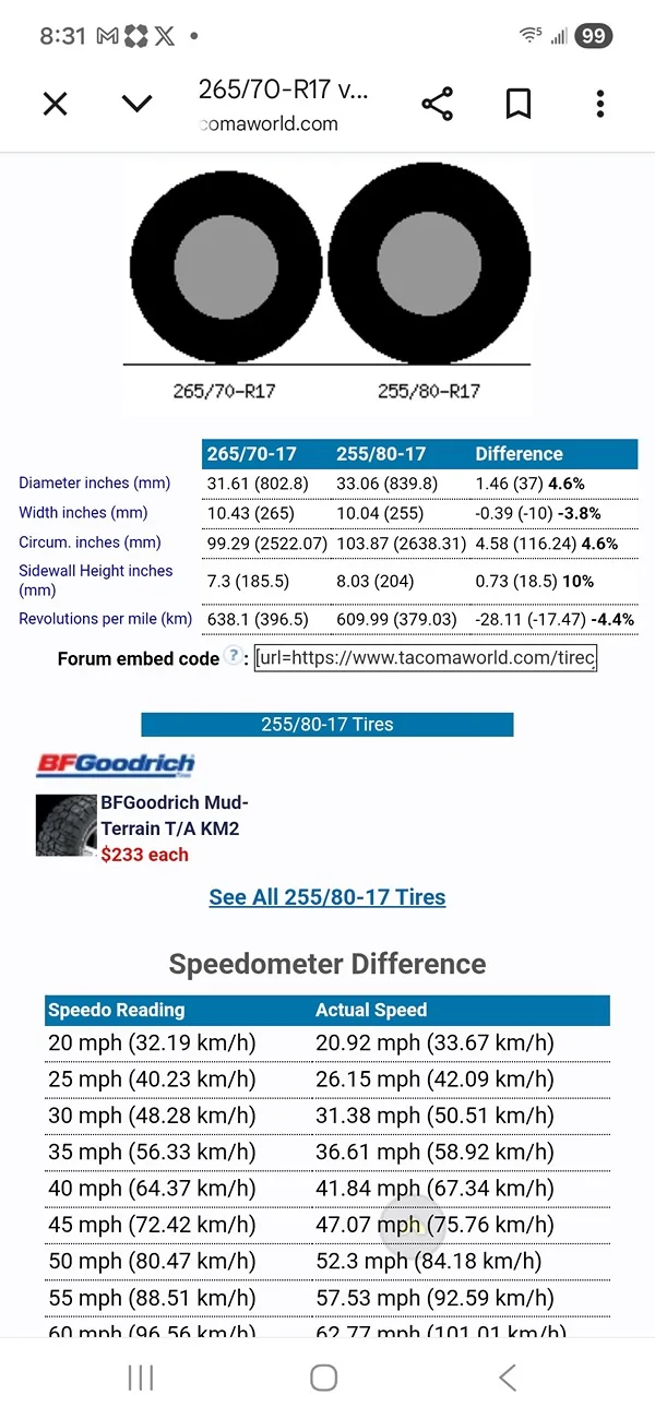

I run 255 80 17's, with +20 rims and 10 ply Yokohama Geolandar X-AT on my 24 Tacoma. They are roughly 1" 1/2" taller and 1/2" narrower than stock. Even at 25lbs heavier than stock set up I gained roughly 1 mile a gallon better mileage because there skinnier.
THIS IS THE LARGEST TIRE THAT WILL FIT IN THE SPARE TIRE SPACE!!!
Lastly, they will fit with 0 rubbing without a lift, I just hated the stock suspension once I started modifying it.
Hope this helps you.
2024 Tacoma Tall Skinny 255/80r17s Screenshot_20260507_083200_Chrom
2024 Tacoma Tall Skinny 255/80r17s 20250409_172223
