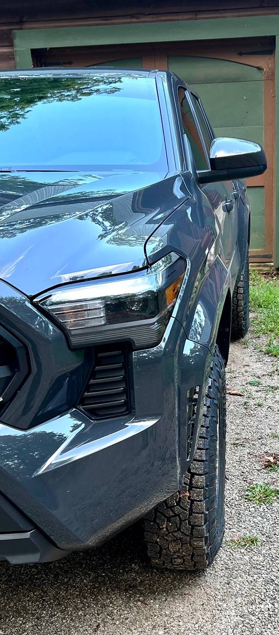

Stock SR5 4x4, has very little perceivable rake, I had this tire planned a ways before I got the truck, I’m surprised as popular as it was on the much narrower gen3 I’m the first I’ve seen to do this size on a gen4.
I just put Toyo AT3's 255 80 17's on
Confirming you didn't add spacers for 255/80/17s? Width almost looks same as stock in pics... Looks great, going to do same setup.
I did not add spacers

2024 Tacoma SR5
i was looking into this size after seeing your post. I went in today to test fit a 34/10.50 17. Should have them on by the end of the week.
Just confirming these fit without rubbing on a stock SR5 with no lift?
Also do you have a matching spare or are they too big to fit in the spare tire carrier?
Keen to get a bit more diff clearance for my stock SR5 extra cab and these look perfect.

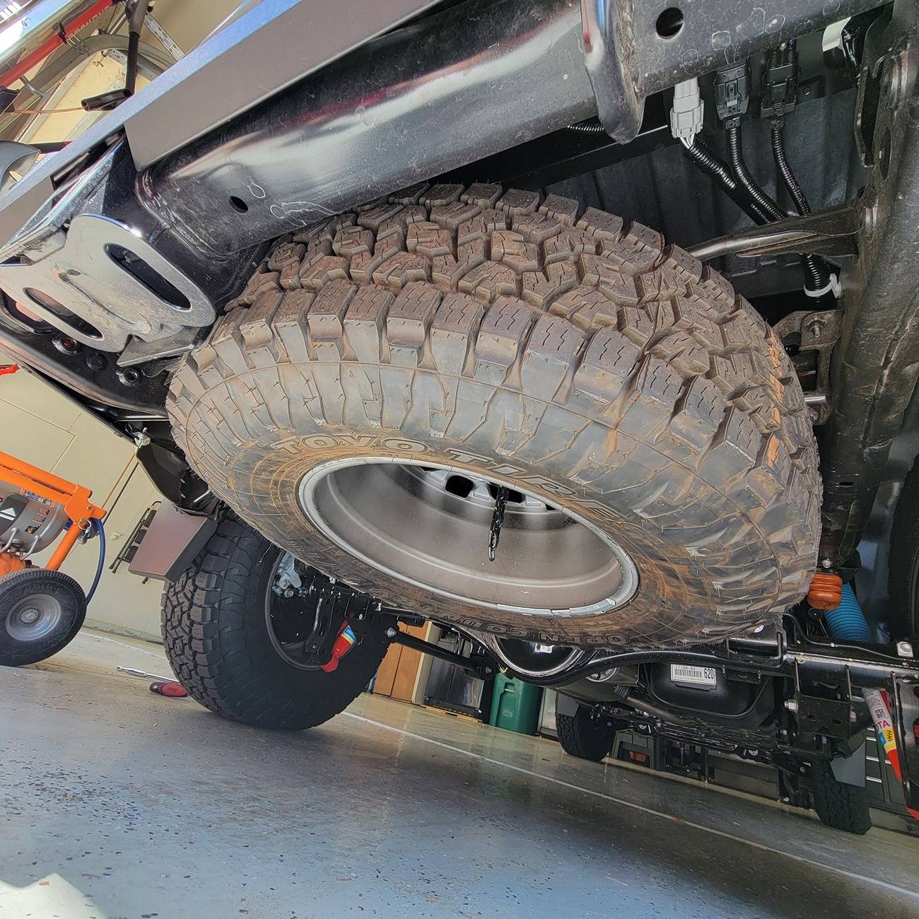

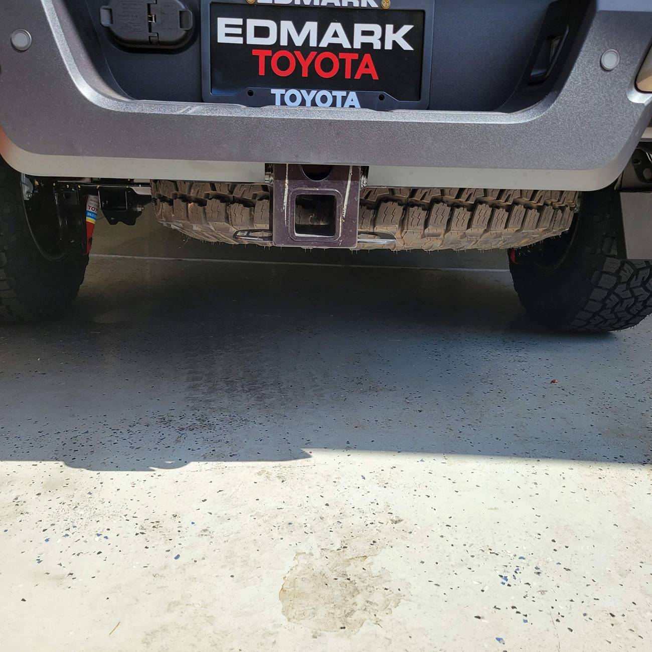

BTW, that also fits in the spare tire spot.
I know im late to the game here, but do you think there’s about another half inch of space still left for a spare? I’m considering 34x10.5 r17s (actually 33.5in in diameter) and want to have the same size tire in the spare location. Based on your pics, it looks pretty tight up against the hitch but hard to tell due to the angle. Thanks!
Romer
Ken
Mar 11, 2024
294
309
Centennial, CO
It is really tight right now. Possible, but wouldnt count on it
Good to know. I’ll likely just go with the same set up you’re running but was hoping to keep the width closer to a 265/70 tire. Appreciate it!
