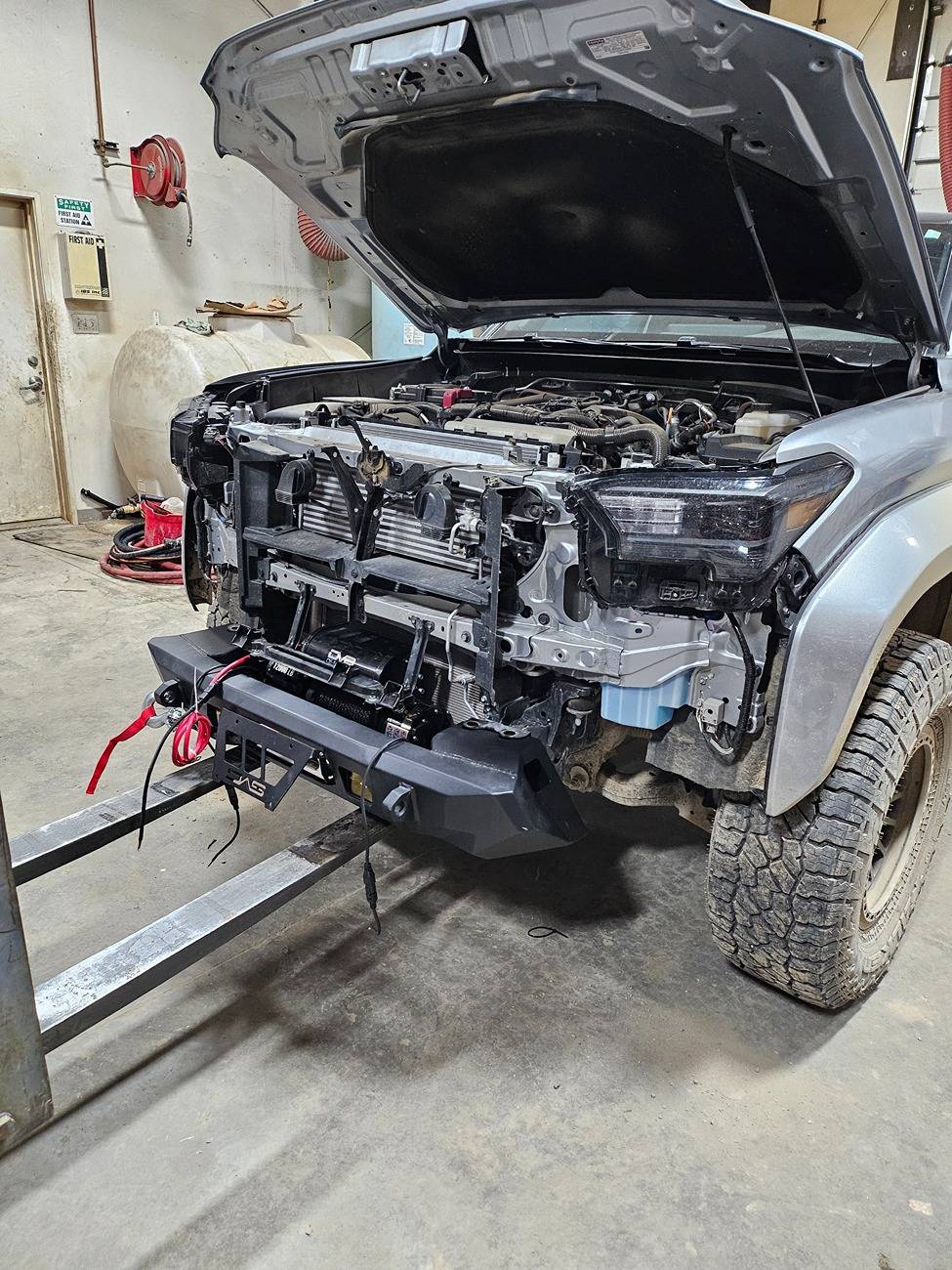

Looks amazing. Have you installed the front bumper yet? Did you have to readjust the front shocks for the additional weight? Have you had any problems with the safety systems and sensor with all these changes?
Front seems to be sitting a bit high so this might level it out. No safety/sensor issues. Those are in the upper area by fog lights so if you want to keep things simple these covert bumpers are the best choice.

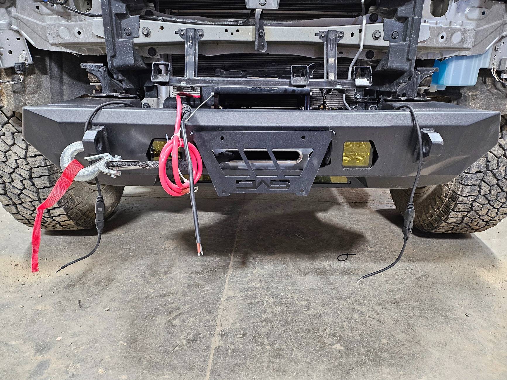

Finally got it installed. Took a bit longer than expected. Wired the lights into the auxiliary pigtails at the front.
Looks good. What winch are you running and more importantly (to me) how much clearance did you have on either side? I bought a Harbor Freight winch on sale to go with the CBI Super Stock Covert bumper but won't have the bumper for another month or so. The HF winch is 2 inches wider (23" vs 21") than the Warn VR EVO 10-S that most everyone seems to install to so I'm a bit nervous about the fit.

Since I got the DV8 bumper i thought getting their winch would be the best option. Got into the instructions and even they used a harbor freight winch that's much less money and looks higher quality. However It is 21" . Only potential issue is some hard lines on the sides of the winch and my bumper came with extra brackets in case that is an issue. There's alot of room and you shouldn't have a problem.

Thanks! That makes me feel better. I pulled down their instructions and you're right, looks like plenty of room.
Can you reach the freespool lever or are you stuck using the motor to let line out?

There is no room at all on this one. I left it engaged and attached a wireless remote for operation.

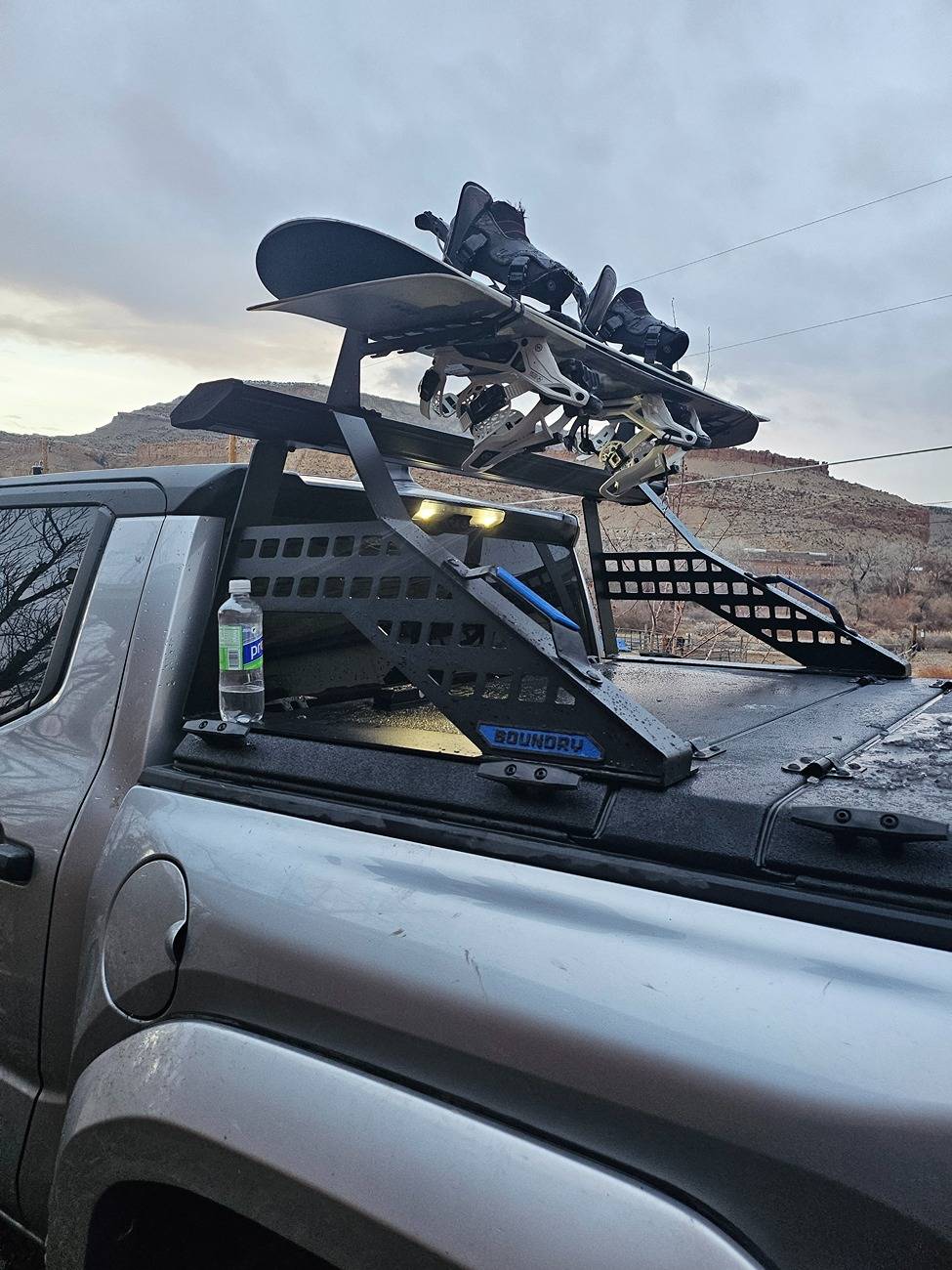

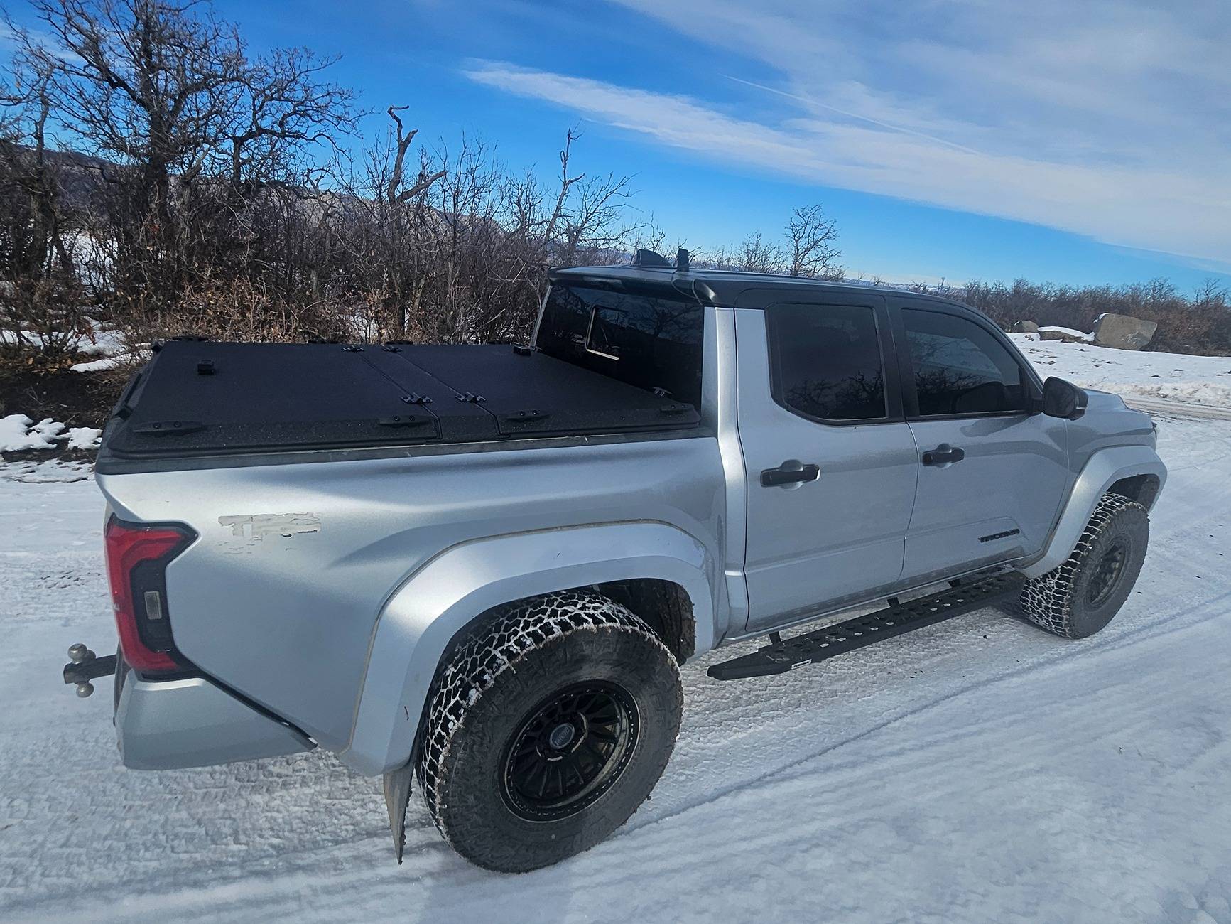

Diamondback is solid in rain and snow - I need to add a strip at the tailgate to keep dust out.
Boundry rack is solid - I bolted it directly to the DB Cover. Because of that it sits a bit high for my liking. I pushed it as far forward to the cab as possible. With different struts and some fab I may be able to still open the front hatch. I might do some fab to bring it down.
