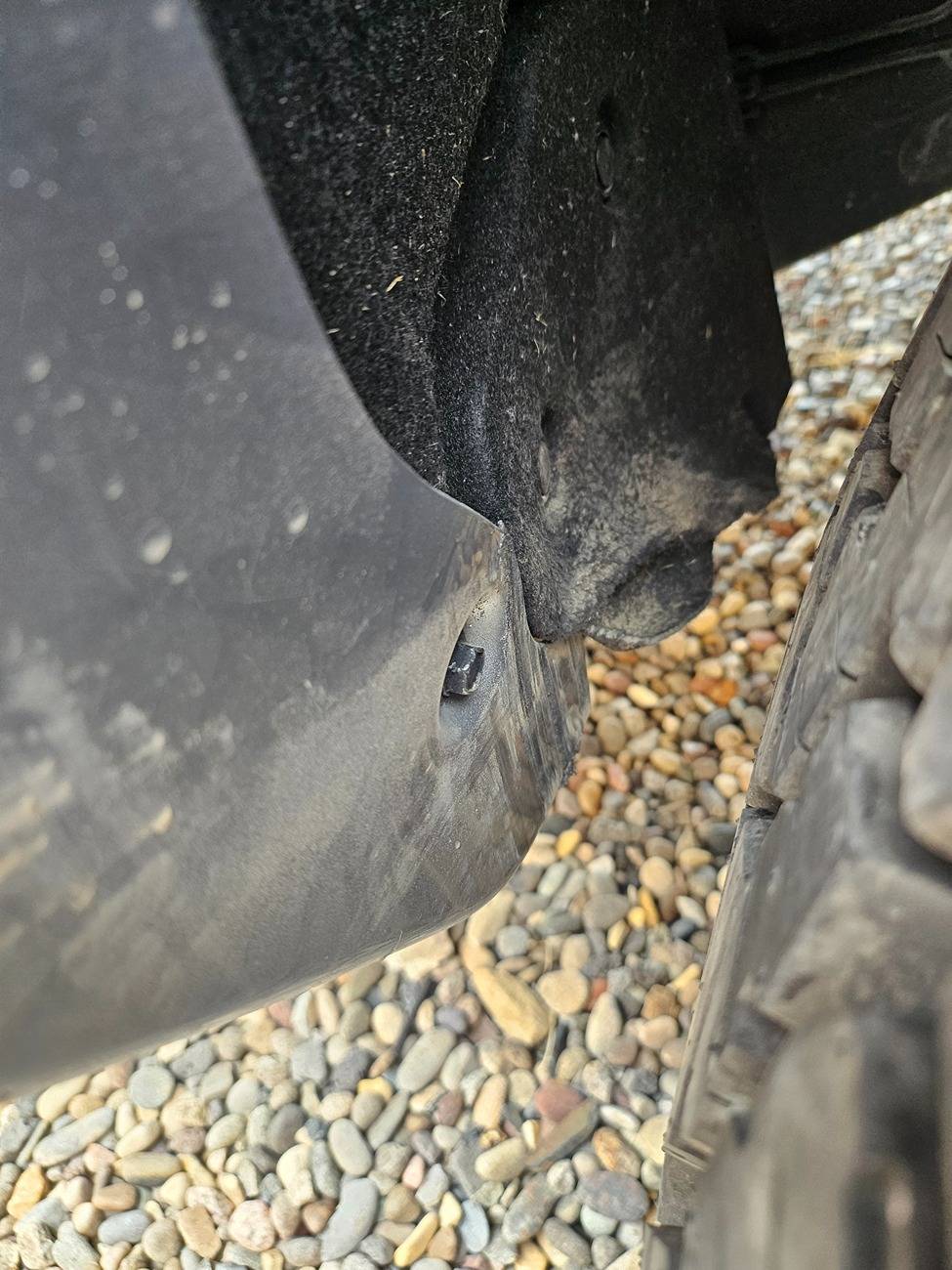

You had to trim beyond just removing the crash pad? Lots of folks fit 35s just removing that 3 bolt piece and trimming some felt. I wonder what the difference is here. Asking because I like this specific AT4Ws which are a true 34
Unlike the Pro/TH fenders. These roughcountry ones stay thick all the way down. I could have 35s easy with 40 offset. Or maybe 35x10.5 with 22ish offset. But 11.5 tires and 0 offset has me hitting outside the strike plate area.

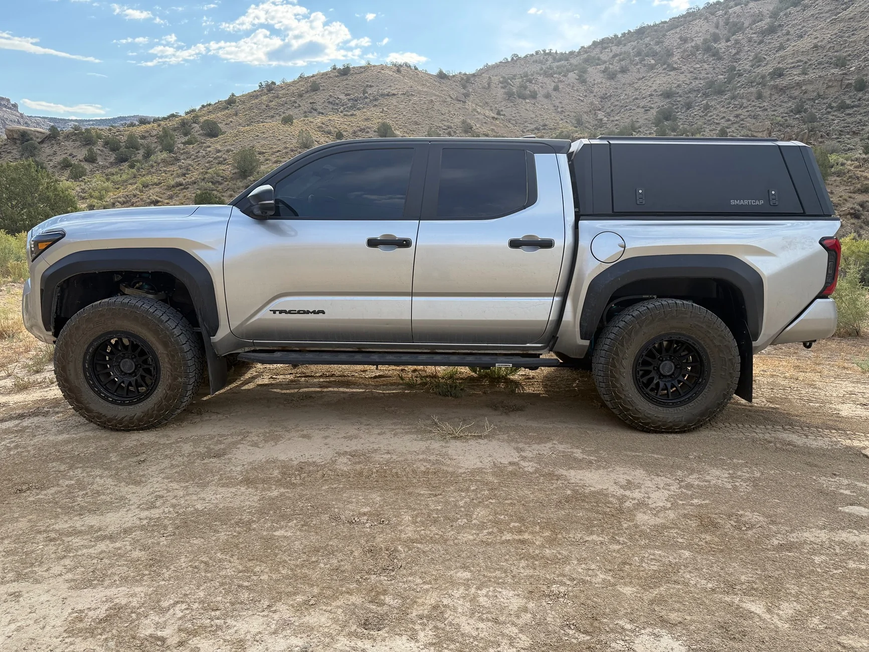

Updating the build
Done:
15% Ceramic window tint all around
Satin black roof/pillar/mirror wrap
front end PPF
285/70/R17 Falken Wildpeak At4W
285/75/R17 Falken Wildpeak AT4W C Rated
King front/rear shock kit
Icon UCAs
Rave offroad black wheel trim on one side of vehicle cause thats a PITA
17x8.5 Matte Black Wheel RRW RR7-H Flow Form 6x5.5 0
Triplealiners interior floor mats
Plastidip front emblem
King rear sway bar end links
Spray paint that big ol exhaust tip black - Switched for a dump tip from ATH
Rough Country color matched sport fenders took these off because they took away from clearance and added Rokbloks high clearance flaps. These are perfect for coverage on wider setups. May adapt fenders later but could only use due to mounting.
Rough Country rear shackle kit
Rear seat delete/storage setup
DV8 Offroad Centric Front Bumper with - DV8 Winch, 3" Ambers and 20" Spot
Diamondback HD
Boundry Truck Rack

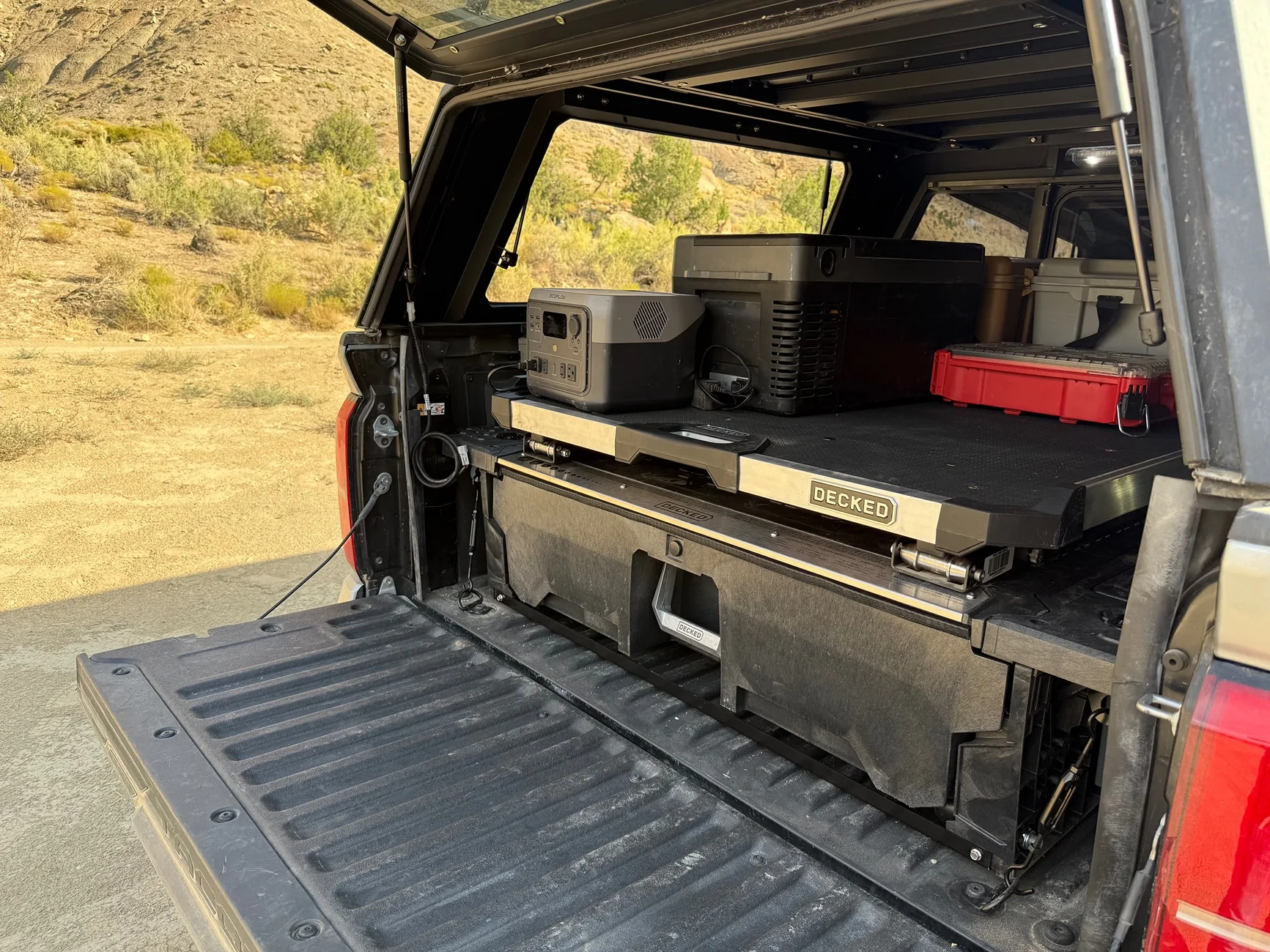

so I had found a really low pro bedside but it fell through due to vendor. With most bedsides at 5” high there just wasn’t enough clearance for gear. I bit the bullet and added:
Smartcap Adventure
Decked drawer
Decked 1500 slide on top
With all the weight this truck was looking dumpy in the rear. Got the :
Icon rear overland +600 .5” coils
Sits perfectly .5” higher in rear and didn’t look too bad even with a 8000# dump trailer.
I also added the Keko bed dust seal kit. Worked perfect with the DB and so far good with cap. Most of the dust gets in on the sides of the tailgate.
Need to install all of my Meso lights and get my bed geared up. The slide takes a lot of room but is really heavy duty and still has more room above it in the cap than I had under the diamondback with no slide.
I have full truck and smartcap racks coming from UpTop overland with their LED side lights. This thing is gonna be a tank.
