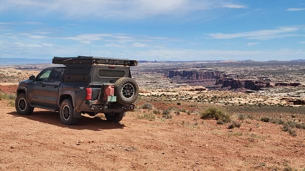

I had my 285/70-17 on a stock TRD-OR rim underneath for a short time. I hated it. It was too low, and a royal pain to drop down and pull out. That was in the driveway. I could not imagine having to drop the wheel in the weeds.
My spare now lives on a rear swing out (Victory 4x4). It's a heavy MOFO getting it up there. But, I would rather have it on the bumper than on the ground.
