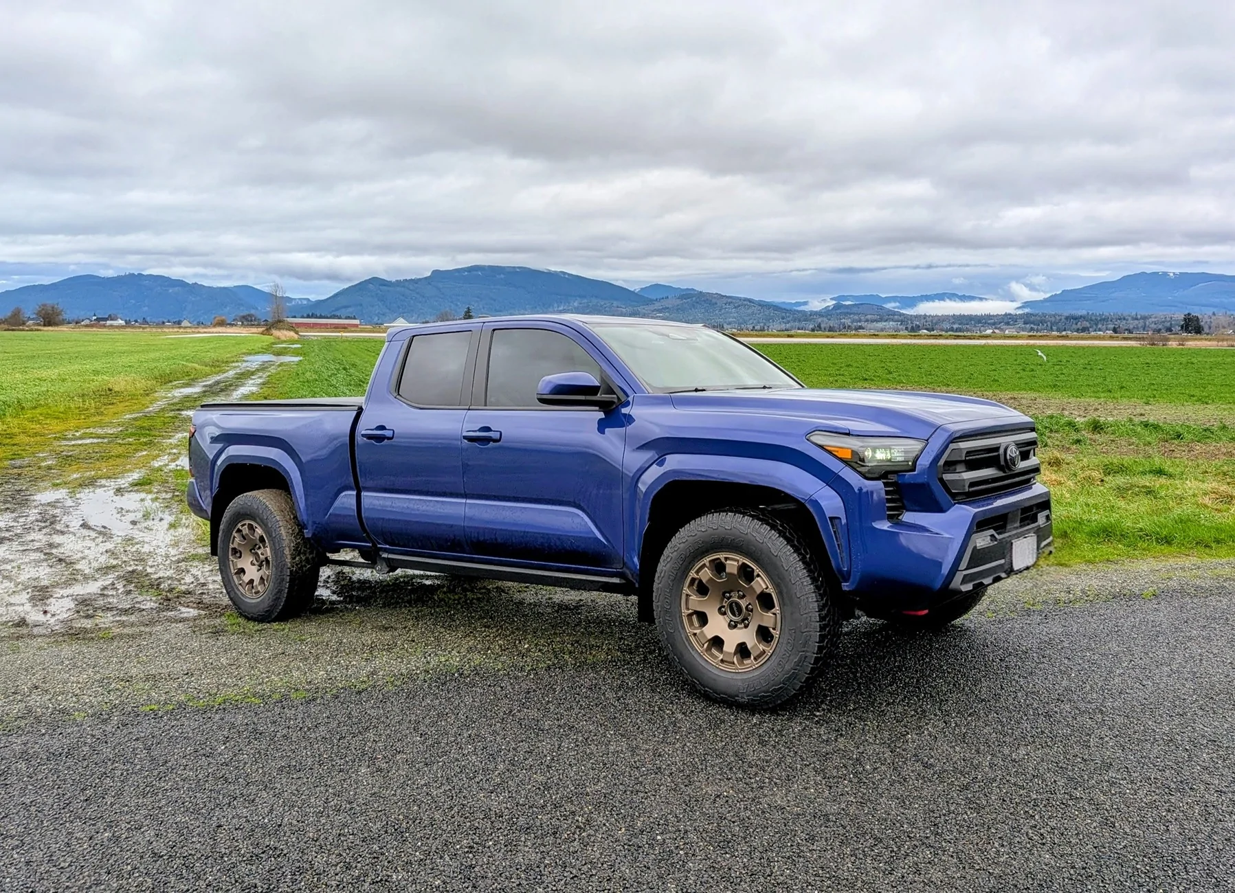

I've tried bronze and machined on blue crush (couple examples below). Can't speak to the tire size you're considering as I don't need anything that big. It's worth it to consider something in SL if you're commuting and not off roading much.
2024 Tacoma Tire and wheel size PXL_20260112_212255949~2
2024 Tacoma Tire and wheel size PXL_20260308_230126015~2

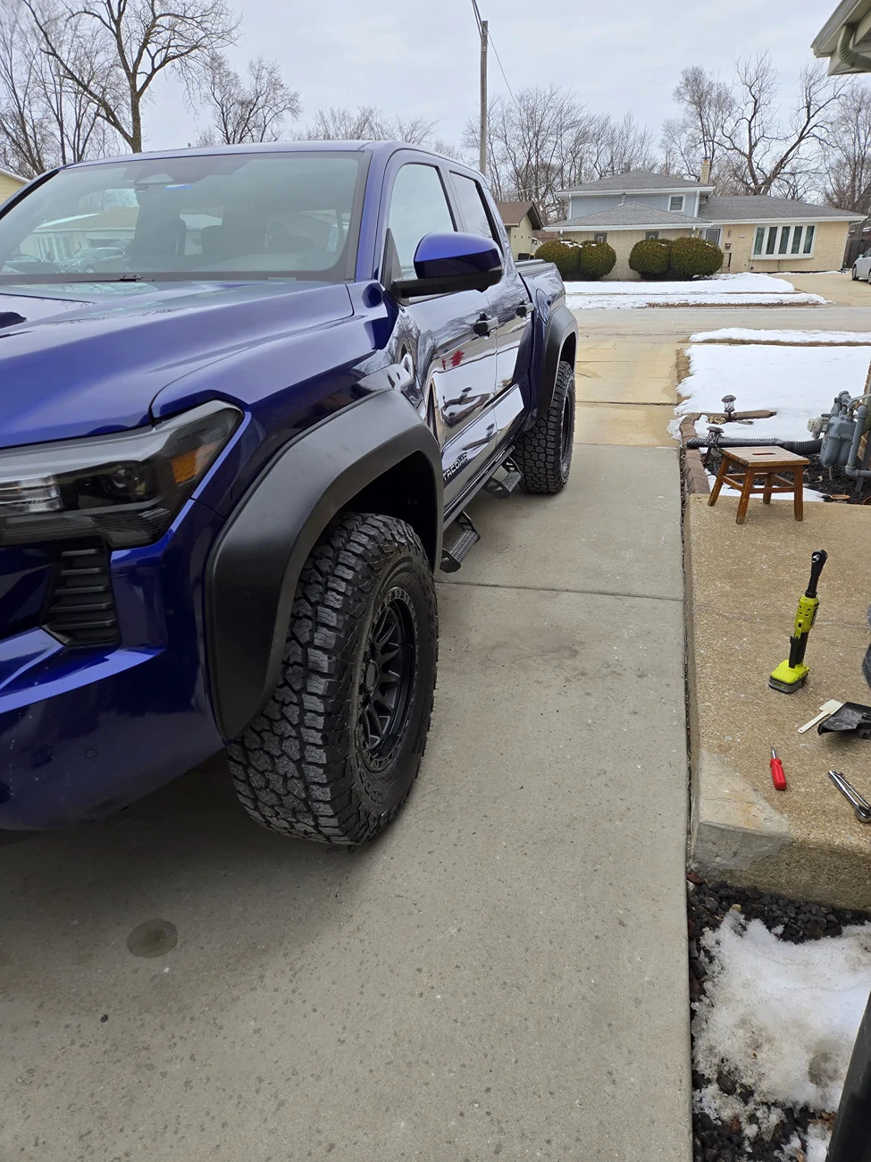

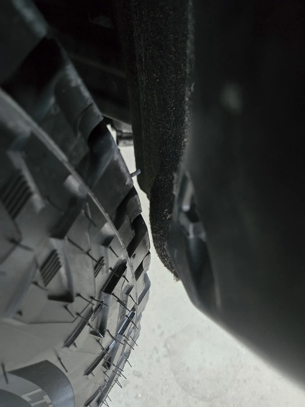

2024 Off Road 8AT Blue Crush Metallic

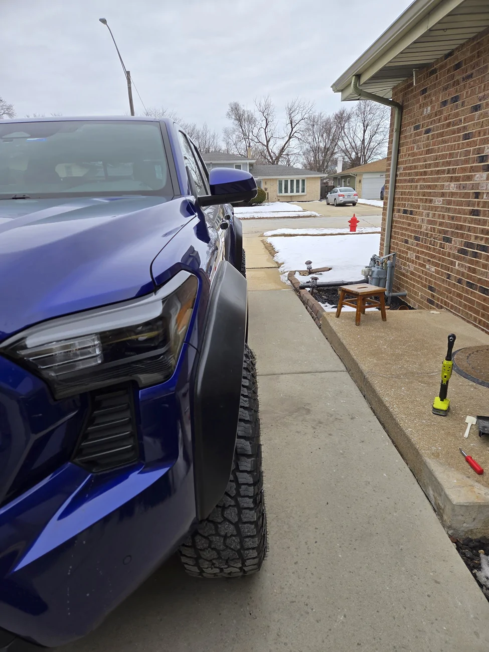

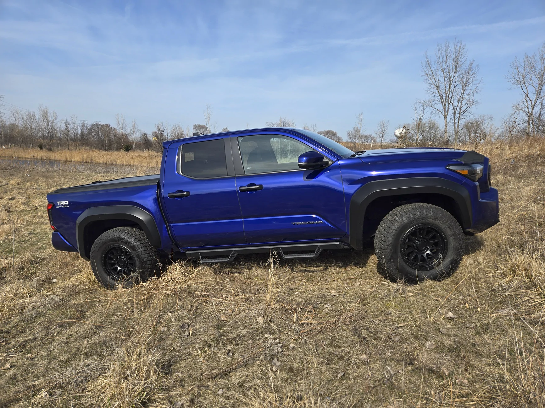

I put black 17x8.5 zero offset wearing 285/70x17 on mine, needed removal of mudflaps and different fender flares because of the "poke". Didn't need to do any cutting...just BARELY.
2024 Tacoma Tire and wheel size 20260208_145412
2024 Tacoma Tire and wheel size 20260208_145417
2024 Tacoma Tire and wheel size 20260320_152948
2024 Tacoma Tire and wheel size 20260208_170146
2024 Tacoma Tire and wheel size 20260208_170157
