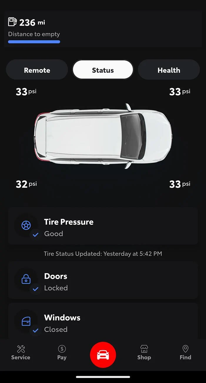

I am happy to report that after contacting Toyota at 1-800-331-4331 we were able to get my digital key reloaded and my tire pressure is now showing in the app. I am very impressed with the help I got with this over the phone with Toyota. If you are having any issues don’t be afraid to call them. I really did not think we were going to get these issues fix over the phone but he walked me step by step through the process and both issues have been solved. I also let them know about the issue we all (iPhone users) have been having with the radio not reducing the volume when we are listening to a text message through CarPlay. He told me that will be documented with my case number and that it would be looked into.
Oh, what a feeling! - if you know, you know ?
Are you on I phone do you have the premium package? My android doesn't show tailgate and my vehicle avatar isn't a truck... Toyota software leaves a lot to be desired.

Mine works on both, app and the dash. That's how I found out today that the guy who mounted my snow tires this morning pumped em up to 40-44 PSI. Aired down this afternoon with a gauge, and the tpms is registering fine, always has worked for me
Yes, iPhone and premium. I am almost positive that if you call, they can get yours fixed over the phone. You’ll need to be in the vehicle and have your remote with you. The will be able to walk you through it step by step. It will most likely involve resetting up your vehicle with the app. But it’s not as simple as you may think and must be done exactly like they tell you. Be ready to spend at least 30 mins with them on the phone. Good luck!

Everything works fine for me, just the no tailgate which I suspect could be a premium feature since you have the powered tailgate. The little avatar does not bother me, just thought it was funny. If it ain't broke don't fix it. Don't want to cause more problems.
