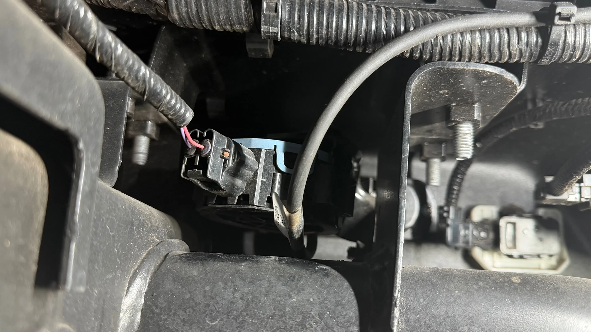

where is the sound making thing located? also the company called it AVAS, what is this thing called? a speaker?

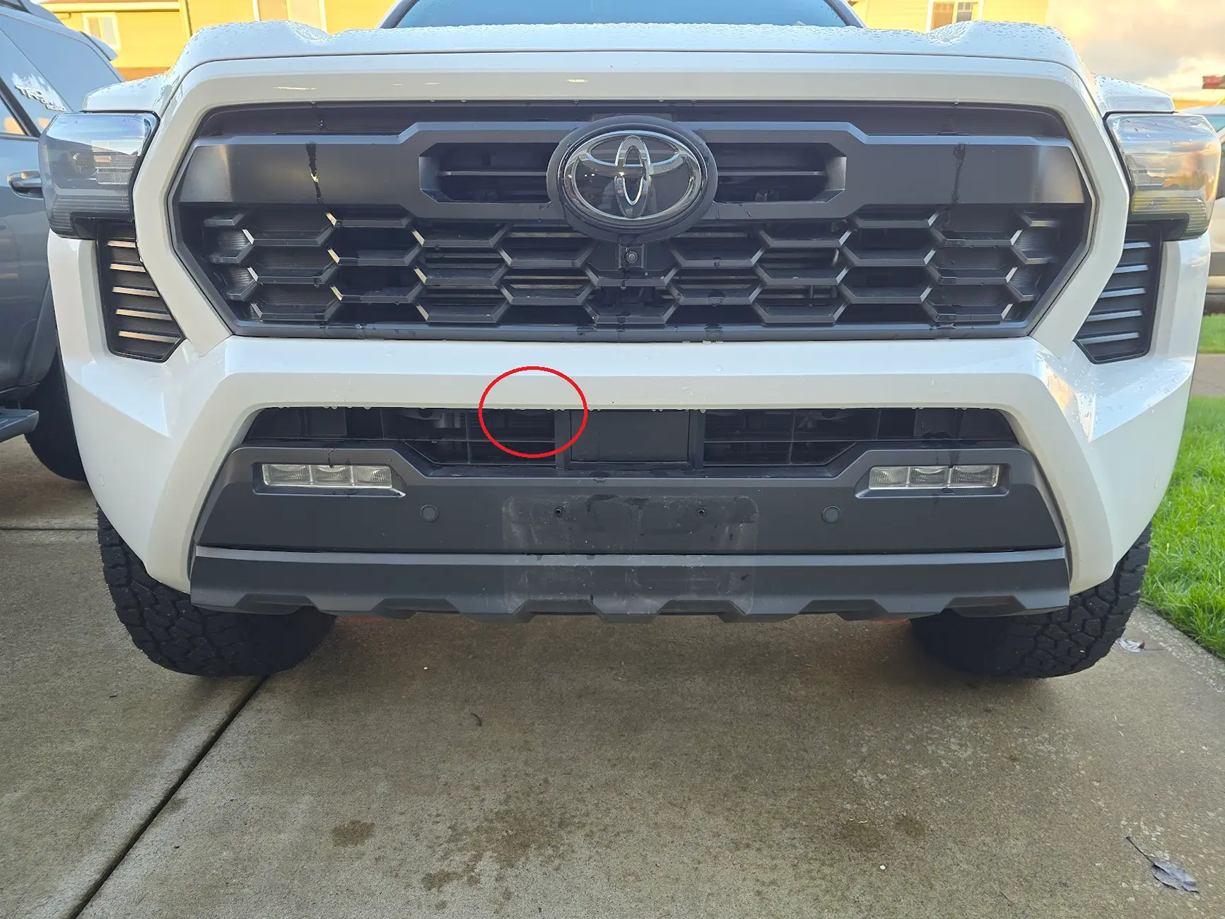

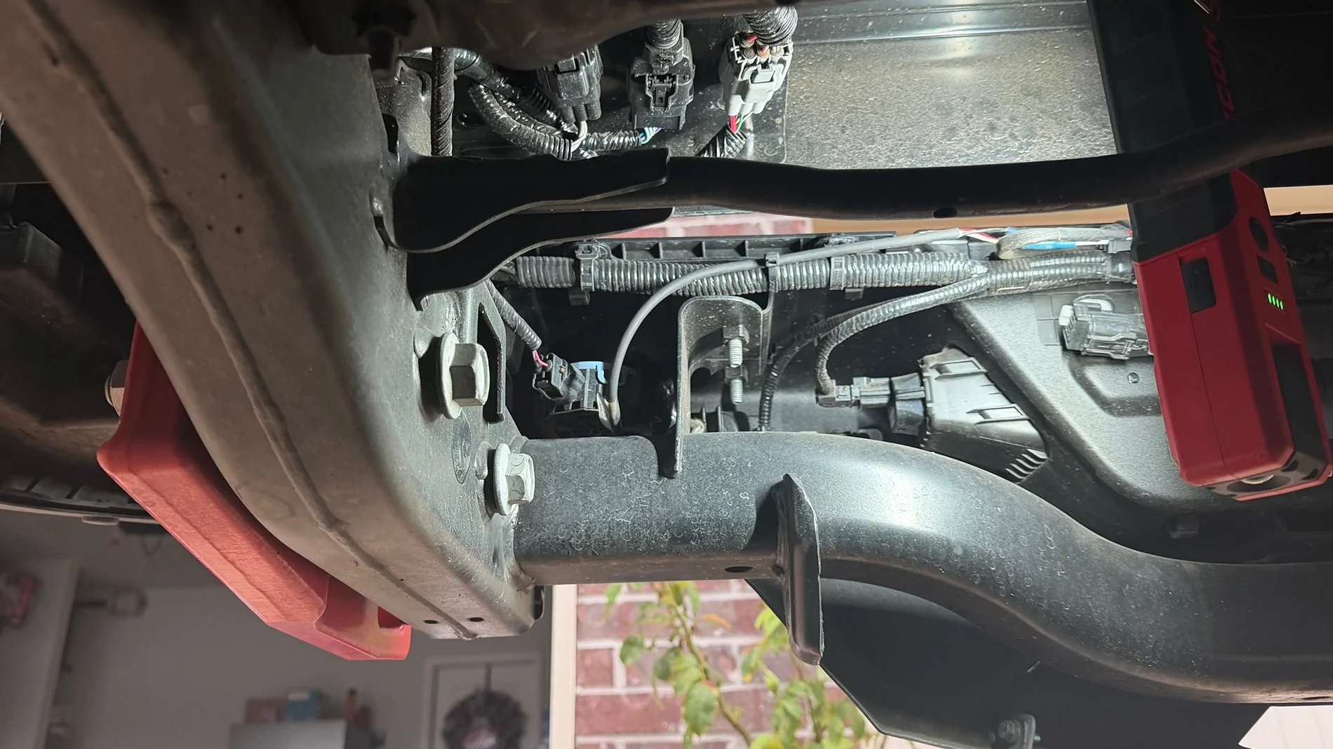

If you have the air dam removed you can slide your hand up between the skid plate and the front bumper and reach the plug.
If you unplug it without attaching a resistor the truck will throw a check engine light
2024 Tacoma Hybrid speaker / flying saucer noise delete kit installed Hybrid Front Speaker Location

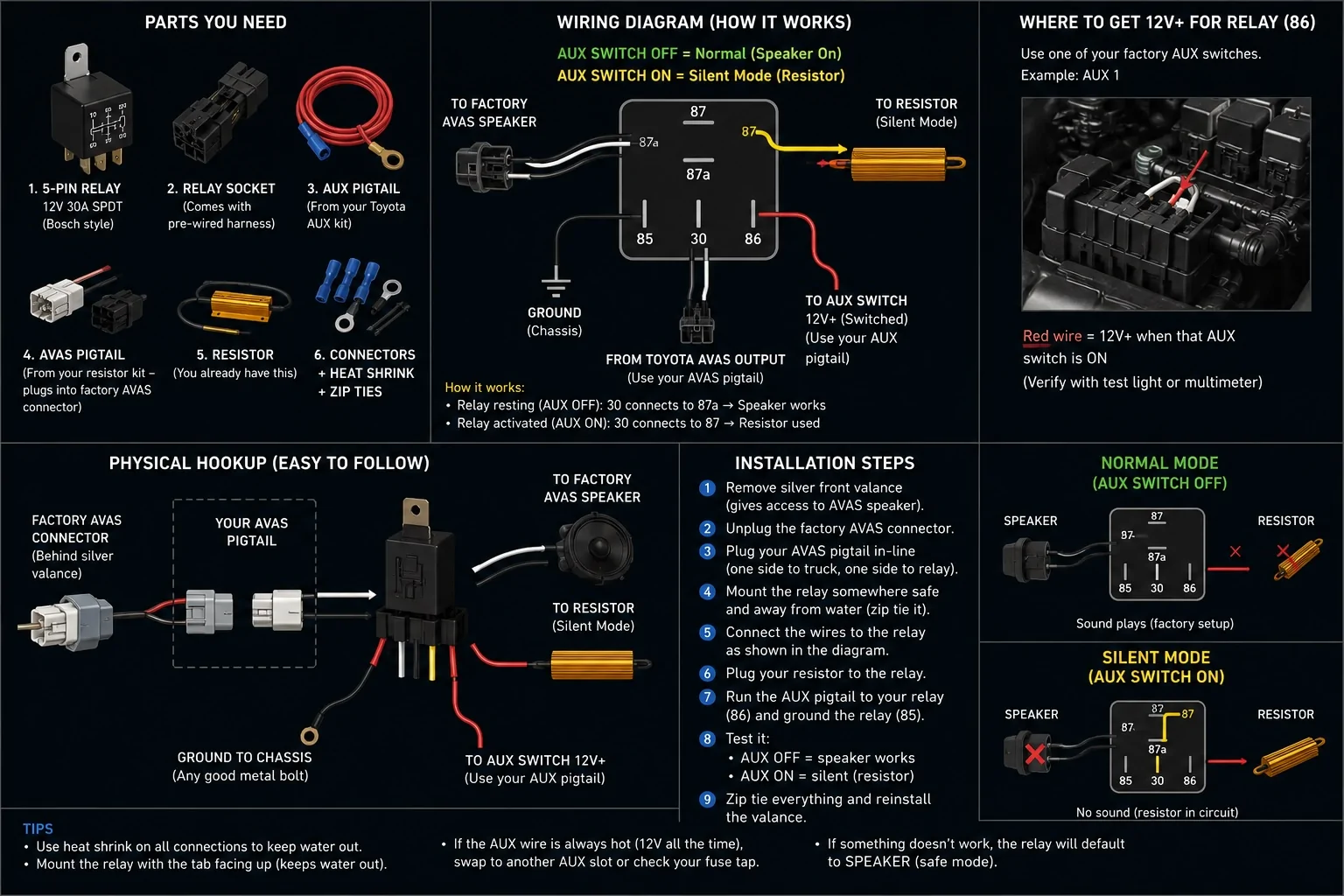

Good to know it's not just me. My rear has a speaker too, behind the rear steel ARB bumper, offset from the midline to the right a bit. I might try putting duct tape over that speaker, to at least mute it.
Eventually, I'm gonna try connecting a relay switch to one of the Aux ports so Can activate it on or off. I asked my Ai to put together instructions/diagram and it seems like an easy ish install.
