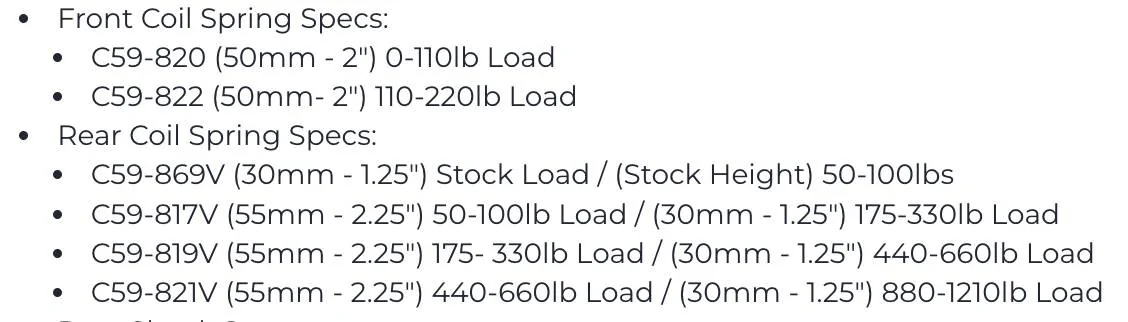

For the Dobinson, you may have to take a little gamble depending on what you want. Below is a screenshot for the rear spring options showing potential lift/load. Keep in mind these lift numbers are for an SR5 or TRD Sport / Off-Road truck, not the Trailhunter. Supposedly we have a 1" lift in the rear already and I think that is a spring lift so you would need to subtract 1" from the lift numbers for what will actually be achieved against the stock Trailhunter. My suggestion would be either the 869 or the 817 depending on if you want .25" of lift or 1.25" of lift. If adding the Peak 1" lift, I would definitely go with the 817 (personally). All this assumes stock load.

Not sure about any of the lift kits, however, any of the springs that work on any of the gen4 Tacomas will also work on the TrailHunter. But if something says a certain lift you will need to subtract 1" from a front and .5" from a rear to account for the lift the TH already comes with.
Look into the Dobinsons spring options posted below. The C59-820 will net you about one inch in the front @ stock weight and the C59-822 should be a little better.

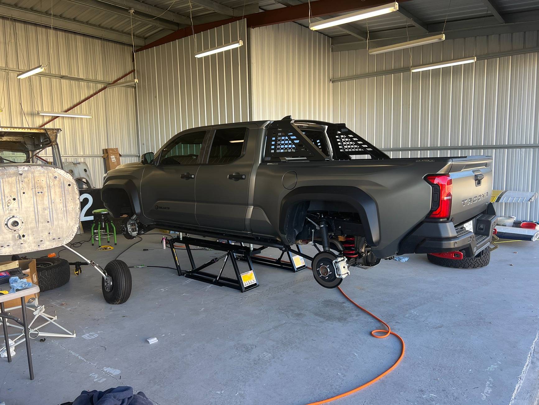

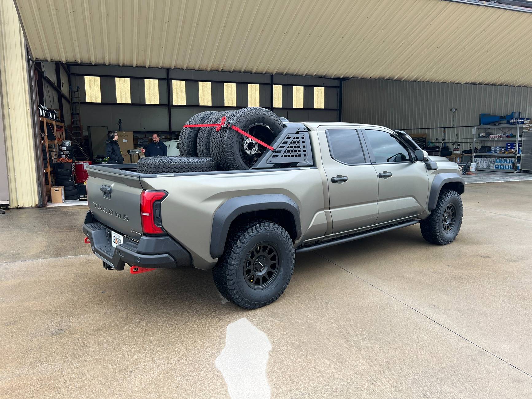

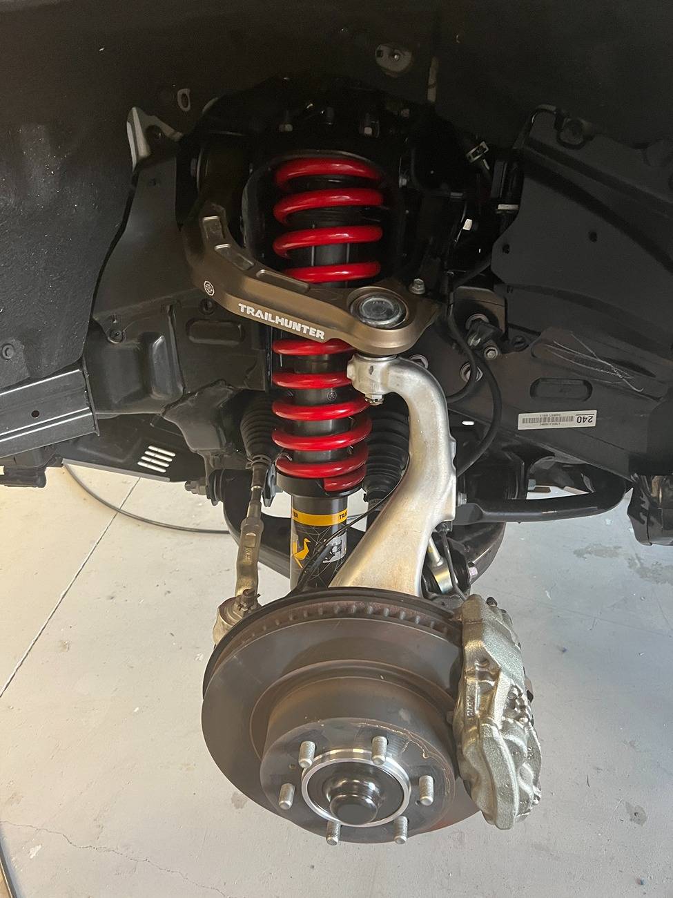

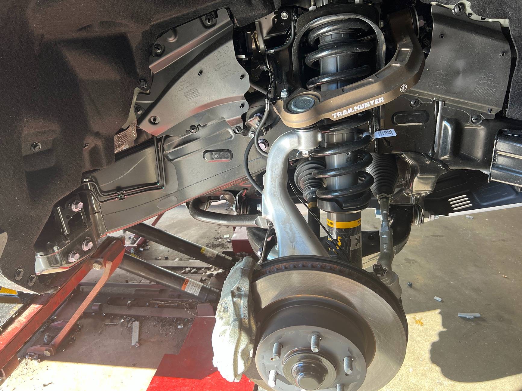

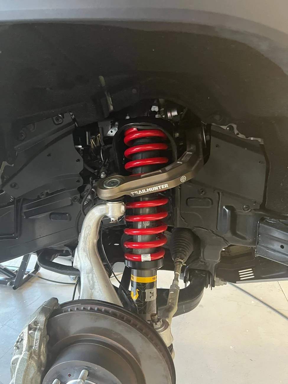

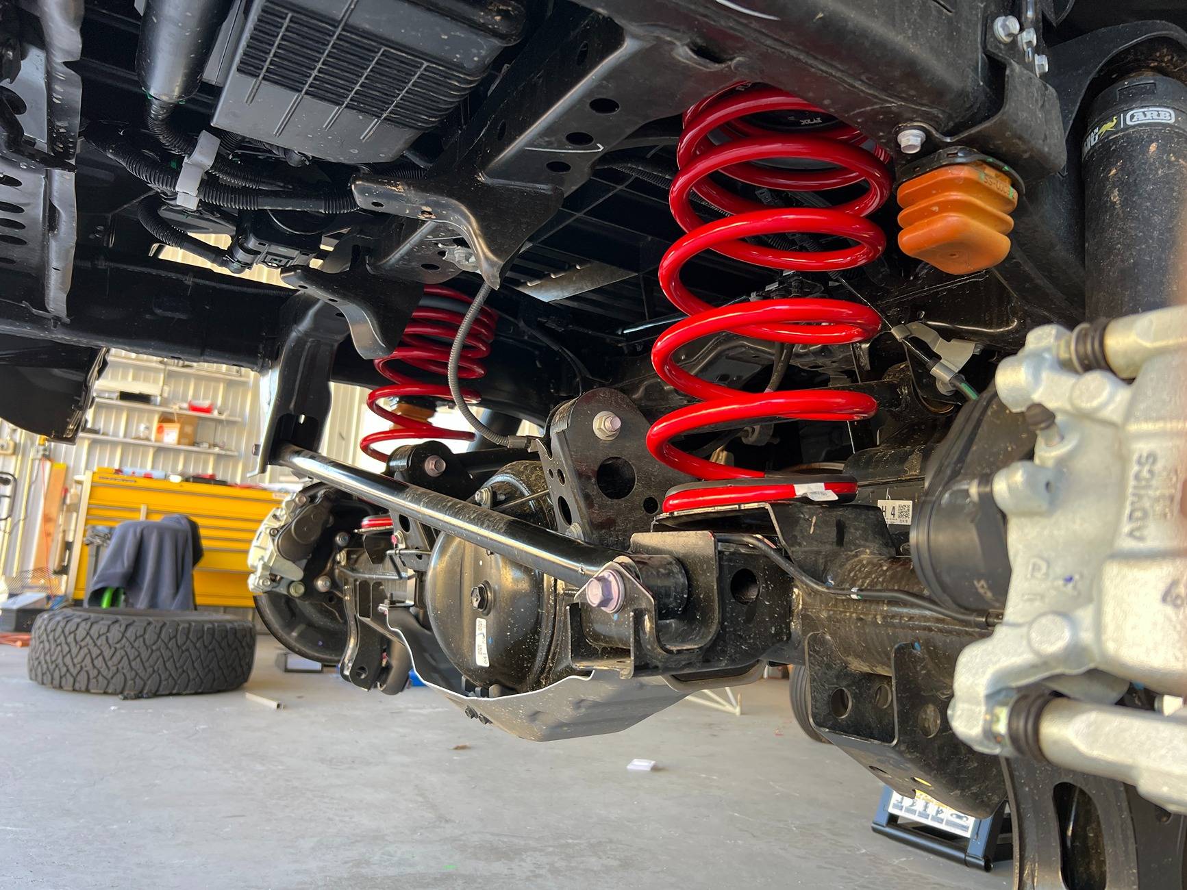

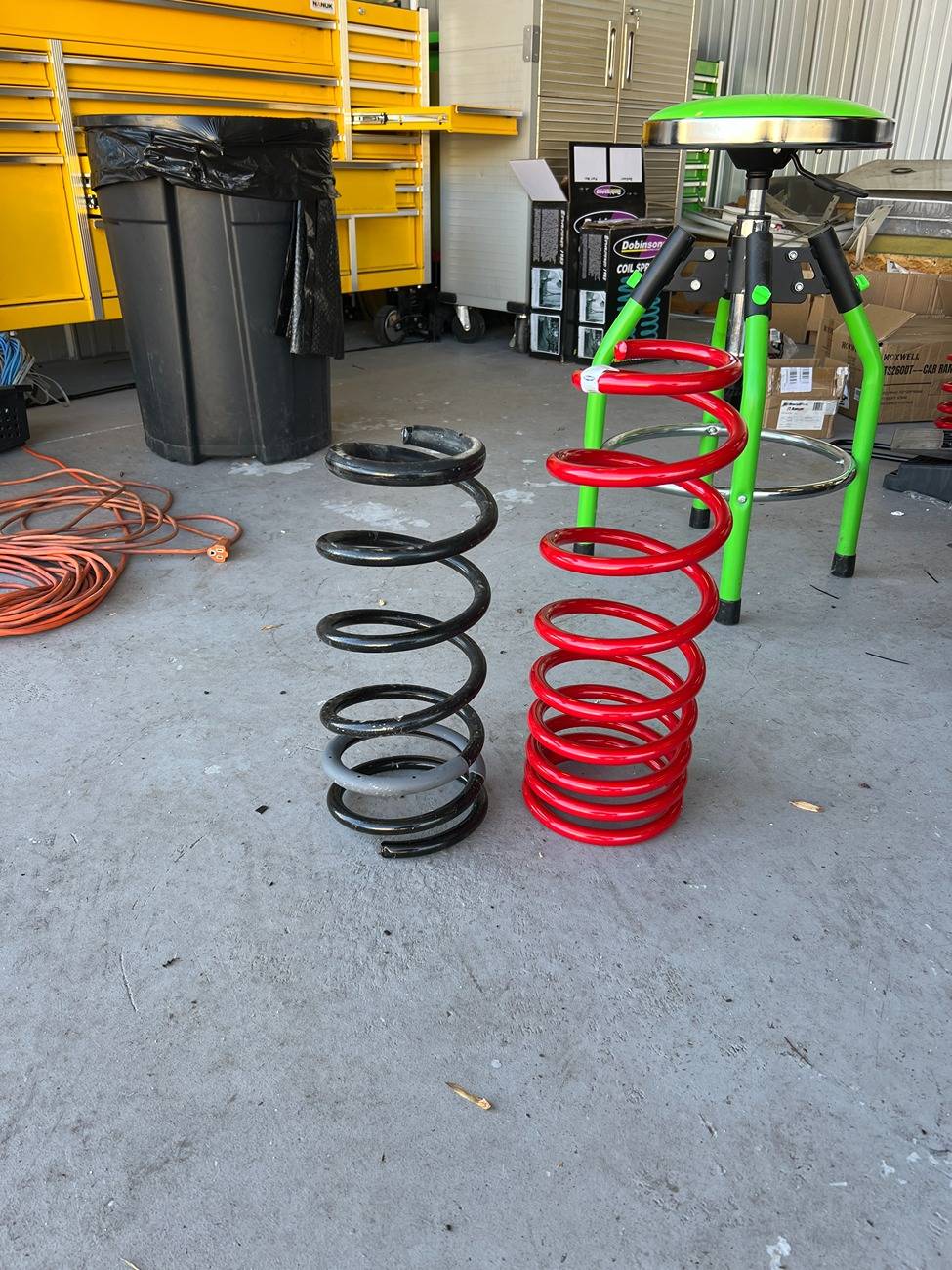

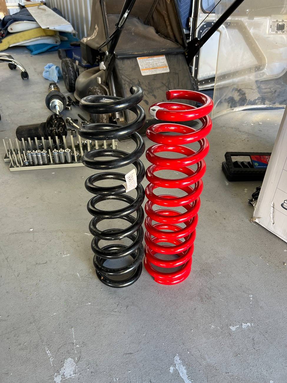

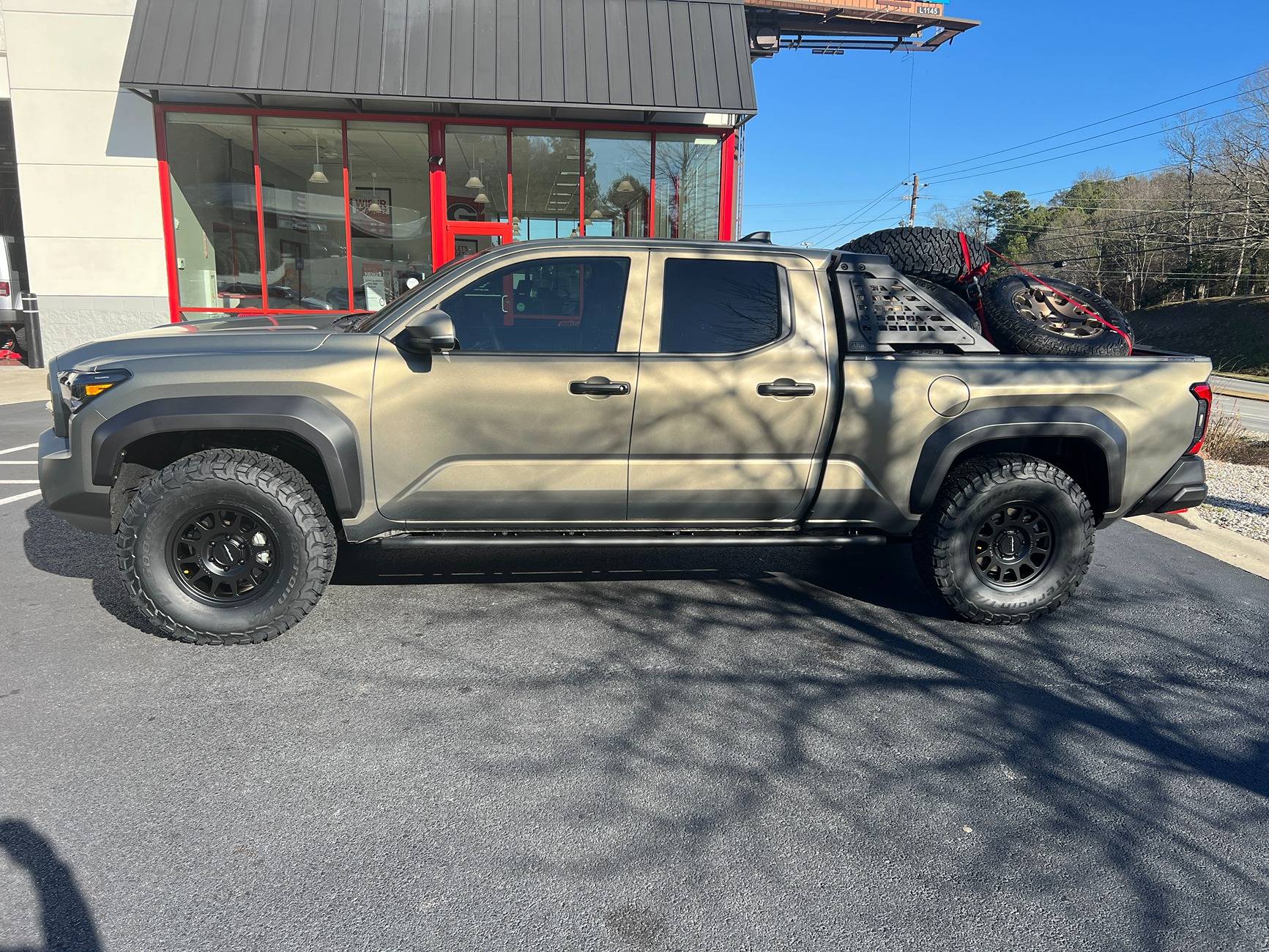

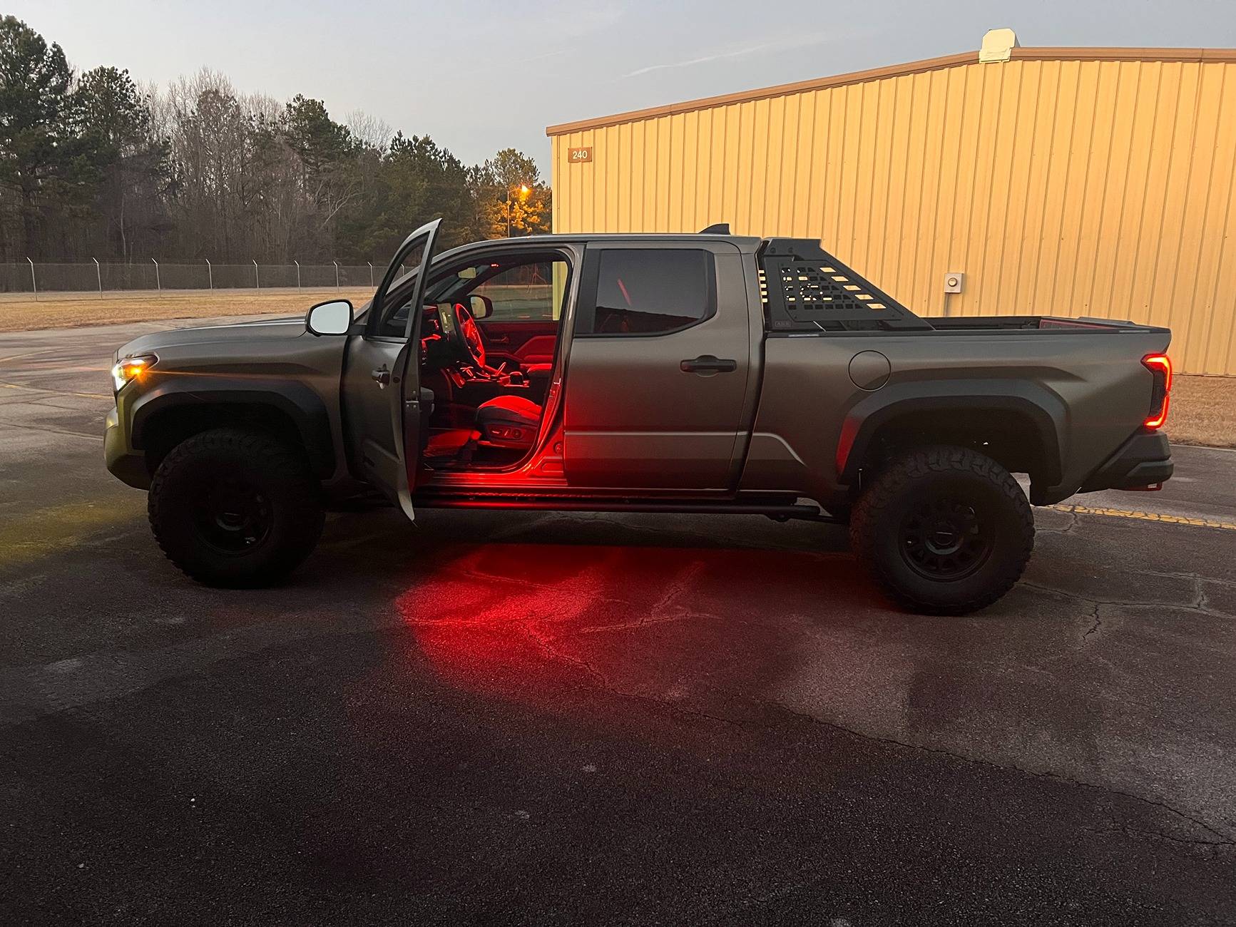

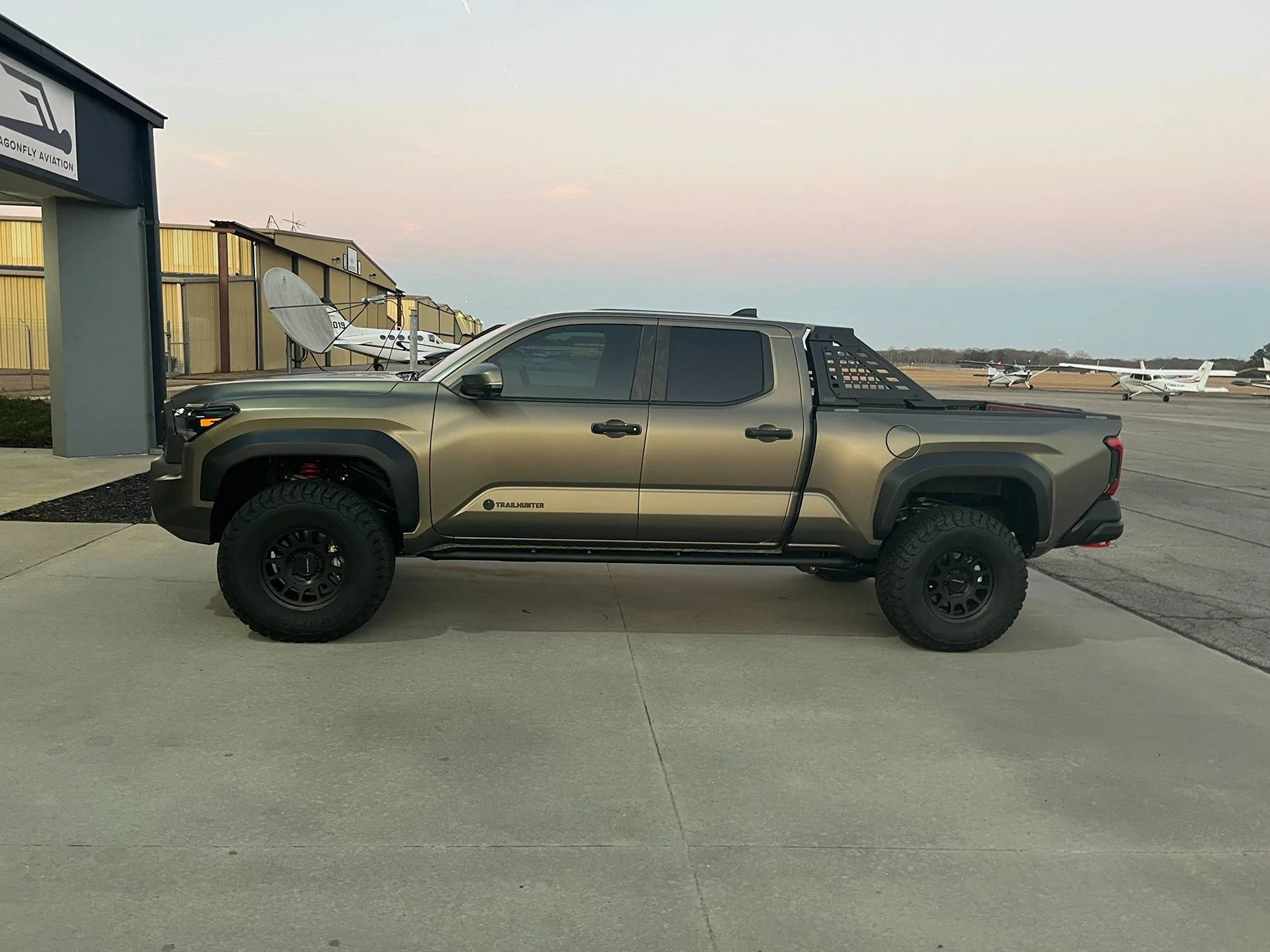

Just got done installing Dobinsons springs rear and front on my TrailHunter Long Bed. I went with C59-820 in the front and C59-819v in the rear. I have about 300 lbs of weight in the back with the Decked system and items in the drawer. The front netted me about 1" more height (22.5" to 23.5" as measured center of hub to fender) and about 2.5" more height in the rear (23" to 25.625" as measured center of hub to fender). First two photos are before but with added weight with the old wheels and tires. Black springs were stock TH springs and the red are the Dobinsons.

That looks really good, how does it ride? Keep us posted at to your mileage with those 35’s. Special thanks for the detailed photos of the process, as well as the underside and suspension. In that pic of the rear end with the Dobinsons springs, is that a Fox part up at the top? Is that a bump stop? I thought those only came on the Pro.
MrJetset
Jon
Aug 24, 2024
Hoschton, GA
2024 Tacoma Trailhunter, 2010 Tacoma TRD Off Road
Mileage is not the best for sure, I think I have averaged about 15 since I put the 35s on. Ride home this evening was good. Felt pretty comparable to stock.
The Fox bump stops are not there, but the holder piece comes standard on the trailhunter and has a cover over the threaded bit. If I had thought to order some I would have installed them when I did this install. Next time for sure.
