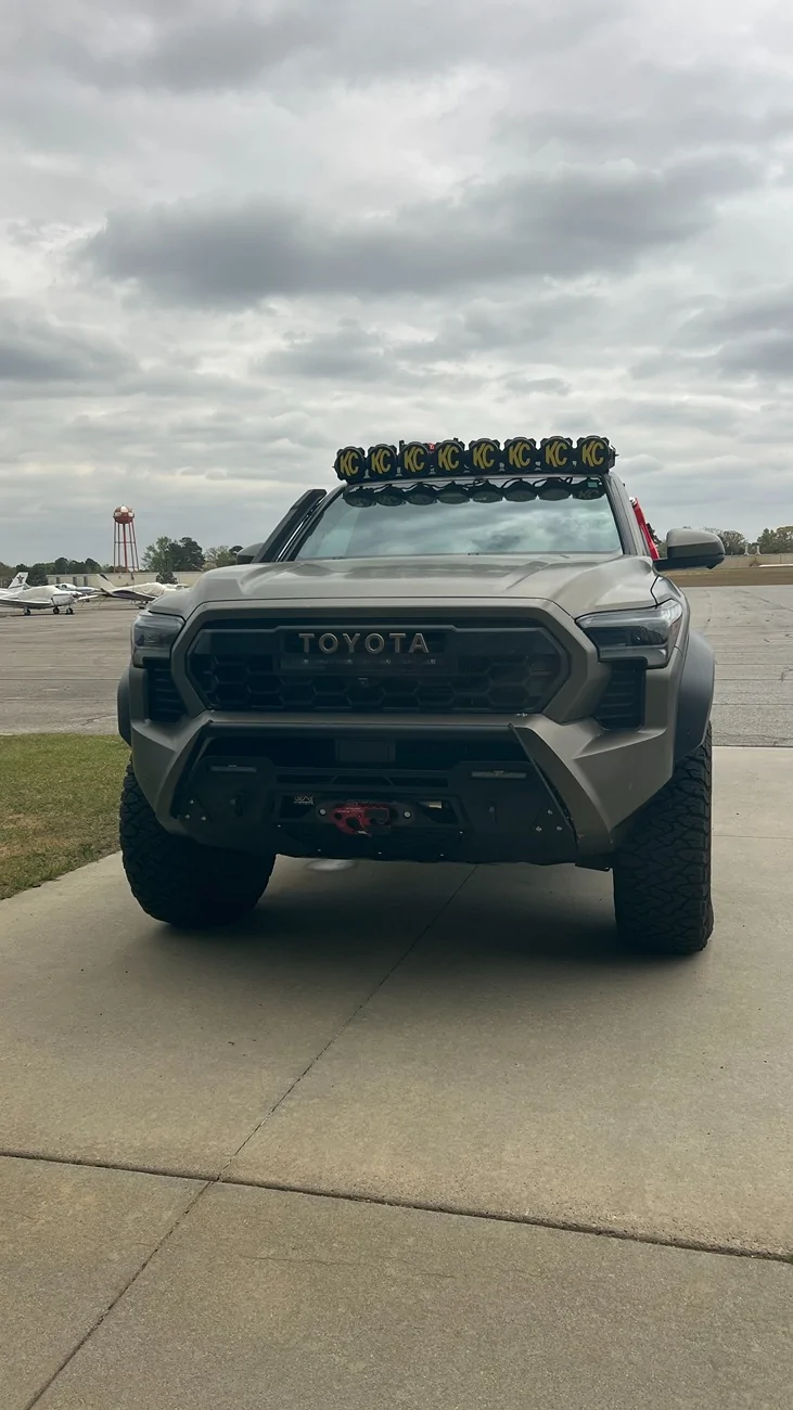

The set up is holding up pretty nicely! I just added at least a couple pounds to the front with a CBI Covert Bumper and a Warn Evo 12S winch, as well as a KC Gravity Titan Light 50" Light bar on the roof rack. I just measured and I lost about an inch in the front putting me back to stock for the Trailhunter there. I will probably go up to the next size there to see if i can get that inch back.

I do not believe that you can go wrong with that CBI bumper w/ Bull bar. The KC light bar is attached to what roof rack? I have the CBI super covert with Badlands Apex.

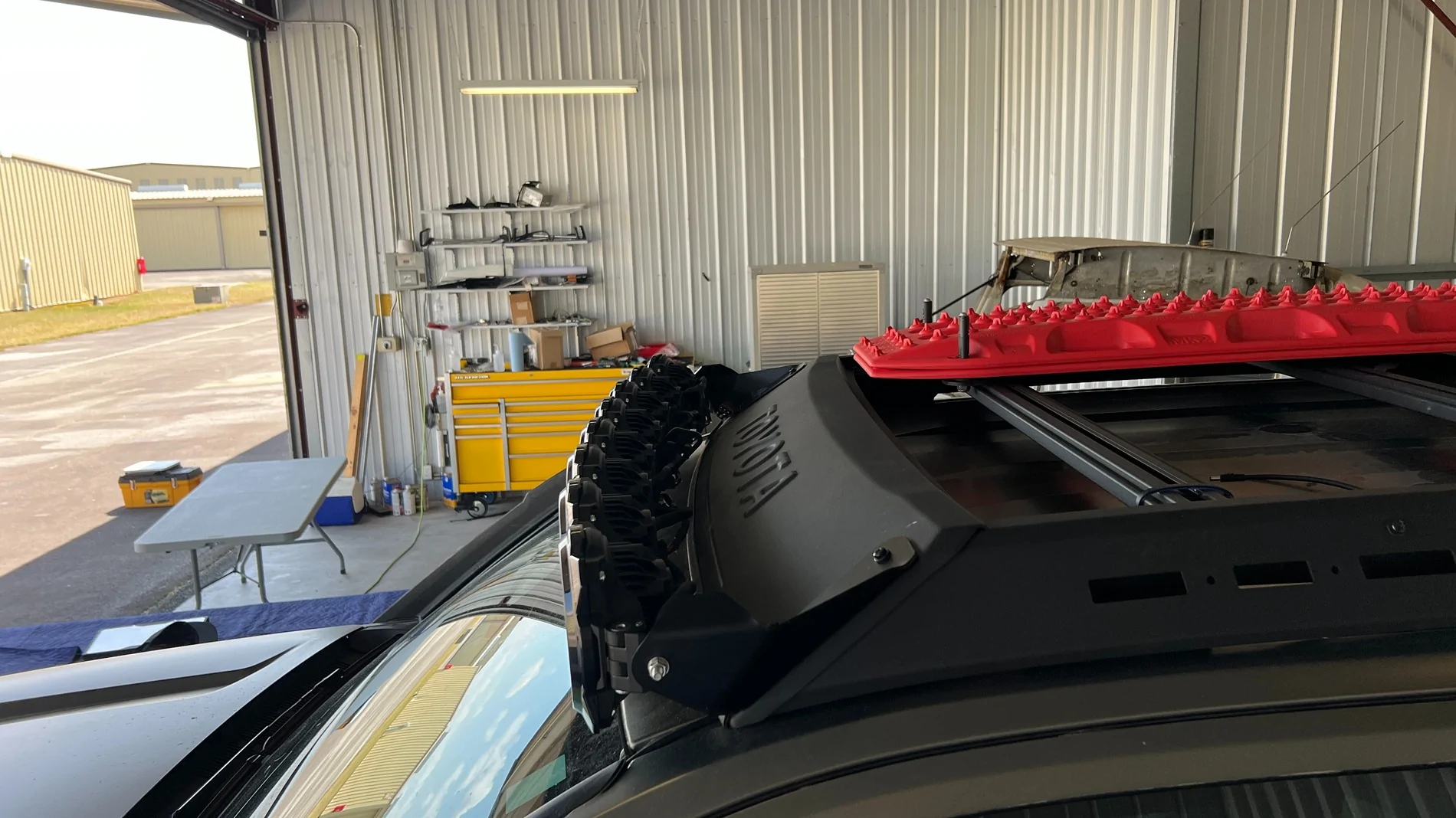

Believe it or not, the Toyota Roof Rack. I designed brackets to mount it up there to the factory bolt holes. These were the prototype, I have tweaked the design and I am waiting on the new version to show up. But they were 99% there with these.
2024 Tacoma Trailhunter lift options IMG_7549
