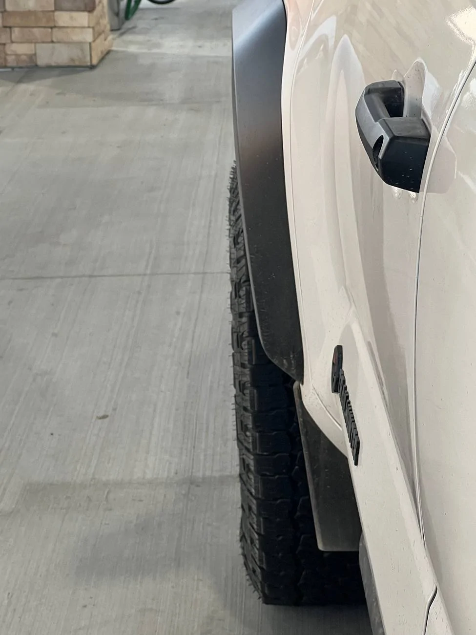

You could very easily put on 285/70/18s which come out at 33.7” in diameter for most brands and will have a fair bit of poke. If you don’t give a crap about weight I’d get the Falken AT4W in that size which runs in a true 34” and is also a bit wider than almost any other manufacturer in that size. C load three ply sidewall - tough as balls. 68lb. I think tread width is 9.6” and tire width is 11.5”. They are big boys and will look awesome.
Probably a little more poke than what I have here - may or may not be enough for you.

This will be great, besides doing leveling kit, only adjustment may be removing crash bar. ?
i like this , thank you

I don’t think you’d need to do any more than that.
