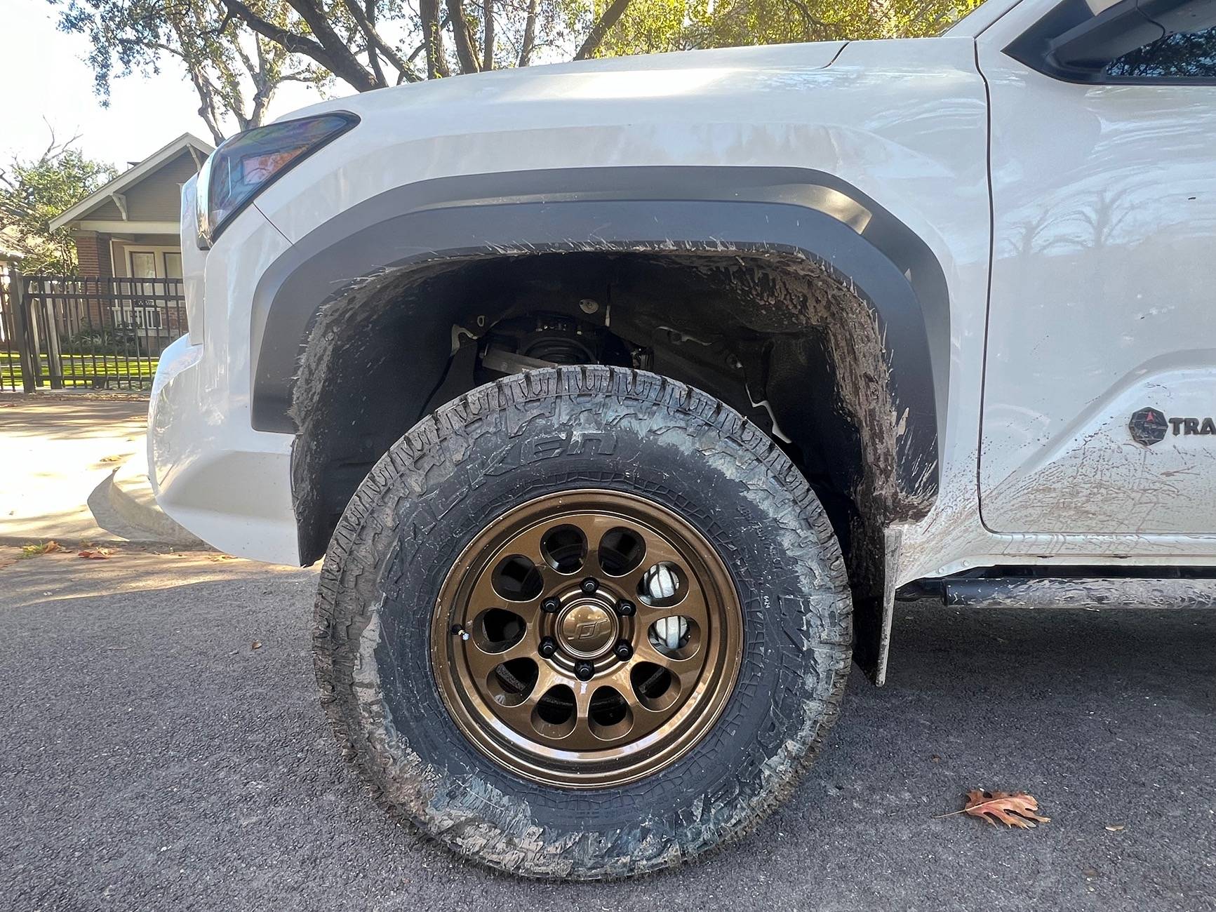

Do you guys think a 285/75/17 would fit without taking off the crash pad? It’s a 33.9” tire. I am going to 17s to save weight and try a different size in a C load tire. I’m running E load 275/70/18 (33.43”) and there’s very little room left. Wondering if anyone has tried 285/75/17.

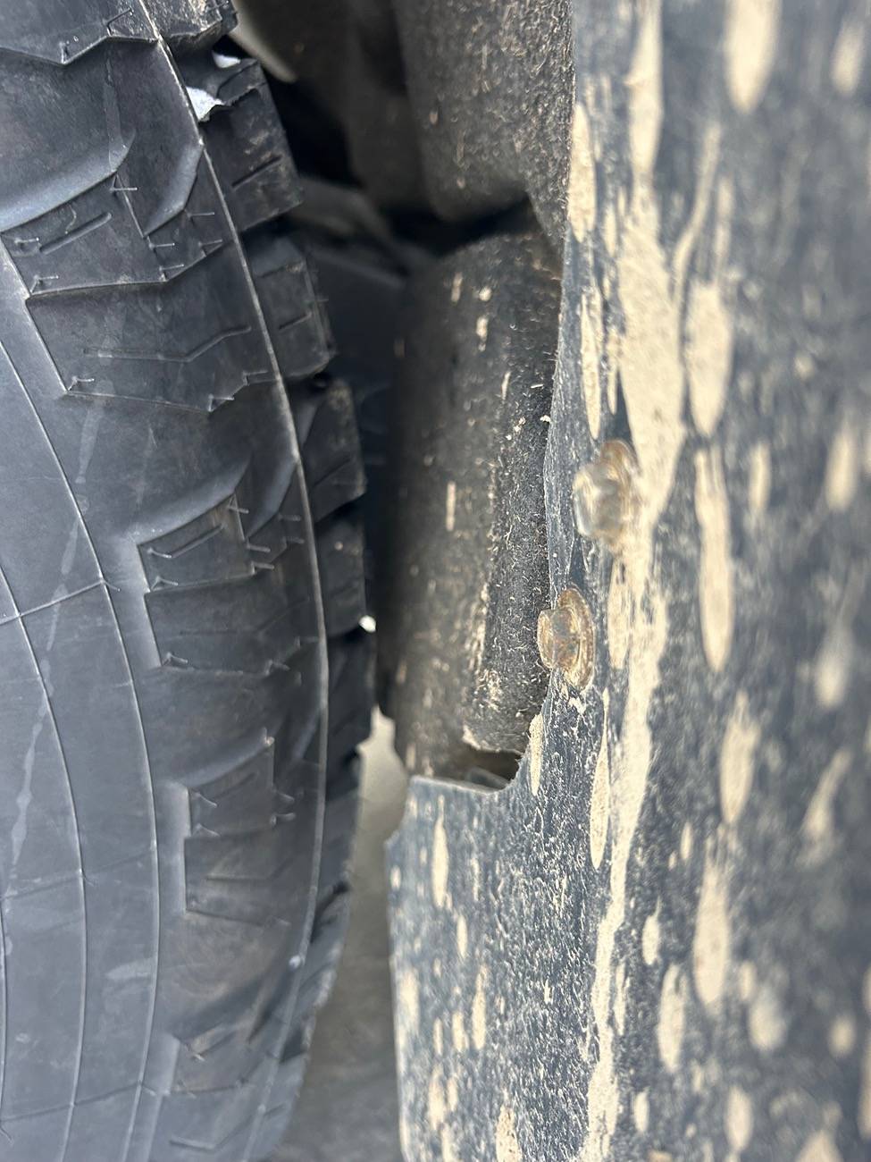

As noted earlier I’m running 285/75/17 Toyo’s with a Westcott 2 1/2” collar lift on my OR. I hand the lift installed immediately after receiving the truck. Initially there was 0 rake after the lift was installed. A few months later the measured rake was 1”. I attribute that to the coils seating or settling in.
My understanding is the trail hunter is lifted 1 1/2” and that’s about where my truck sits presently.
I ran out this morning and took the attached pic. There is 1/2” of clearance.
Bottom line, I think it will be very close.

That’s pretty fucking helpful. I am also super close on 33.43” tires—which is why I’m hesitating — BUT, I think Falkens “run big” and Toyos might run a tiny bit small, so they could be very close to the same size. I’ll take some pictures today of how close mine get.

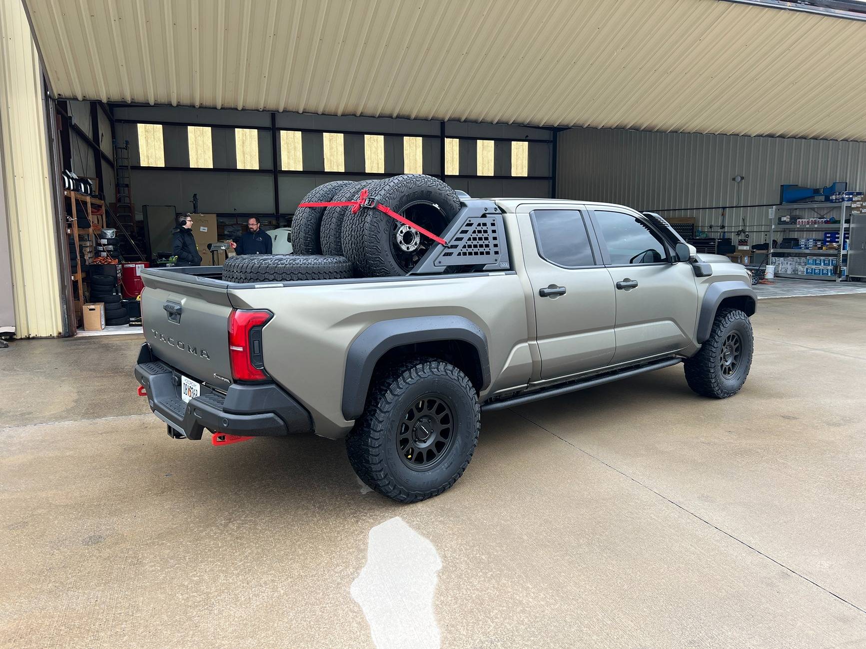

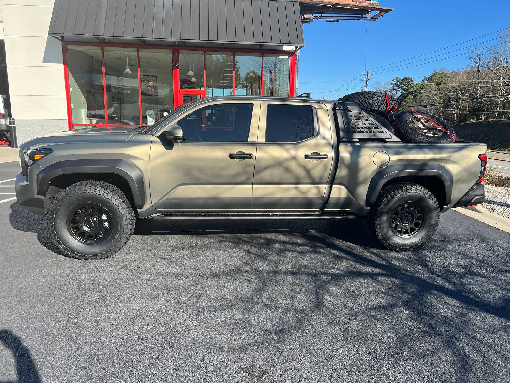

I'm running 315/70R17 which is a 34.4" x 12.4" tire mounted to Method 703s with +35 offset. Currently still stock suspension. I did have to remove the crash pads, but I replaced the bolts into the holes to protect them and there is plenty of room. The only rub that I have is just a tiny bit on the front left side when I make a hard left and it rubs a bracket that is protecting a connector. I am going to look at it tomorrow, I am hoping I can bend it a bit out of the way, I believe I only need about 1/8"-1/4". I will take some photos tomorrow inside the wheel well also.
