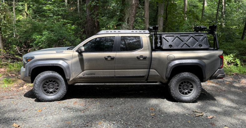

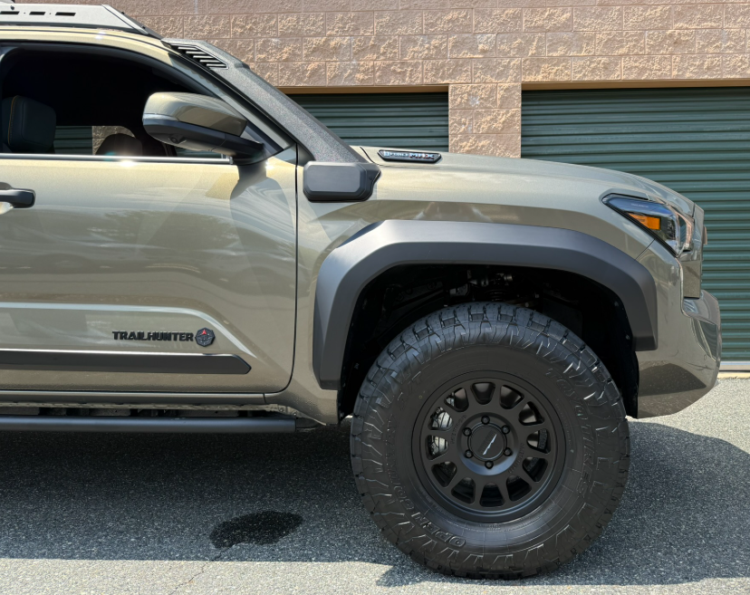

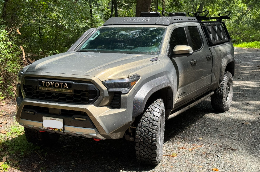

So here is what I ended up going with:
Method 703 black 17" +35 offset
Toyo Open Country A/T III 35x12.5 C load ~35psi (still playing around with psi)
Dobinson 820 front springs
Dobinson 819 rear springs
Tire poke is the same as stock, come right to the edge of the TH fenders. Slight rake when there is no weight in the bed other than my Leitner rack and gear pods by design so there is no sag once I load it up. I might end up doing a 1" spacer up front If i find that it doesn't sag too much with what I take camping and fishing, still testing all that out and seeing what I end up loading up with. Did remove the crash bracket, pretty sure it would have rubbed with any flex. Other than that no trimming at all.
Rides amazing. Not too harsh, takes bumps well, takes smaller obstacles and ditches very well. Feels way more stable and planted on sharper turns. Went over several ~7" drops offs and everything felt great. I haven't had a chance to really put it all to the test yet, just went on the closest trail to me that was pretty easy as an initial test. Anything harder is like 3-4hrs away minimum and haven't had the chance yet.
Even at 60lbs per tire, I can notice a tiny bit of acceleration loss but it's nothing major at all. I was averaging 16.3mpg according to the truck (i'm not on the highway a lot) and after the wheels and tires I reset it. Now averaging 15.1 which I think is actually really good considering each wheel is 27lbs for a total wheel and tire weight of 87lbs.
Snapped some pics while unloading my fishing gear, that kayak only weighs about 50lbs (Hobie Lynx) and the rest of the bed is empty so that's not affecting the rear height at all in the pics.

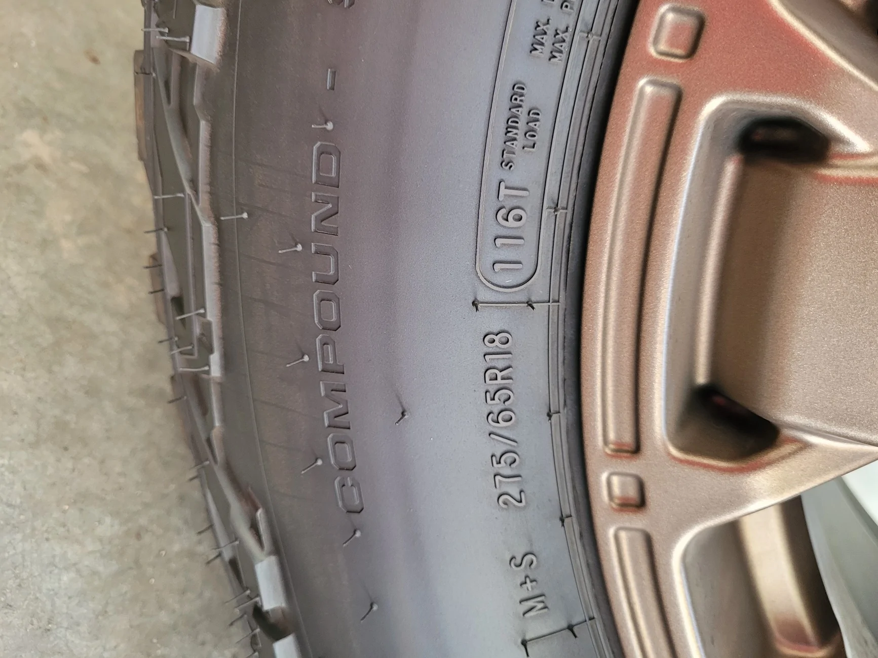

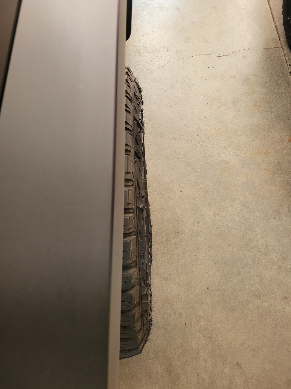

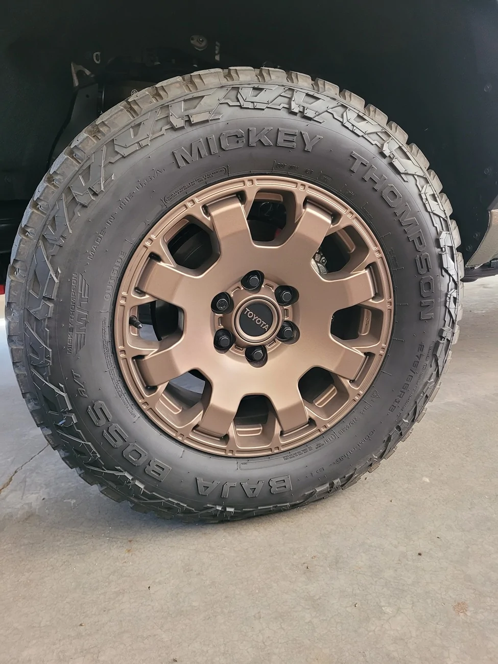

Brand new to the forum here. I'm a big fan of checking into what everybody envisions for their rig to give it that "personal" touch/look. Having said that, I cannot, for the life of me, understand why anybody would want to modify their trailhunter suspension (if they happen to have that particular model). In my opinion, the OME setup is hands down, the best OEM suspension that I have ever had on a truck. I understand wanting to go larger tire size whether it be solely for looks, or off-road prowess, or even to increase load rating for overlanding purposes. 99% of the time I throw on a larger tire size than OEM immediately after I buy a new truck. Most of the time, that means sacrificing ride quality because the larger tire is almost always a 10-ply, E-load rated with stiff as hell sidewalls. However, since the ride quality of the TH is so exquisite, I didn't want to do anything to detract from that (such as going with an E-Load rate tire).
The stock Wrangler Territory RTs just were not going to work for what I want/need to do with the truck. My compromise is I went with the Mickey Thomson Baja Boss ATs, sized 275/65R18, SL Rated. Yes, they are "smaller" than the stock RTs, but only by .2", which is hardly noticeable to the naked eye, plus they are a bit wider than the stock RTs. The Mickeys ride just as good as the RTs, if not better. At 46 pounds, they are only 6 pounds heavier than the RTs. AMAZINGLY, my truck feels faster upon acceleration and I GAINED 1 mpg with the Mickeys!! I honestly cannot explain that phenomenon other than perhaps there is less surface contact with the road due to the more aggressive tread. The absolute only negative is that they are a bit louder than the RTs. It is a tradeoff I'm willing to accept since the Mickeys are tremendously more aggressive and have the 3PMSF which is an absolute must have where I live.
Anyways, I am happy to be here and look forward to gleaning as much information as I can from all of you experts.
