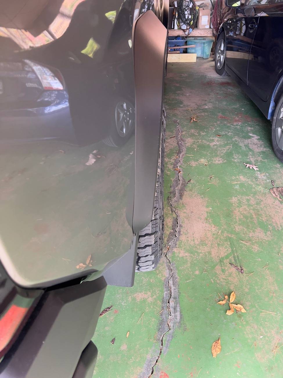

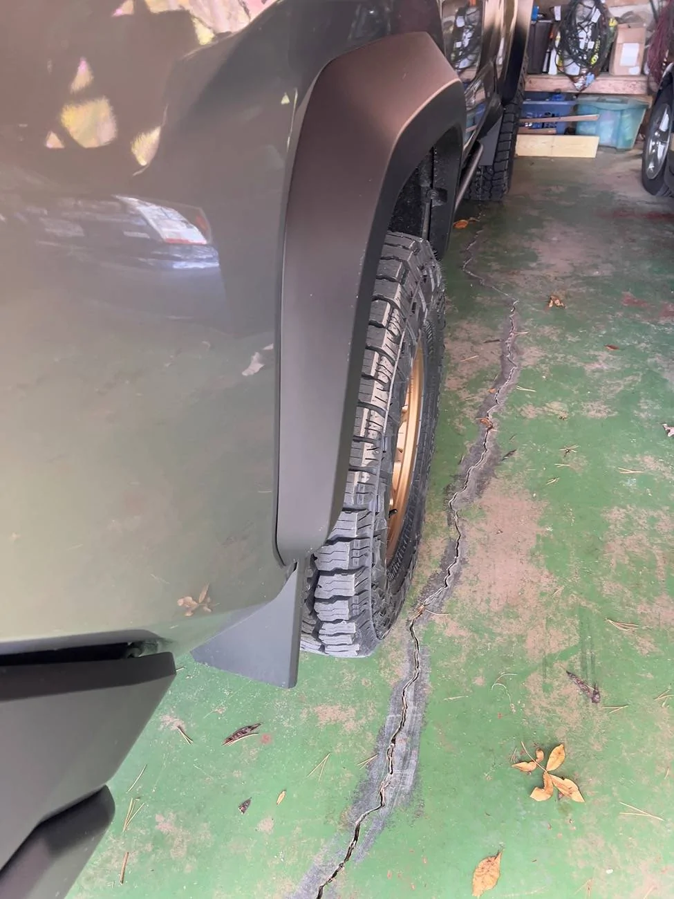

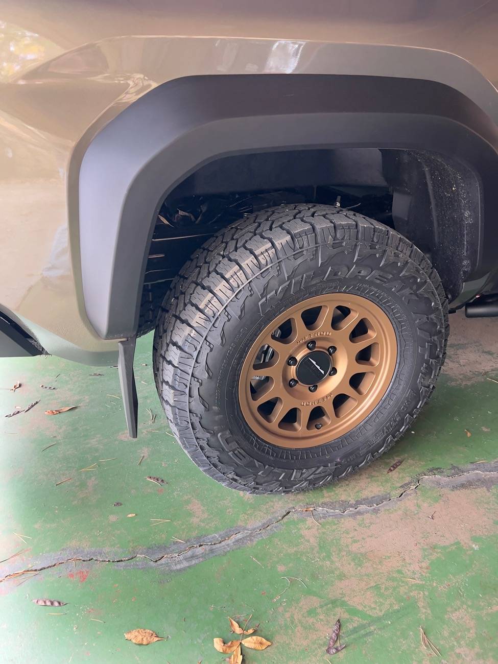

Method 703 with Falken Wildpeak AT4/W 285/70/r17 running on my TH.. Only have a couple of hundred miles on them so far, so not even broken in. OEM taken off at 495 miles and trying to sell them now.. Works well, havent had any rubbing and seems to fit about the same as originals.

Oh this is super helpful. I may be buying a second set of wheels for when I’m in the city - so I can get some standard load tires in this size (the same Falkens) - so method 703 with +35 offset here? Do they offer +30? I may want an itty bit of poke.

I've recently installed the +35mm offset and there is no poke. Maybe a little less than stock actually. No rubbing or cutting required.
I think the 703s come in -22, 0, +35.

Gotcha. I would prefer something like +25 or +30 unless I got super wide tires like a 35x12.5

I have a 2025 Trailhunter and I am sick of the OEM tires. I have about 13,000 miles on my truck and have hated the tires. Mulitple leaks, suck in the rain, also like most people the TH alignment is weird. But I really like the look of the Method 703's with the 285/70/r17 tire combo. I dont want to trim or do anything. What exact 703's are those? The 17x8.5 | 6x5.5 | 35x6.2?

In that size there’s no trimming involved. It’s an easy tire to fit.
