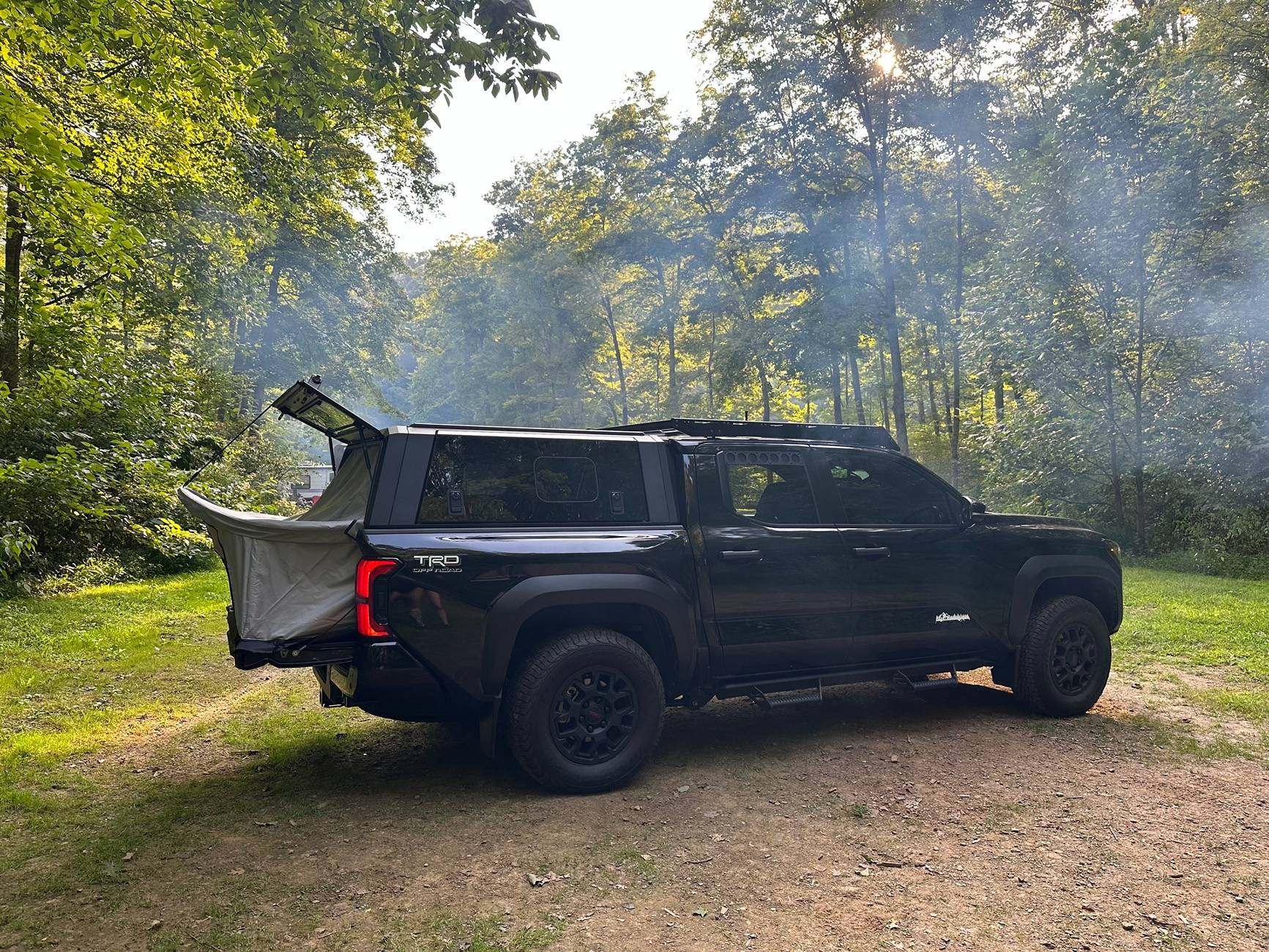

How did you address the height difference between the decked system and the tailgate? Like how did you make it all one height so that you have more room to sleep? That's my number one issue right now. Also, how was the head space while sleeping, did you feel claustrophobic at all? Sweet setup!
I will address the height difference between the decked and tailgate by putting two half-sized Sidio crates at the end to support my feet and two more for my wife. The height of two half-sized crates is approximately equal to the decked.
Headspace was not bad. I'm 5'9", and my wife is 5'6"; we both can't sit up perfectly straight, but there's plenty of room to maneuver under the cap without banging your head. We slept with the windows closed, had a USB fan to circulate air, and did not feel claustrophobic at all. My wife said she really liked sleeping in the bed, and if I have her approval, I know it's a winner.
I just bought a double sleeping pad from REI during their sale, so I'll take some pictures of the fitment when it arrives.

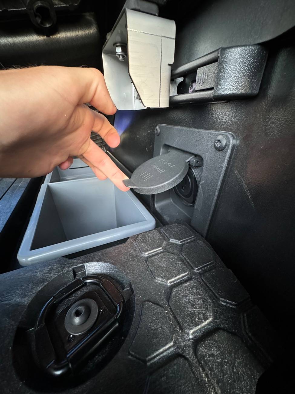

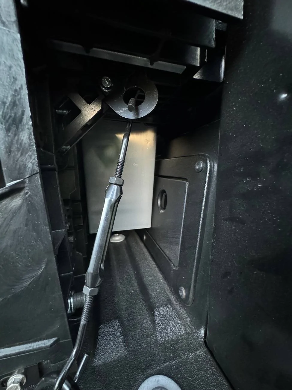

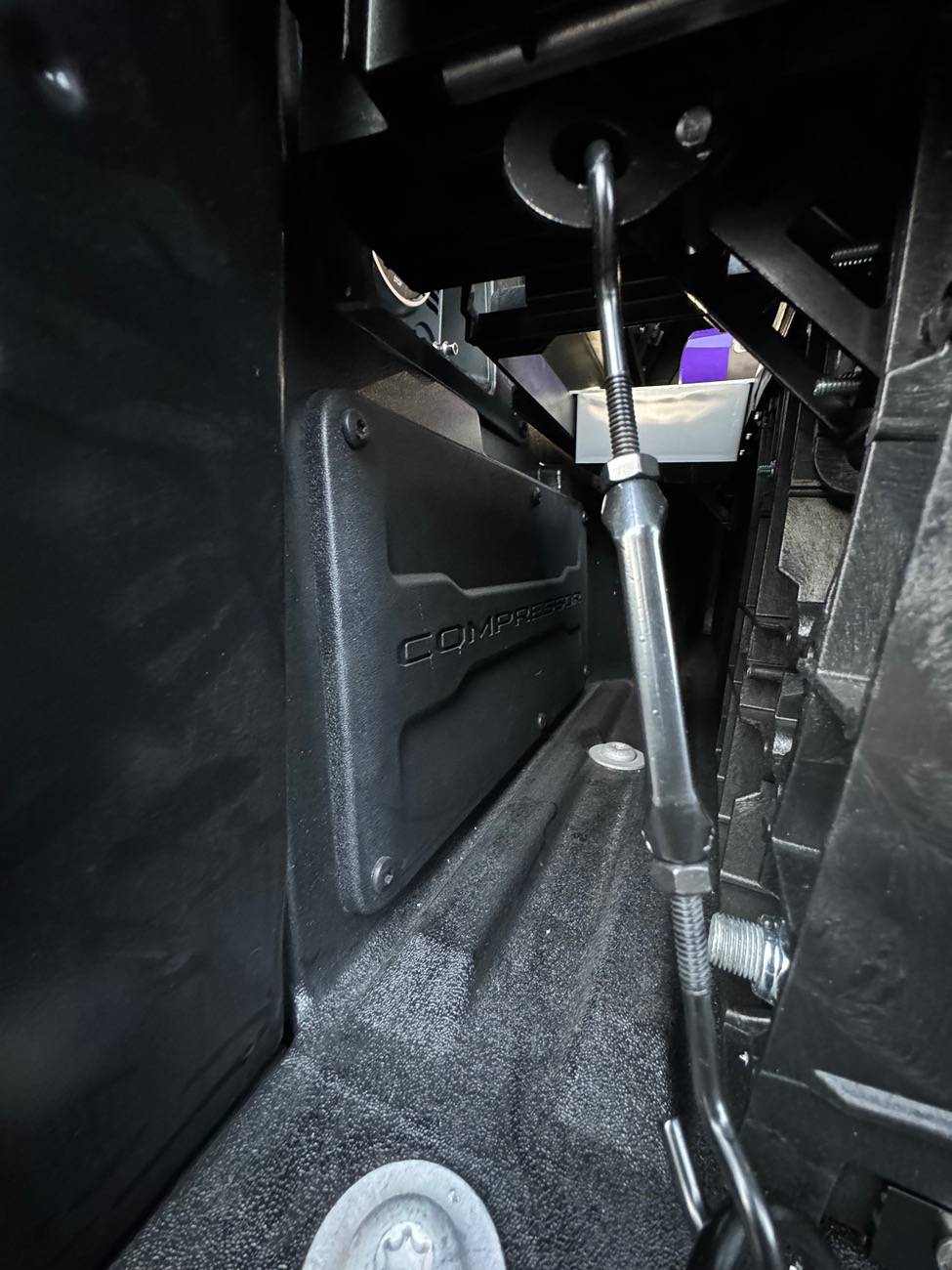

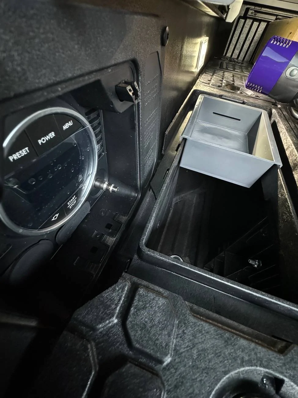

The access for the air compressor looks very tight. Did you order the Decked YT9? I’m concerned as I’m hoping to have my TH in about 6 weeks and the Decked was going to be one of the first thing I was going to add. Can you post a few closeups of the power and compressor side access as well as the open space between the drawer and the tailgate. Beautiful build by the way.
Here’s a couple photos, hope this helps. The power is blocked unless you take the bin cover off.

Interesting!!! Great pics. Thank you. Too bad Decked didn’t come up with a better solution for both sides but it does seem workable.

Nice setup! I did the same with my TRD ORP (decked, Smart Cap, and Topper EZLift Nomad Package)) I actually went out camping last weekend with my wife and we loved the setup. Got some tweaks to make but I'm definitely looking forward to camping out of my truck.
What is that in your rear window? Does the canopy align properly if you want to add a full roof rack or is the canopy taller?
