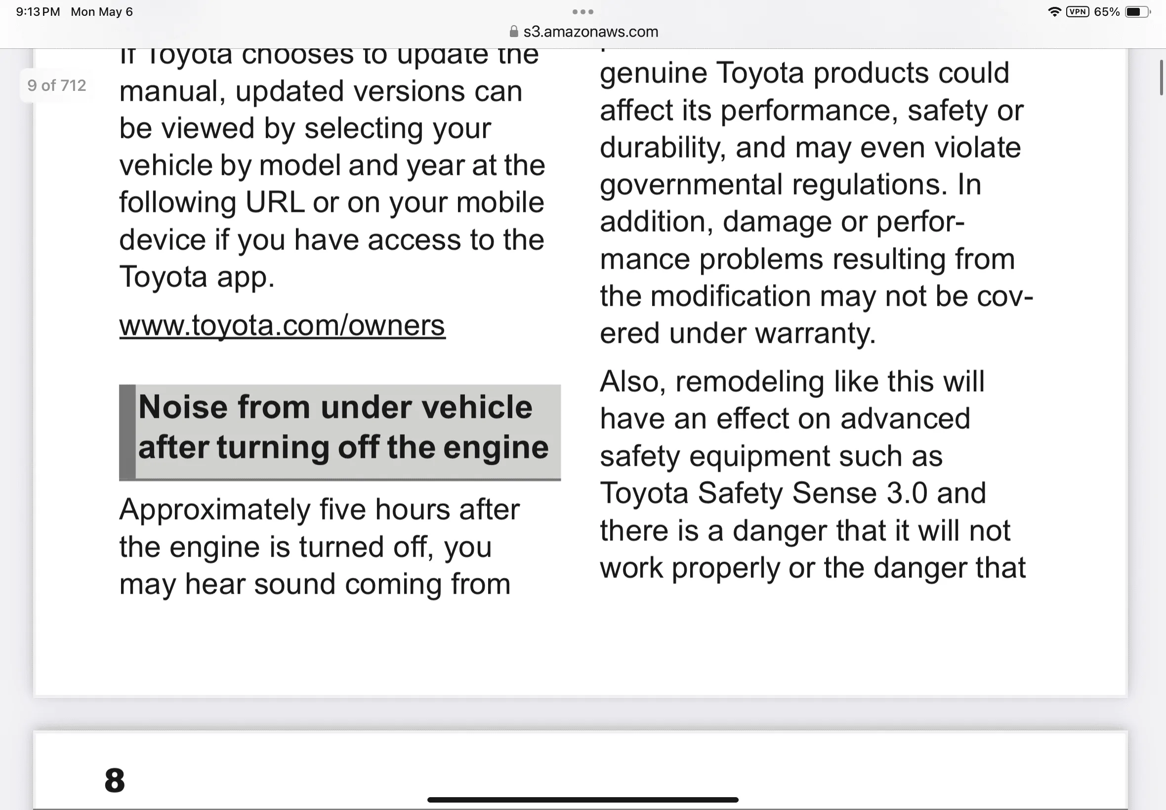

It’s the EVAP test being done - page 7 of the owners manual. - noted very early in the manual.
