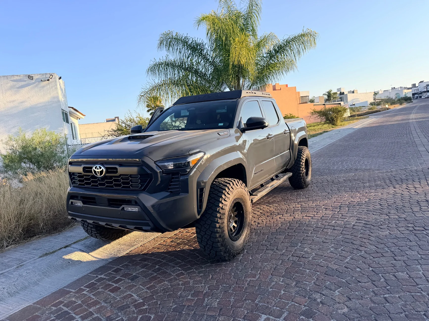

Hi guys… I have a problem with my Tacoma TRD Sport HEV. I installed a TRD Pro intake with the original MAF sensor from my truck, and I also installed a TRD Pro exhaust. The problem is that the RPMs after accelerating stay at 2000 RPM. I've also noticed that the electric motor doesn't engage as frequently as it used to; in fact, it doesn't charge the battery more than 30%.
Has this happened to anyone else? Do you know if I need to reprogram the ECU with these changes?
Example image I took from someone here on the forum

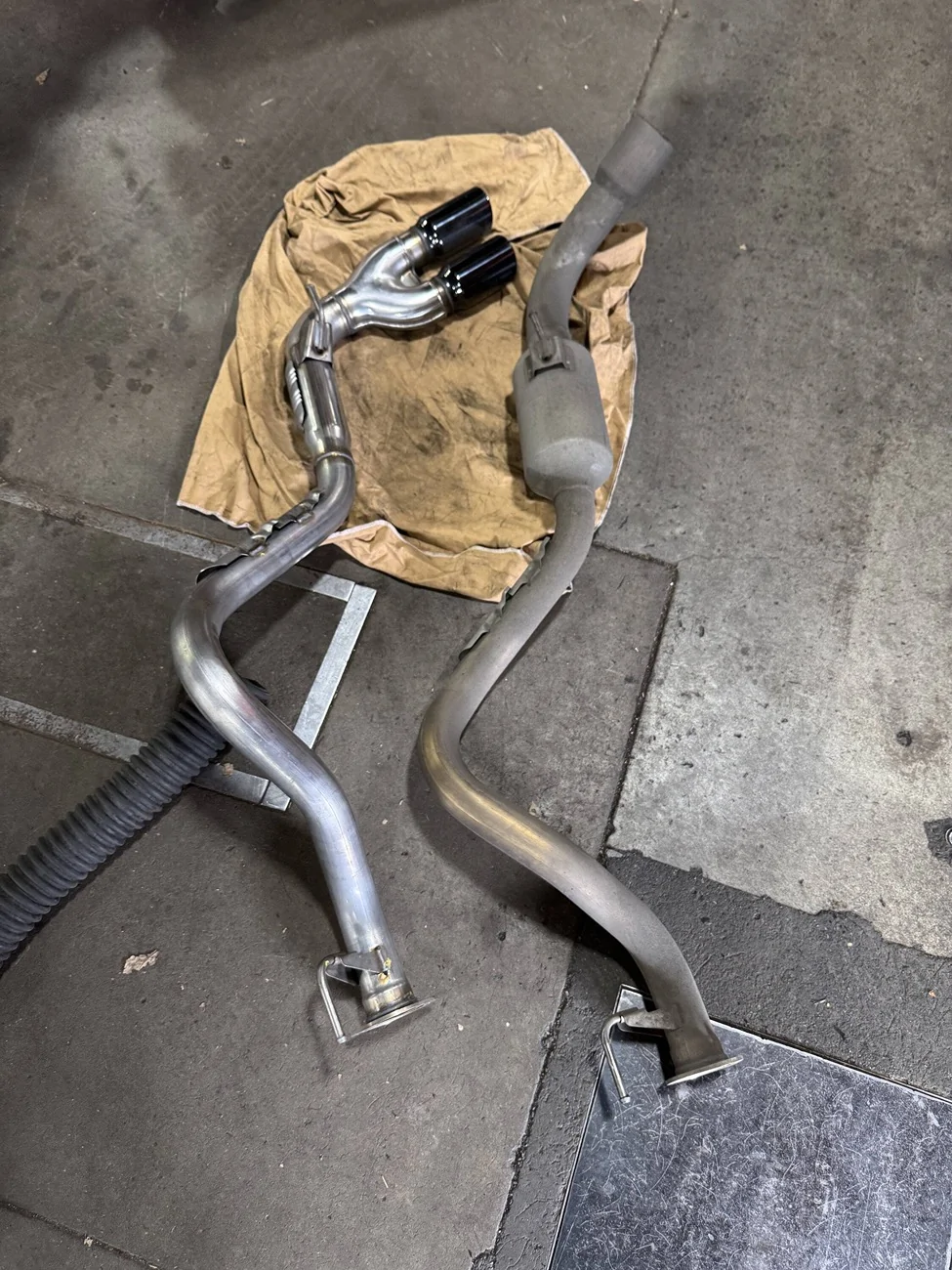

The TRD airbox requires a retune. Exhaust is fine. Remove the airbox.
BTW, that’s only the exhaust tip portion of the TRD exhaust. There is a center part.
