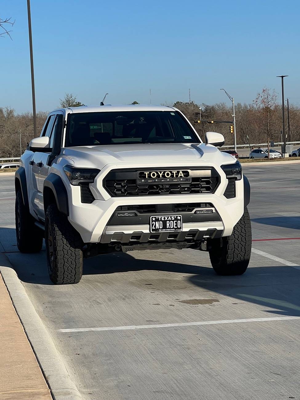

Yeah so I got 275/70/18 Falken AT4Ws in E load. They weigh 60.3 pounds. They also “run big” in that they are without any question wider than any other 275/70/18 I’ve ever seen and I’ve looked at a LOT of them in person. They also sit 33.43” tall which is taller than 90% of tires in this size (most run 33.2”). For the Trailhunter, the actual size of this tire is a match made in heaven. They go right to the edge of what can fit and they look super nice. They are very aggressive and look somewhere between a 285 tire in 34” and a typical 33”.
But. The downside. In my humble opinion, E load sucks ass for ride quality. I cannot get my truck dialed in — tried every psi. I temporarily swapped tires once to another E load to see if it was the tires and - same shit. I feel the tiniest bump and my cabin is always shaking from larger bumps and it sucks. I am probably going to get fed up with it and change tires. I wish they made the same identical tire in a C load and I’d call it a day. The General Grabber in SL and the G3 look kind of anemic but I may end up there. I also may get a 17” wheel and get a 32.8” tire (285/70/17) but I think that’s kind of small.
Most people though seem to love their E loads and have zero issues. This could just be me.
For gas mileage I was shocked it only went down 1-2 mpg. Zero speedo impact. Handling did take a hit - less nimble for sure.
Our wheels (TH/PRO - weigh 33-34 pounds; stock tire is 40 pounds; lightest E load is Firestone destination XT and its 50 pounds which I tried and didn’t like)
My next move may be relations race wheels at 20 pounds + Mickey Thomson 285/70/17 in SL at 48 pounds - but I’d prefer C load and a taller tire.. but may be no other option

@tacorancher thanks for such a detailed response! Shoot I thought the mpg would be worse. Interesting. Good to know about the ride quality though. I’ve been a bit concerned about it. I hope you figure out a way to dial in your ride to be comfy for you soon
I didn’t realize our wheels were that heavy too. Dang. I think even a method 705 is something in the mid/upper 20s? Hm. Eventually I’ll step down to 17’s and run 33x10 from there at least that’s the plan.
The toyo at 3 at 275 70 18 (e load) claims to be 50lbs which isn’t too bad considering? The Terra grappler g3 is 46lbs at 116T. That’s what I’m debating between now that I’ve thought about it a bit more ~ the falkens seem awesome but they’re so heavy! Same with the KO3. The G3 is winning for me rn even though it’s not the beefiest boy of the bunch lol just on pragmatism alone.

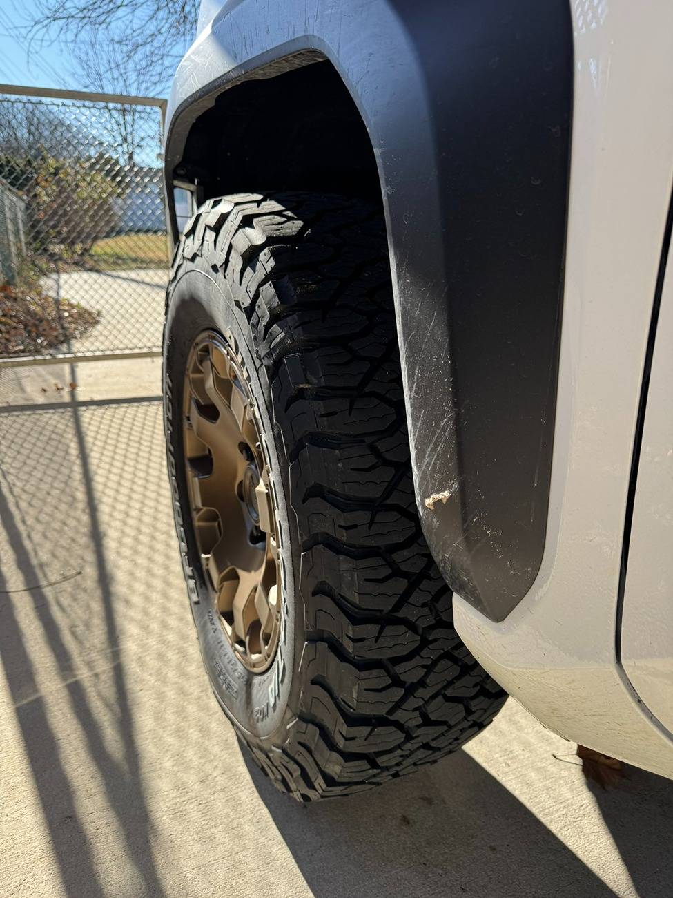

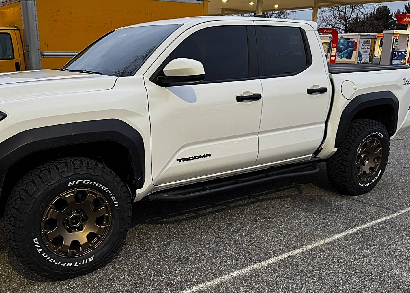

@JustAnotherDingus I can provide some insight, although I'm in just a lowly TRD OR model, so the feel may be a bit different on my truck vs a Trailhunter. I have the KO3s in 275/70R18, and so far, the ride is as smooth as it was with the factory 17" wheels and smaller tires. A friend of mine has them on his factory 17" wheels and says his ride feels better than stock. As @tacorancher pointed out here already, they're 33.2" diameter, and if they fit on my truck, they will fit on a Trailhunter with ease. Also, since you have the iForce hybrid, the performance hit should feel fairly minimal as well. You will take a hit on mpg, for sure, but again, not terribly. I've only got about 2.5 tanks worth of driving on these tires, and so far, it looks like I'm down about 20-30 miles in range at worst. Once I have some more miles with them, I'll be able to make a much more accurate accounting of the difference in mpgs. It doesn't appear to be a "bank breaking" difference though, and it's likely not as big of a hit with the hybrid as it is on mine too.
I may have gotten a little lucky with balancing, but mine feel great with little to no vibration at any speed. I've heard/read various thoughts on the Falkens, and I was absolutely stuck choosing between the AT4Ws and the KO3s, but I ended up with the KO3s based on looks alone. The BFGs with the white lettering... they just look super slick to me, but that's definitely subjective. I've seen people have difficulties with balancing on both tires, and no clear winner in terms of ride quality either. In my experience so far, I'd give these a big thumbs up.

@Kdbradley85 im glad they’re working out for you! I think the ko3s look really nice with the white sidewall too.
I wonder if the difference between your and @tacorancher ’s experience with the E load is something to do with the trailhunters weight and suspension geometry vs the OR. Hmm.

A bunch of people like the KO3 as mentioned above - maybe softer rubber compound as the AT4 HDs are targeted at super duty trucks? I know other TH owners who also like the KO3. Not sure what’s going on. I could try those. But it’s a huge gamble for me at this point. Honestly my truck experience has been ruined with these tires. I am in the minority as nobody else is reporting a bad experience with the Falkens or the KO3s in E load.
I will lastly note that the TH sprints are stiff.

Truck looks great…i like how you have the tires and wheels, i plan to hold out on new tires when truck comes in, at least get some use out of tires that truck comes with , then ill replace right before winter arrives, it always seems the stock tires get crappy in the 10,000 mile range, or im eager to just put better looking tires on , lol
