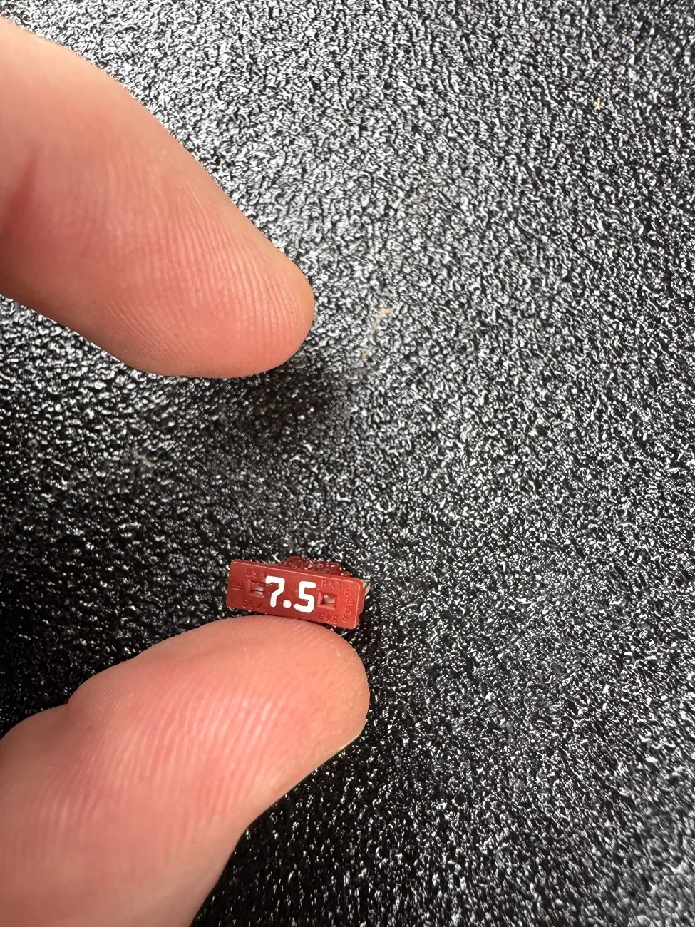

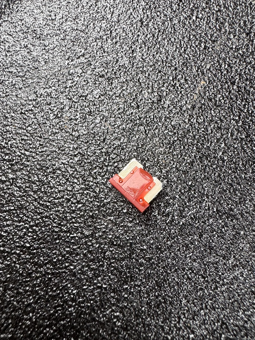

You were absolutely right. The fuse looked intact but once I tested it with my meter I found it was bad. I tried both a regular 7.5a and mini fuse and both worked. The little rubber cover doesn't work with either of those though. The fuse I removed looked different than ay other fuse I've seen. See pic. I'm used to the fuses having longer 'legs' and the ones I tried seem to be fine and all works ok now. Thanks for the help!

I had to walk into autozone and look at all the options to find it. But if you look up what fuses Toyota uses you can then just order some online. I forget what they are called but it’s easily found. Glad it worked out and it saved a bigger headache
