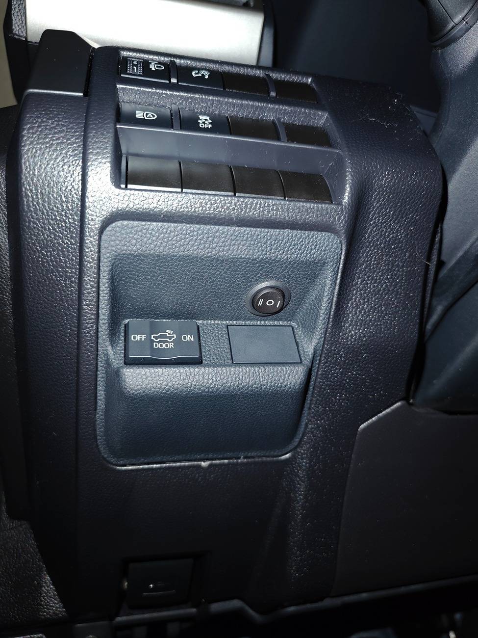

I like my Diode kit but they could have at least sent an aux button cut out for the rocker, can't put a circle in a square guys.. lol either way my setup works for me ?
