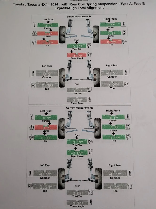

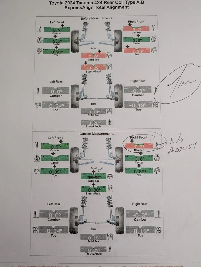

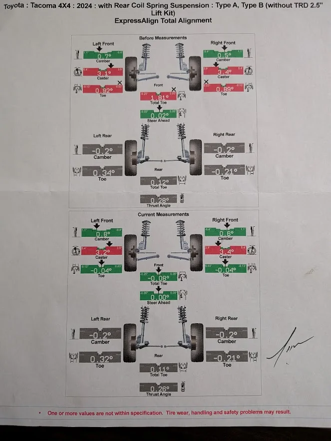

The alignment on these trucks does not appear to hold. I had the first check at 9mo in (it took until Jan '25 for non-dealerships to receive the Gen4 alignment spec publications). At 9mo it was out. Then checked again 6 months further on and it was out again. Just checked it again 7 months after that one and it was way out with significant outside edge wear on the front two tires. The truck sees 98% paved roadways, and 2% gravel/dirt/field. Everything is OEM.
All three of these are from the same shop (title changes are the revisions of the alignment being pushed to them)
