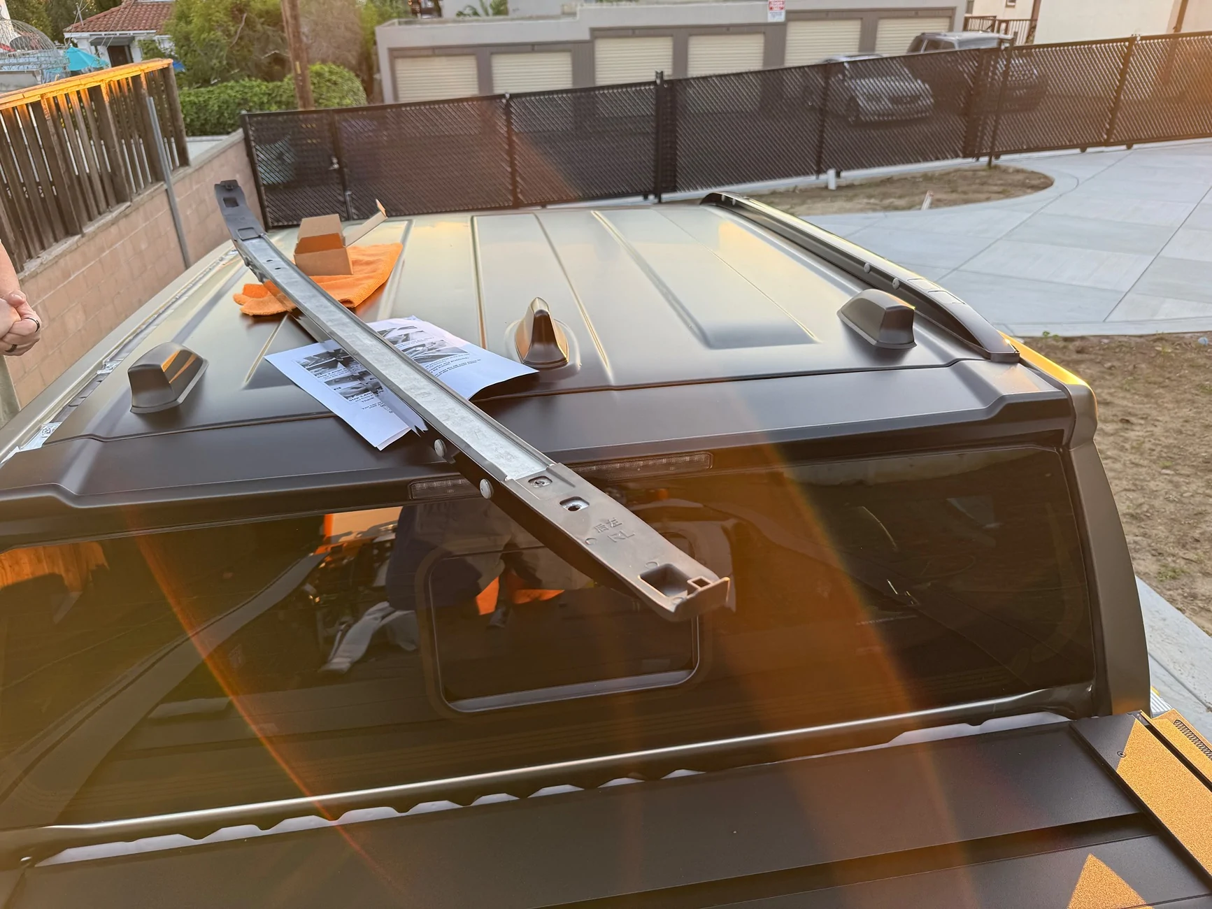

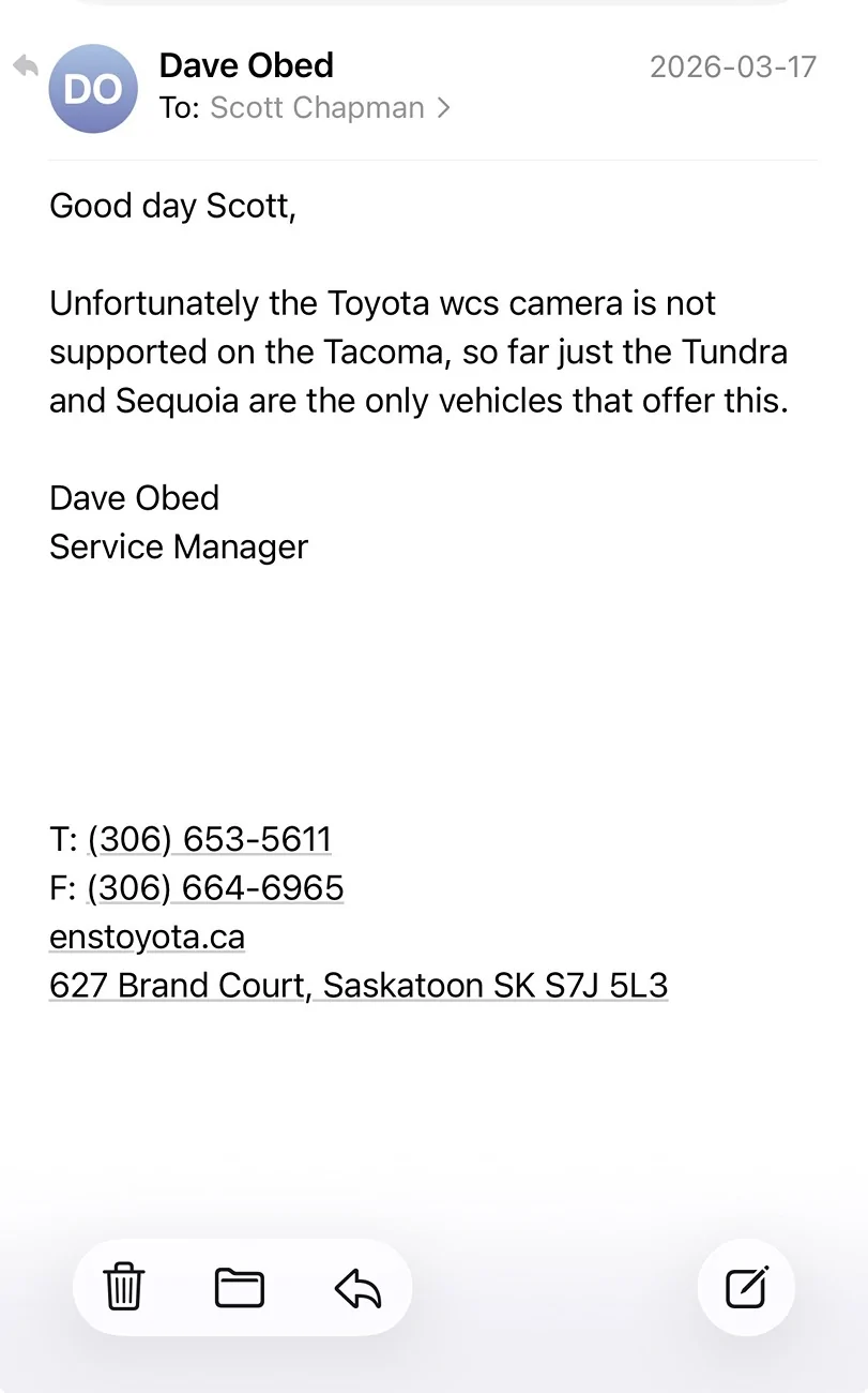

Hi Lauren, can you confirm you have a regular Trailhunter and no additional shark fins on your roof? I’d love to have a play by play of how you did it before I invest in the camera system. My dealership told me it wouldn’t work. And Toyota Canada told me to pound sand
2024 Tacoma WCS (Wireless Camera System) for 4G Tacoma IMG_9628
2024 Tacoma WCS (Wireless Camera System) for 4G Tacoma IMG_9627
I DO have the two WCS shark fins. The vehicles with WCS have a special roof and wiring as well as software. There is no retrofit. You have to buy a vehicle that has it already. Some of the Limited, Trailhunter, and TRD Pro are equipped with WCS. There aren’t that many, but I have seen a few in the wild besides mine.
Should be able to see three fins in some or all of these pictures.
I’m in California. I wonder if Canada models do not currently offer the OEM WCS on the Tacomas.

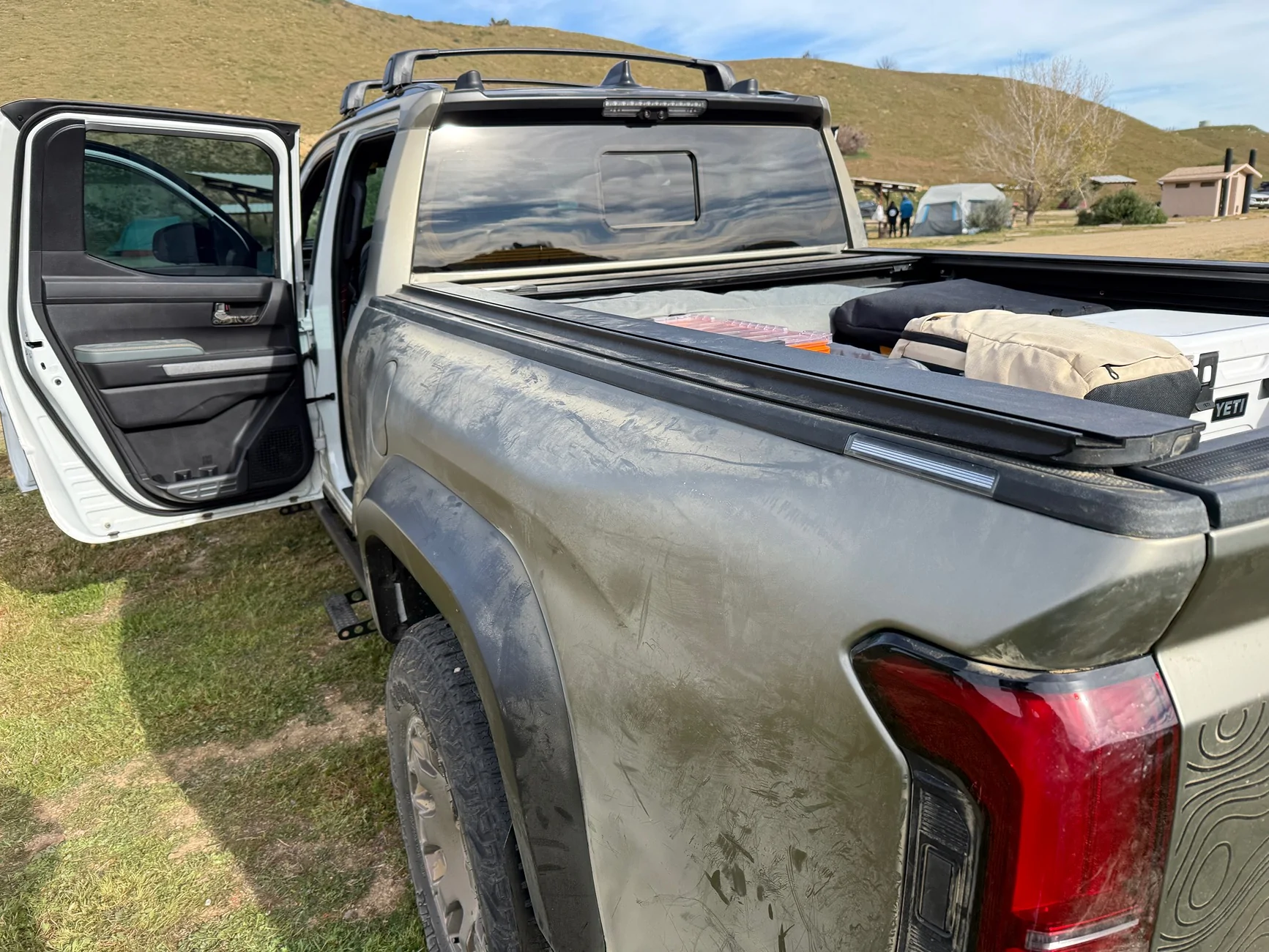

With our Subaru, we had an aftermarket $150 trailer camera, but it was crappy. I would recommend getting something recommended by an RV outfitter. Although it wouldn’t be integrated with your Tacoma mirror or infotainment display, you could probably run it on an iPad or monitor provided with the system.
2024 Tacoma WCS (Wireless Camera System) for 4G Tacoma IMG_0310
2024 Tacoma WCS (Wireless Camera System) for 4G Tacoma IMG_1784
2024 Tacoma WCS (Wireless Camera System) for 4G Tacoma IMG_2615

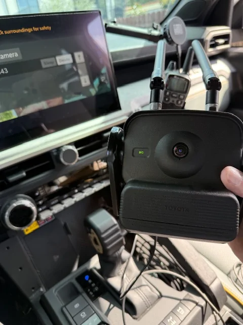

These are the changes that we made to get the camera to wake up, pair, and show on the monitors. Before you pair the camera, you need it to charge. It will not charge with the 12 V plug using the power station in my house. The dealer confirmed by talking to Toyota that does not work. Instead, use a USB-A to USB-C charger.
Important: get a USB-C charger that plugs into the camera with a an extended 10 mm tip. I had a seat to see that was fairly new with 10 mm tips on both sides. That would not work in the car or on my power station in the house. When I use the USB to see with extended 10 mm tip, the sucker started powering up right away. You can tell by the light coming on.
I recommend taking a screenshot of the light codes so you will not have to flip around in the guide to get to it. It might help to have a second person interpreting what those light codes mean while you are fiddling around with the camera.
1. Use the pdf guide linked below. The dealer service supervisor said that this one (which I texted to them) is the same one that they have available from Toyota Corporate. They confirmed that the Quickstart guide is incorrect.
For example, the Quickstart guide instructs us to have the vehicle in a gear other than park to pair, but this Guide says to put it in park. I confirmed that I cannot get to screen number one unless the car is in park. It seems that there’s been some reprogramming since the Quickstart guide became outdated. I worked on this at the dealership so I am confident this is the way to go.
https://assets.sia.toyota.com/publications/en/omnav-s/OMCamera/pdf/OMCamera.pdf
2. Bring your camera with you into the truck with your key. Turn on the truck (engine running); it’s OK if it auto stops. You are still turned on just as if you were going to drive.

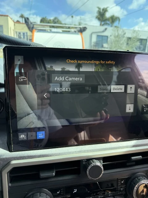

Follow the above guide to get to the pairing screen on your 14” display. The physical button you need to press to get to the right screen on the 14” display is on your center console.
Even though the guide does not show the antennas on the unit while you were in the truck pairing, I could not get it to pair until I put the antennas on.
I put the antennas on and positioned them parallel to the ground — it was close enough at a 45° angle; trying to get it at 90° made the intense flop around and I was afraid to break them off. Make sure you do the camera up/down motions **before** pointing the camera at the QR code. Meaning hold the camera lens toward the ceiling/roof, then rotate down towards the center console (with force). It did not take several minutes of holding the camera in front of the QR code to get the pairing to succeed.
Side note, I think force is required because there is an accelerometer in the camera just like with an iPhone. Sometimes when an iPhone screen won’t tilt back the way you want you have to use more force. This is the same thing I experienced with the camera.
The motions that worked for me are as follows.
Point camera up to ceiling/roof for five seconds, then **quickly with force** point lens side down for five seconds, right side for five seconds, left side for five seconds.
Then hold the camera close to the QR code (the guide says 3 to 4 inches although that doesn’t make intuitive sense to me) then I had to back off to about where the center console is. Then after holding it there for a brief time, maybe 10 seconds the camera paired.
I will post some pictures on the next comment…
