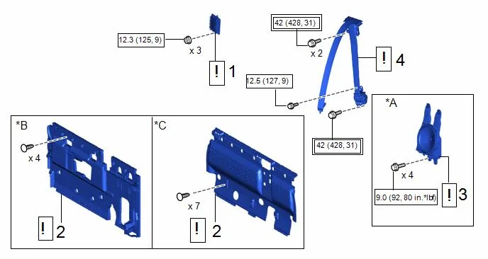

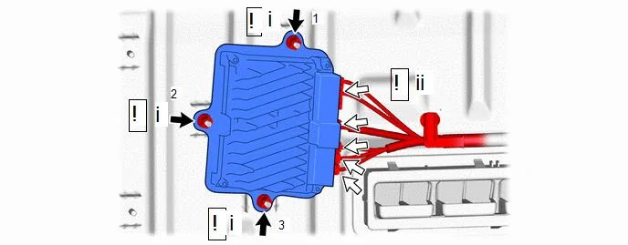

1. INSTALL COMMUNICATION TELEMATICS BOX
Nut​
Connector​
(1) Install the communication telematics box with the 3 nuts in the order shown in the illustration.
Torque:
12.3 N·m {125 kgf·cm, 9 ft·lbf}
(2) Connect the connector.
2. INSTALL NO. 1 BACK PANEL SILENCER
Click here ​
3. INSTALL NO. 3 SPEAKER WITH BOX ASSEMBLY (for 10 Speakers)
Click here ​
4. INSTALL REAR CENTER OUTER SEAT BELT ASSEMBLY
Click here ​

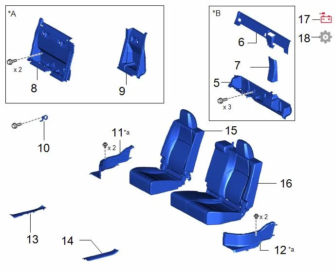

5. INSTALL SEAT FLOOR BOX (w/o LUGGAGE COMPARTMENT BOX)
6. INSTALL UPPER LUGGAGE COMPARTMENT GARNISH (w/o LUGGAGE COMPARTMENT BOX)
7. INSTALL REAR LUGGAGE COMPARTMENT TRIM COVER SUB-ASSEMBLY (w/o LUGGAGE COMPARTMENT BOX)
8. INSTALL LUGGAGE COMPARTMENT BOX RH (w/ LUGGAGE COMPARTMENT BOX)
9. INSTALL LUGGAGE COMPARTMENT BOX LH (w/ LUGGAGE COMPARTMENT BOX)
10. INSTALL PACKAGE TRAY TRIM STRAP
11. INSTALL REAR UNDER SIDE COVER RH
12. INSTALL REAR UNDER SIDE COVER LH
13. INSTALL REAR DOOR SCUFF PLATE RH
14. INSTALL REAR DOOR SCUFF PLATE LH
15. INSTALL REAR SEAT ASSEMBLY RH
Click here
16. INSTALL REAR SEAT ASSEMBLY LH
Click here
17. CONNECT CABLE TO NEGATIVE AUXILIARY BATTERY TERMINAL
  • for Gasoline Model:
    Click here
  • except Gasoline Model:
    Click here
18. REGISTRATION

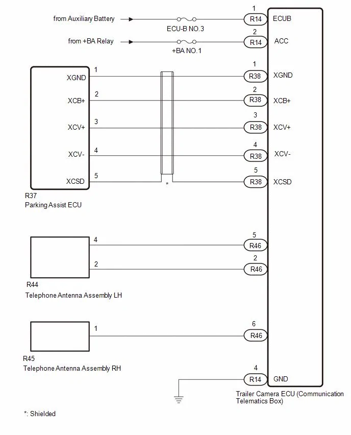

DESCRIPTION
The display signal from the wireless camera is transmitted to the display.
WIRING DIAGRAM

CHECK HARNESS AND CONNECTOR (TRAILER CAMERA ECU - BATTERY AND BODY GROUND)
(a) Disconnect the R14 trailer camera ECU connector.
(b) Measure the resistance according to the value(s) in the table below.
Standard Resistance:
Click Location & Routing(R14)
Click Connector(R14)
Tester Connection​
Condition​
Specified Condition​
R14-4 (GND) - Body ground​
Always​
Below 1 Ω​
(c) Measure the voltage according to the value(s) in the table below.
Standard Voltage:
Tester Connection​
Switch Condition​
R14-1 (ECUB) - R14-4 (GND)​
Ignition switch off​
11 to 14 V​
R14-2 (ACC) - R14-4 (GND)​
Ignition switch ACC​
11 to 14 V​
Below 1 V​
NG
REPAIR OR REPLACE HARNESS OR CONNECTOR
OK​
5.​
CHECK HARNESS AND CONNECTOR (TRAILER CAMERA ECU - PARKING ASSIST ECU)
(a) Disconnect the R37 parking assist ECU connector.
(b) Disconnect the R38 trailer camera ECU connector.
(c) Measure the resistance according to the value(s) in the table below.
Click Location & Routing(R37,R38)
Click Connector(R37)
Click Connector(R38)
Tester Connection​
Condition​
R37-2 (XCB+) - R38-2 (XCB+)​
Always​
Below 1 Ω​
R37-3 (XCV+) - R38-3 (XCV+)​
Always​
Below 1 Ω​
R37-4 (XCV-) - R38-4 (XCV-)​
Always​
Below 1 Ω​
R37-1 (XGND) - R38-1 (XGND)​
Always​
Below 1 Ω​
R37-5 (XCSD) - R38-5 (XCSD)​
Always​
Below 1 Ω​
R37-2 (XCB+) or R38-2 (XCB+) - Body ground​
Always​
10 kΩ or higher​
R37-3 (XCV+) or R38-3 (XCV+) - Body ground​
Always​
10 kΩ or higher​
R37-4 (XCV-) or R38-4 (XCV-) - Body ground​
Always​
10 kΩ or higher​
R37-1 (XGND) or R38-1 (XGND) - Body ground​
Always​
10 kΩ or higher​
R37-5 (XCSD) or R38-5 (XCSD) - Body ground​
Always​
10 kΩ or higher​

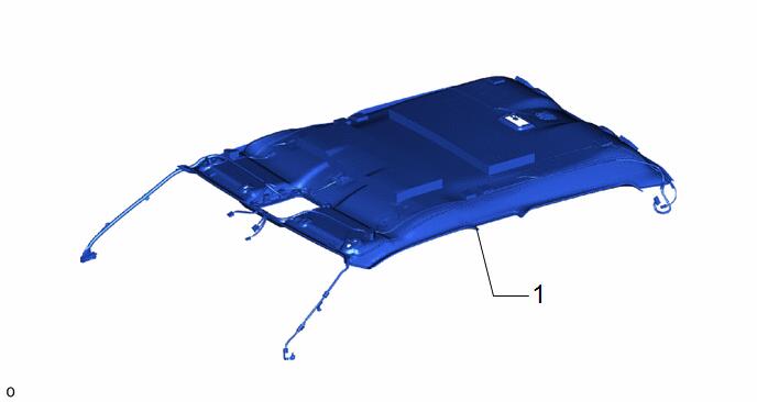

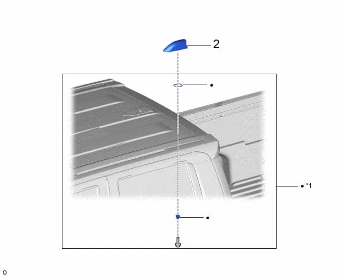

Title: MIRROR (INT): TRAILER CAMERA ANTENNA: REMOVAL; 2024 MY Tacoma Tacoma HV [12/2023 - ]​
REMOVAL
CAUTION / NOTICE / HINT
HINT:
  • Use the same procedure for the RH and LH sides.
  • The procedure listed below is for the LH side.
COMPONENTS (REMOVAL)
Procedure​
Part Name Code​
1​
ROOF HEADLINING ASSEMBLY​
Procedure​
Part Name Code​
2​
TELEPHONE ANTENNA ASSEMBLY​
86760​
*1​
ROOF ANTENNA HOUSING​
â—Ź​
Non-reusable part​
PROCEDURE
1. REMOVE ROOF HEADLINING ASSEMBLY
Click here

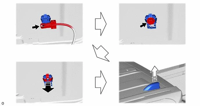

2. REMOVE TELEPHONE ANTENNA ASSEMBLY
Remove in this Direction (1)​
Remove in this Direction (2)​
2024 Tacoma WCS (Wireless Camera System) for 4G Tacoma 1740069919514-yr
2024 Tacoma WCS (Wireless Camera System) for 4G Tacoma 1740069919627-9k
2024 Tacoma WCS (Wireless Camera System) for 4G Tacoma 1740069919781-8j
2024 Tacoma WCS (Wireless Camera System) for 4G Tacoma 1740069919805-g
2024 Tacoma WCS (Wireless Camera System) for 4G Tacoma 1740069919828-3

Antennas would still be needed. Not sure about whether associated wiring harness is already in the truck as well.
Curious as to where you found the telematics box (and associated full part number)? I was having a rough time finding it.
Found a couple different ones. All about the same price. Tried to narrow down using search with specific vehicle and no luck.
Only one antenna I see? I thought it added 2? I am seeing about $300 for the antenna.
Baltimore
Jul 23, 2024
689
392
Maryland
4g hybrid
These were identified earlier in the thread:
Left Hand Telephone Assembly Antenna - PT887-0C137-LH
Right Hand Telephone Assembly Antenna - PT887-0C121-RH
