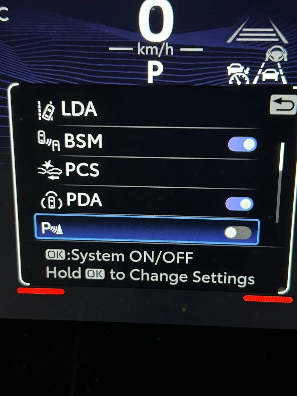

What is this “P” in the Multi-information display?

It looks simple and easy. But I have no idea.
2024 Tacoma What is this “P” in the Multi-information display? IMG_8122

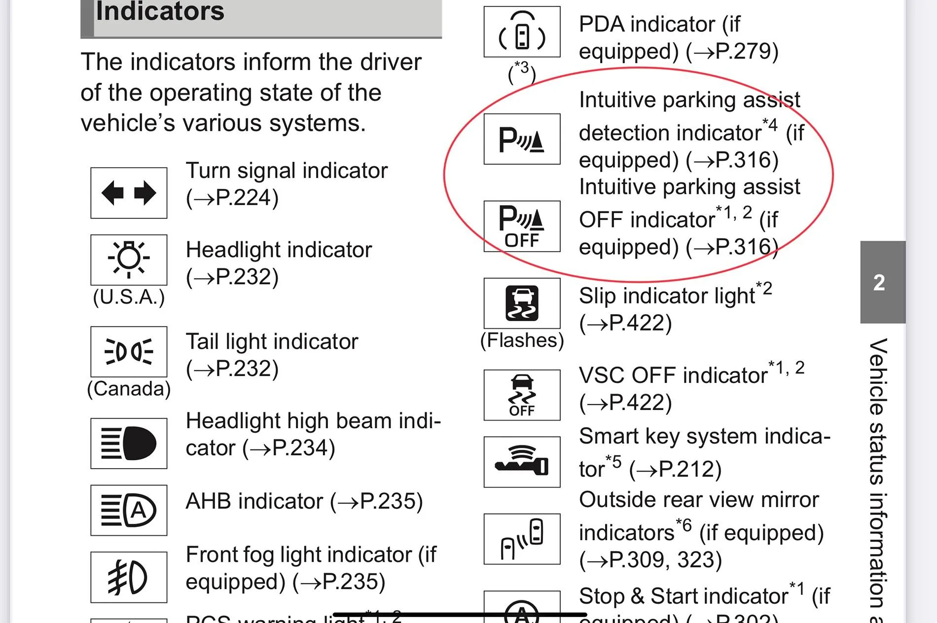

A PSA for those who might use a hitch type bike rack. It is the Parking Brake Support that you have to turn off to not have your brake slam on.
The Toyota electronics here get some credit for granular control but I sure wish they had an instant disable button like our German car has.
Which acronum is the Parking Brake Support? There are so many acronyms! lol
It might be PKSB and called Parking Support Brake. It's not exactly intuitive considering the other motion-aware settings. I believe plugging a trailer in disables it automatically.

Had to turn mine off and not I have the warning telling me it is off for all time. When I back my car into my driveway it’s a tight fit around my other family cars. But when I get to my parking area I pass by my garbage cans. I think the truck thinks it a person because it slams on the brakes aven though I have a foot of clearance.
